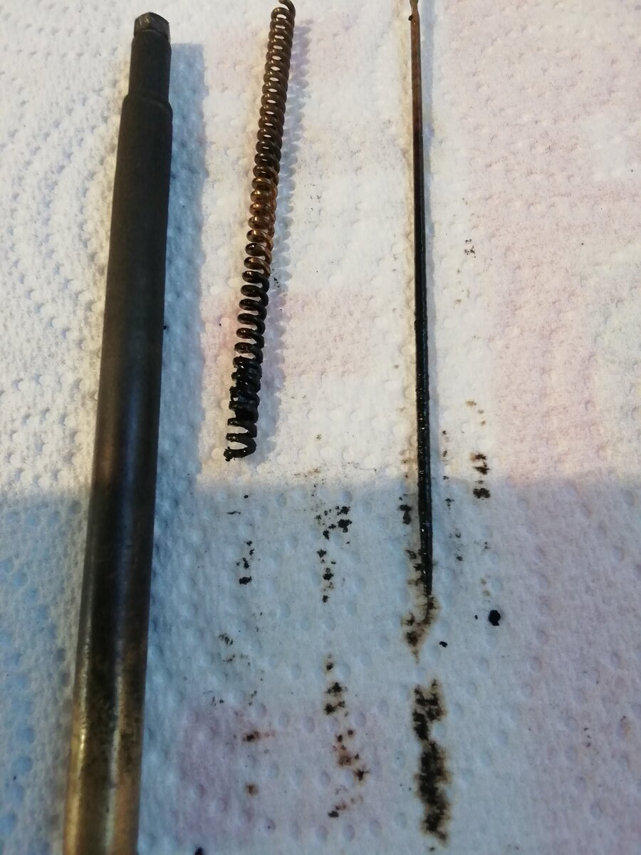

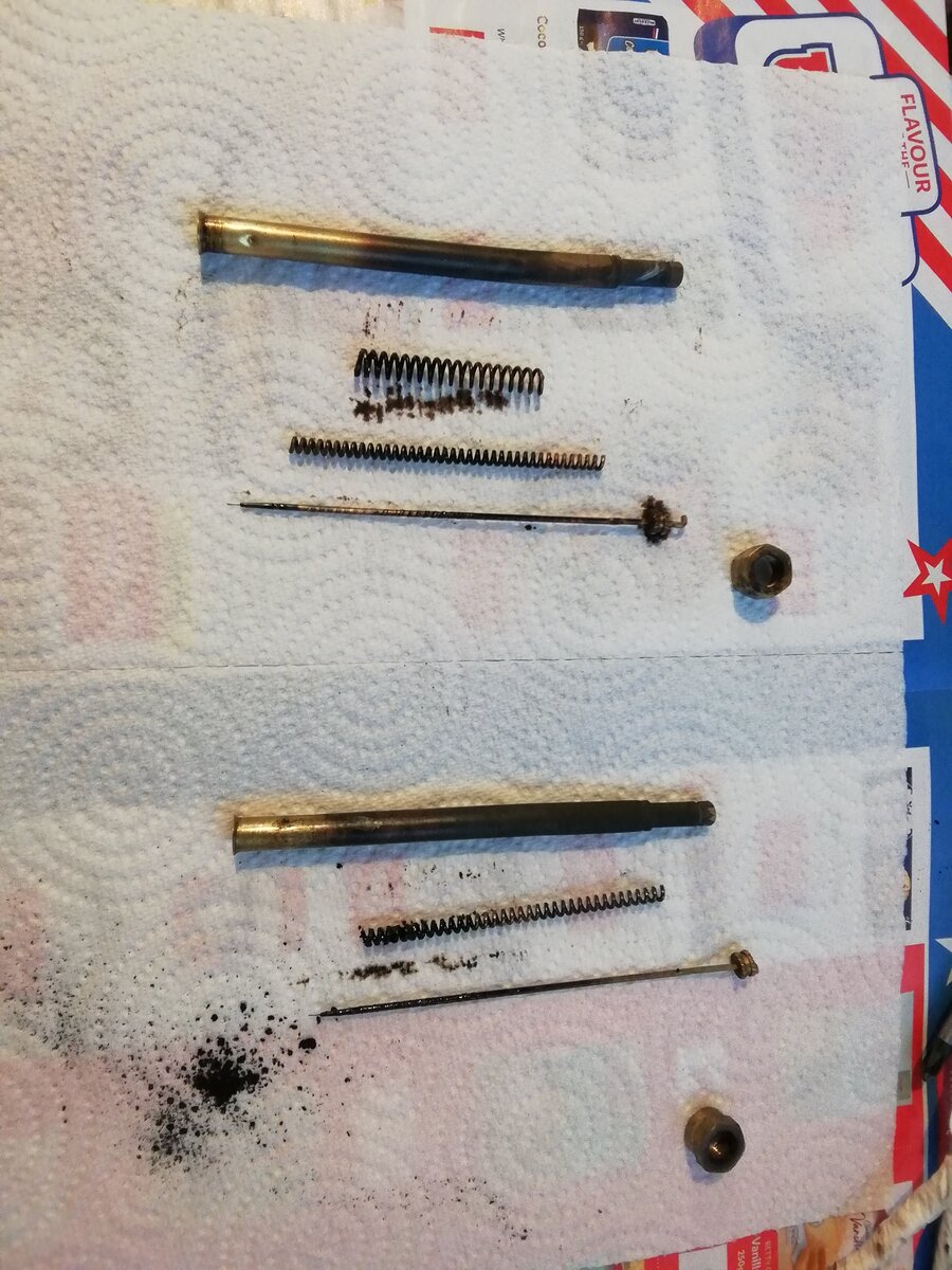

    Over the weekend I was tinkering with making some ethanol free fuel to see if actually works.
    I used two lanterns of fairly similar sizes, one was a Coleman 290a powerhouse ,this was run with rug.
    the other was a 295 powerhouse and this was run with the homebrew,this is what I have found after two tanks full each.
    I wasn't too concerned with power out put/ performance or how long each full tank lasted,it was to see how badly the additives in rug gums up the workings in the generators.
    Both generators were cleaned in acetone and the springs were soaked and scrubbed before I put them back together and started this little experiment.
    I would like to add that I offer no scientific proof or evidence this is fact, I was simply curious after watching it.

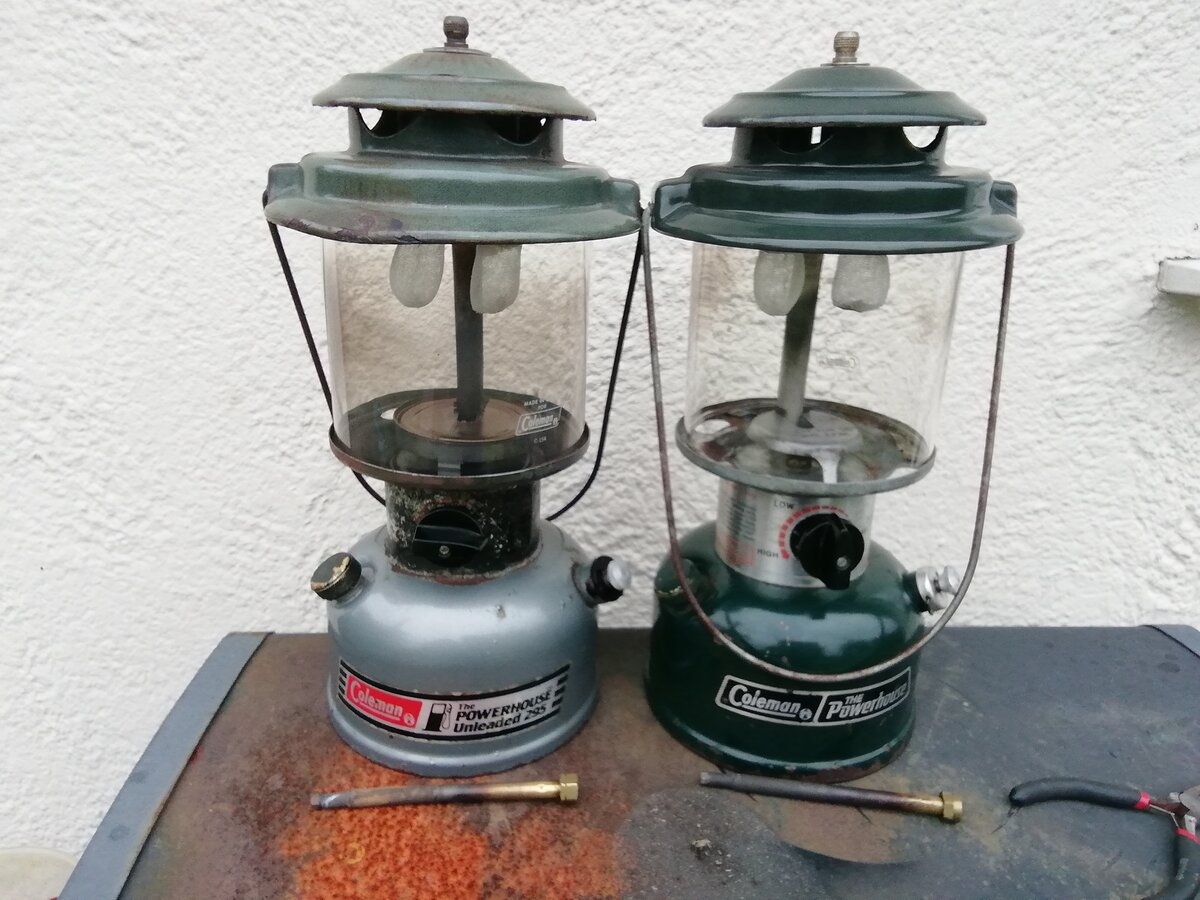

    The first picture is the lamps that were used .
    The generator on the left is the 295.
    The messy one in the right is the 290a.

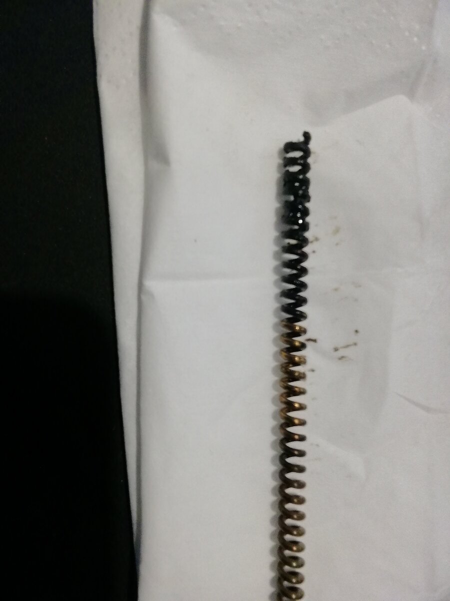

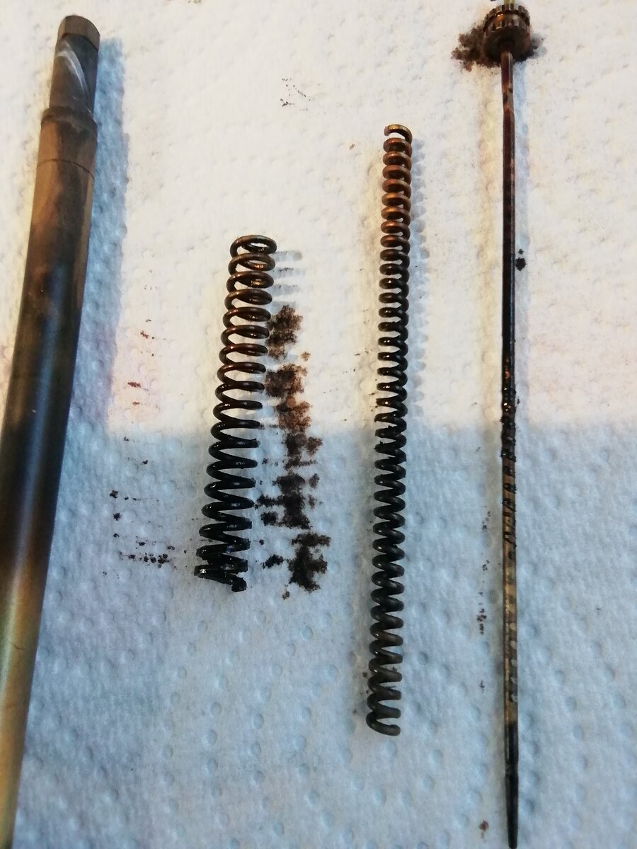

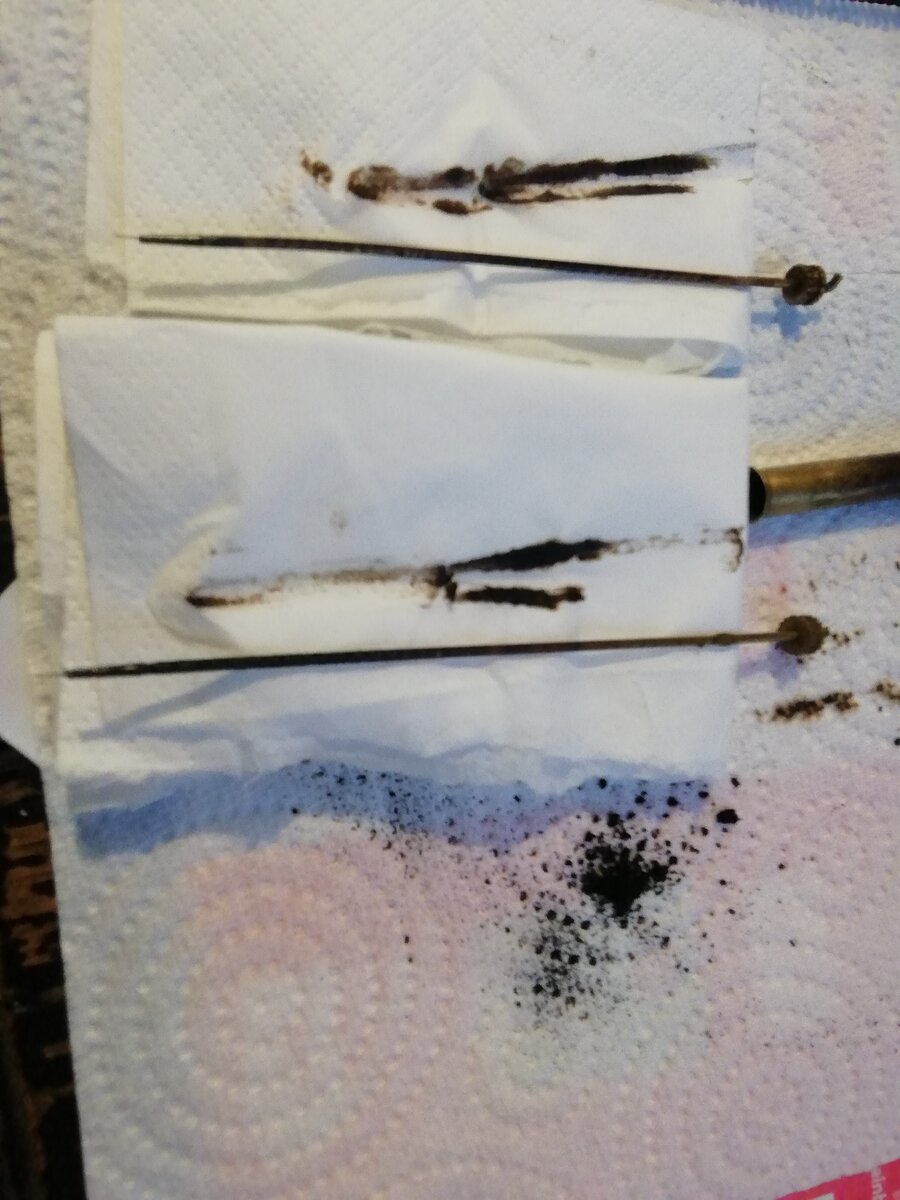

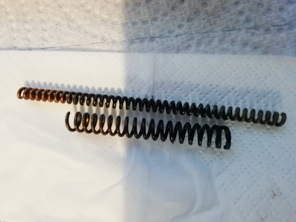

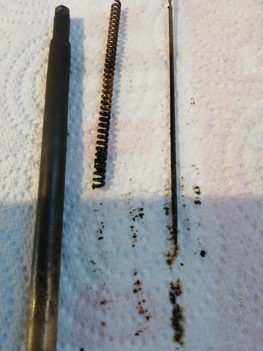

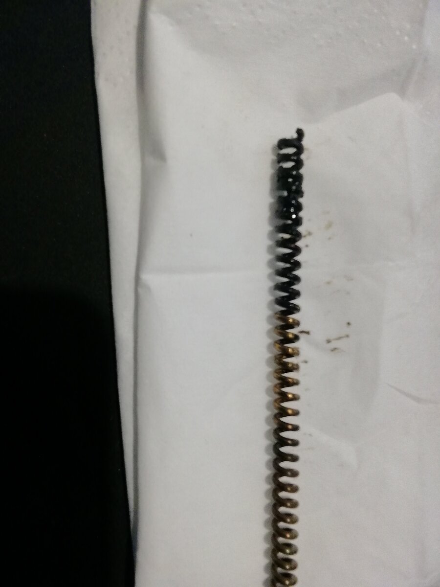

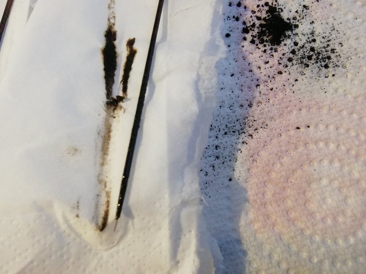

    The 290a did have the card tube and the spring, well I managed to get the spring out but the card tube crumbled into a gritty soot .

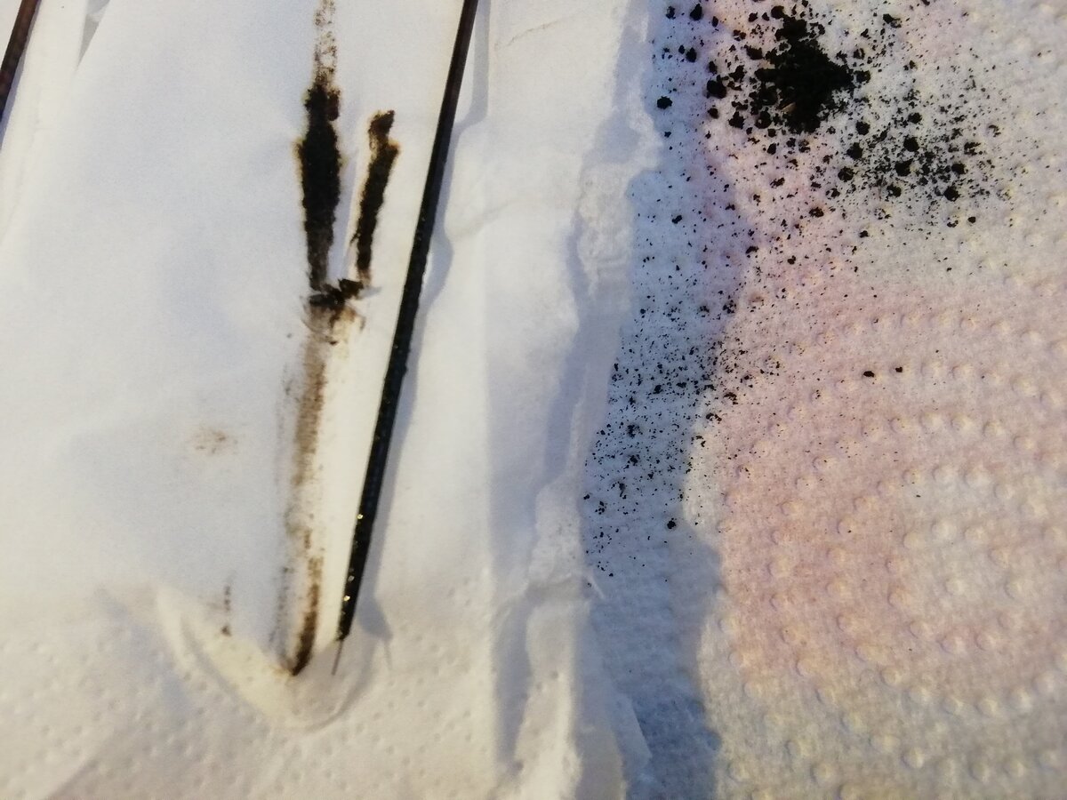

    The picture of the 295 shows that it is blackened but it is no way as sticky as the 290a.

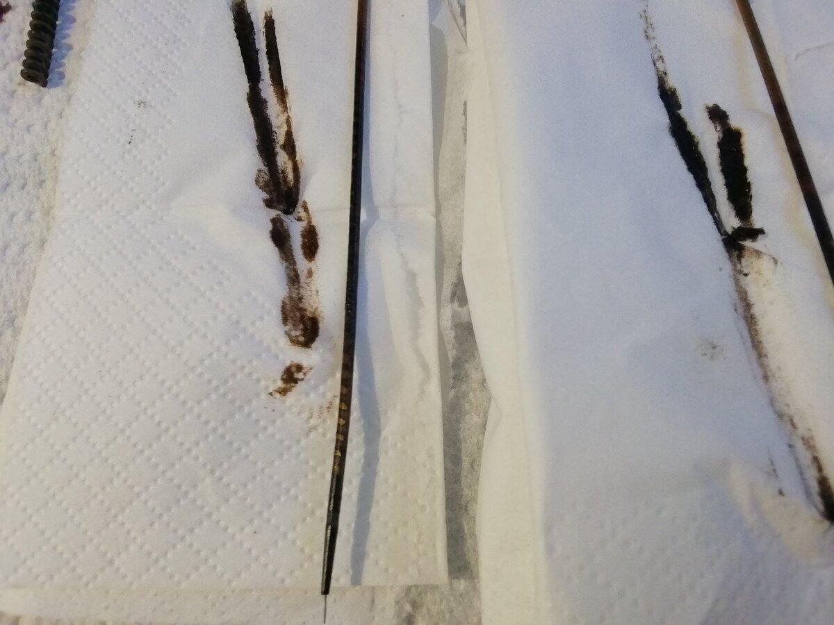

    You can also see a slight difference between the two cleaner rods ,the 290a has a very slight amount of deposits that didn't wipe off in to the tissue ,the 295 however wiped off a little easier as if the gum was thinner .
