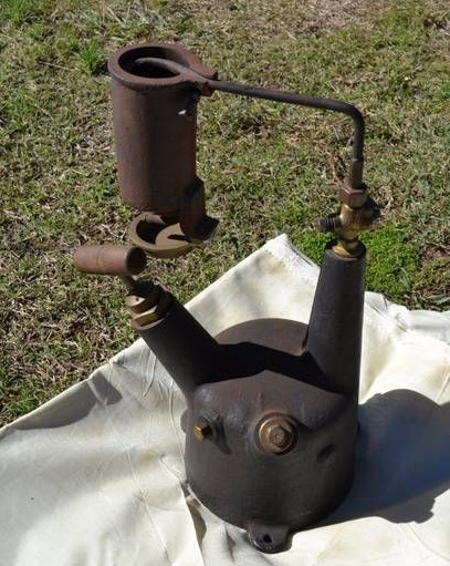

    I came across this burner for sale with the description "Kero Burner for larger Hot Bulb Engine. Complete and operational."
    I have no idea what a hot bulb engine is but I thought others here might find it interesting.

    somewhere between a diesel and a petrol engine.
    A hot rod went in through the cylinder to ignite the fuel air mix. I guess it's an oil engine with not enough compression to make ignition through the diesel principle.
    I guess it was necessary to keep the bulb hot - or maybe not after running long enough.

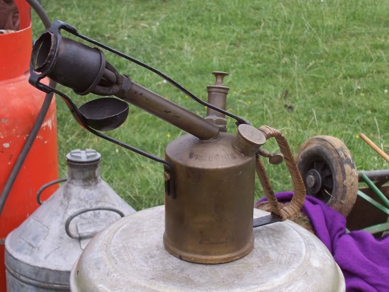

    My main interest is stationary engines, which lead me to lamp collecting so I am quite familiar with hot bulbs engines and starting lamps.
    I have an early 'hot tube' ignition engine which works in a similar principle, but this time the blowlamp is heating a stainless steel tube screwed into the cylinder head. I am looking for a particular lamp for this engine. Its a B A Hjorth Vesuvius, for a Petter Handyman oil engine. They do turn up but I have missed the last couple that went for sale... Anyone have such a thing on a shelf ? :)

    I have seen that type of long necked blow lamp with the stove type burner now and then.
    They are pretty rare, though, but I'll keep my eyes peeled for you.
    The one you show here seems to have a single jet burner?
    There was also a model with two jets and a more oval shaped vapouriser.

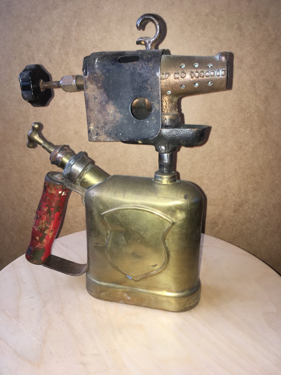

    This one is to start a hornsby engine,
    I have a 5hp hornsby hot bulb and this blow lamp is for the hornsby engines.

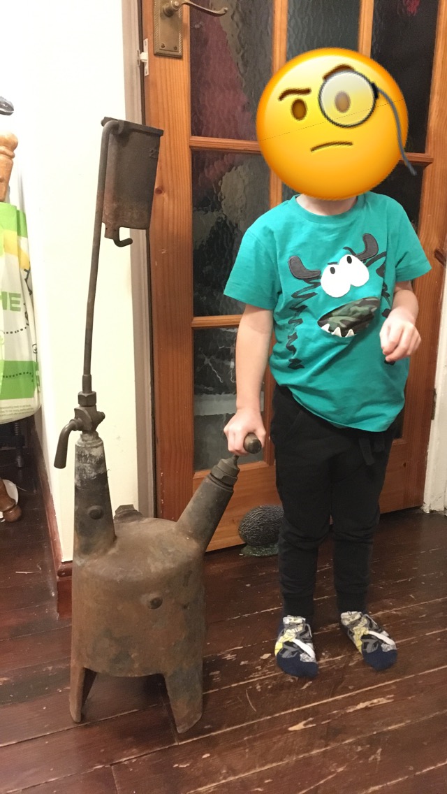

    I Have one of these lamps in my collection. They made various lengths (this being the longest). I have a collection of starting lamps for hot bulb engines. I find their designs really ‘quirky’.
    I recently acquired this (the largest) blow lamp for starting a Hornsby engine. This being the largest of a range of blow lamps produced for this purpose.
    Britain produced a huge range of engines which were used for powering belt driven factories, as well as many smaller engines, the likes of which were exported around the globe. B723185E-BF07-4B9F-B9DC-F1FF34E59740.jpeg
