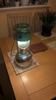

    Or rather how do you get the meths into it?
    Picked this up in a junk shop this afternoon for 20 quid, washed the dirt and spiders out, quick once over with some brasso, stuck a Tilley mantle into it, and it just worked - no apparent leaks and ran it for an hour with no problems.
    However, with the mantle unlit, it was easy to put the meths in, but now I'm not sure how to relight it...how do I put the meths in?
    Thanks,
    Matthew

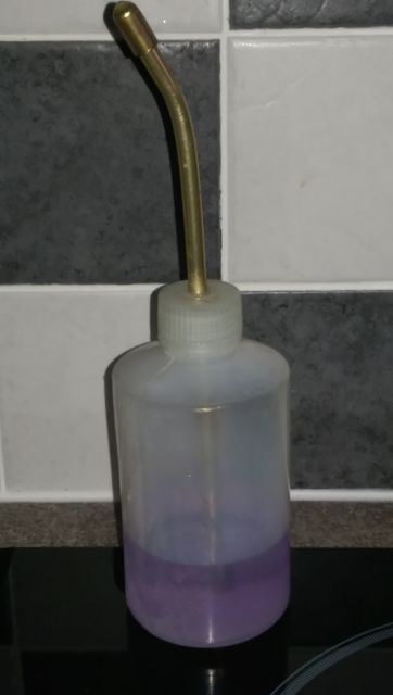

    I use this. It's a nitro fuel filler bottle for RC cars etc. Got it on ebay for a couple of quid. Does the job perfectly.

    I've got one of those too - perfect for the Petromax and Optimus, but too big a tube to fit under the glass on this.
    I did try the proper Petromax filler I've got, but that got meths all inside the lamp, not just on the burner, so lighting was a little more dramatic that it should have been.
    I'll make a trip to local model shop and see if they do a smaller fuel filler, or maybe a small fuel tank for a model plane and a bit of brass tubing would do the trick.
