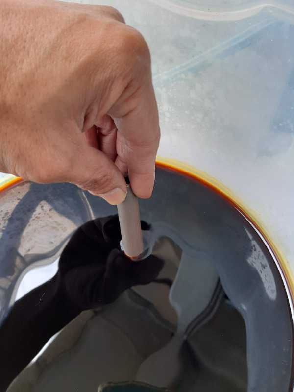

    Here's a simple example of how I do it without elbow grease:

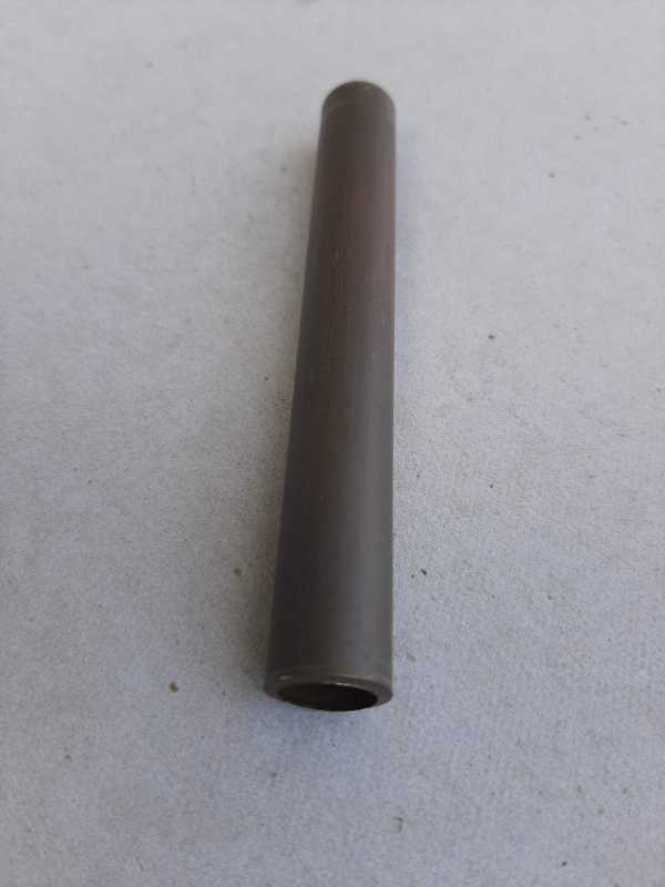

    The above shows the picture of a piece of highly tarnished brass tube.

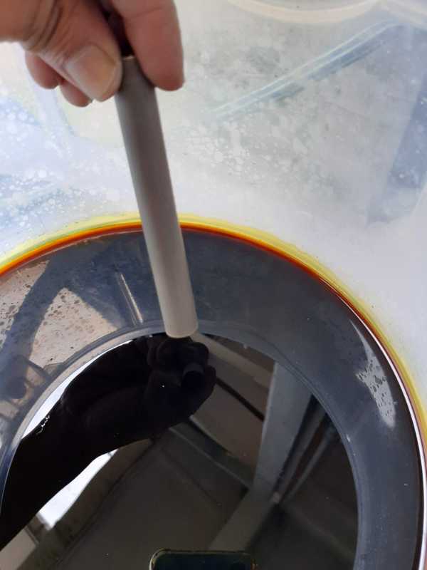

    I'll dip it into my pail of 'witch's brew'. Its acidic but does not fume or cause severe burns if you accidentally get it on your hands. Note that I'm not wearing gloves.
    So I'm dipping part of it into the brew. Duration: just 10 seconds.

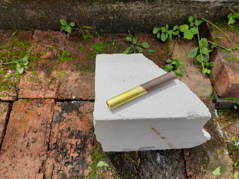

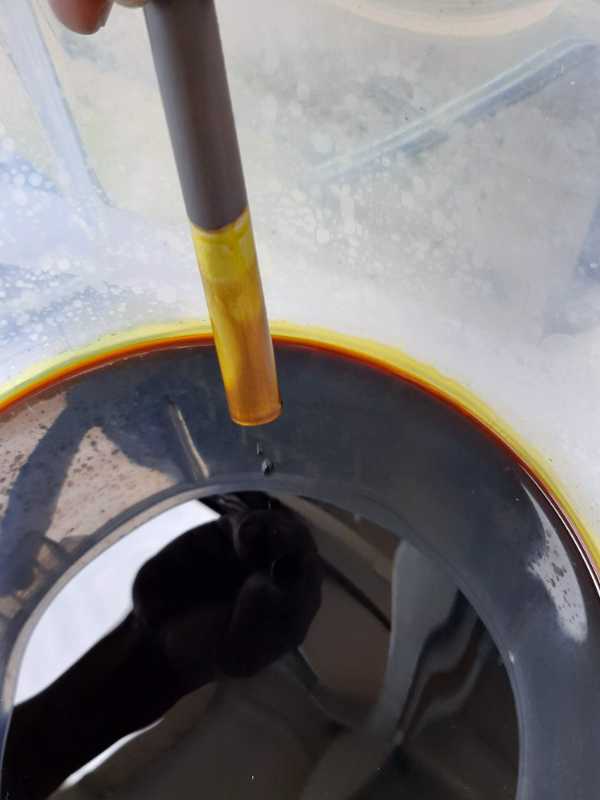

    Withdraw it from the brew. Note the difference? Its brightened but no reddish or pinkish copper on the surface.

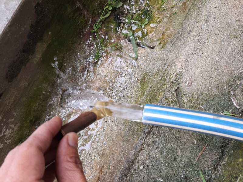

    I rinsed it in cold running water.

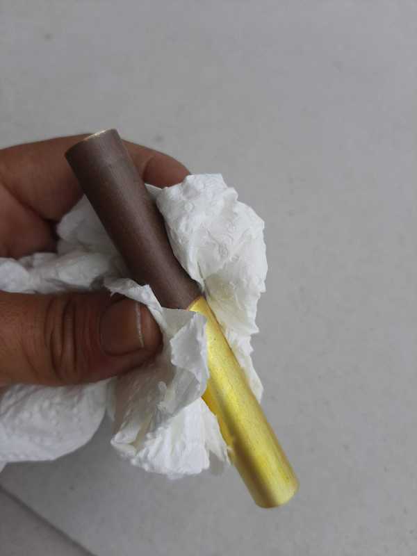

    Wiped it dry with a piece of paper towel.

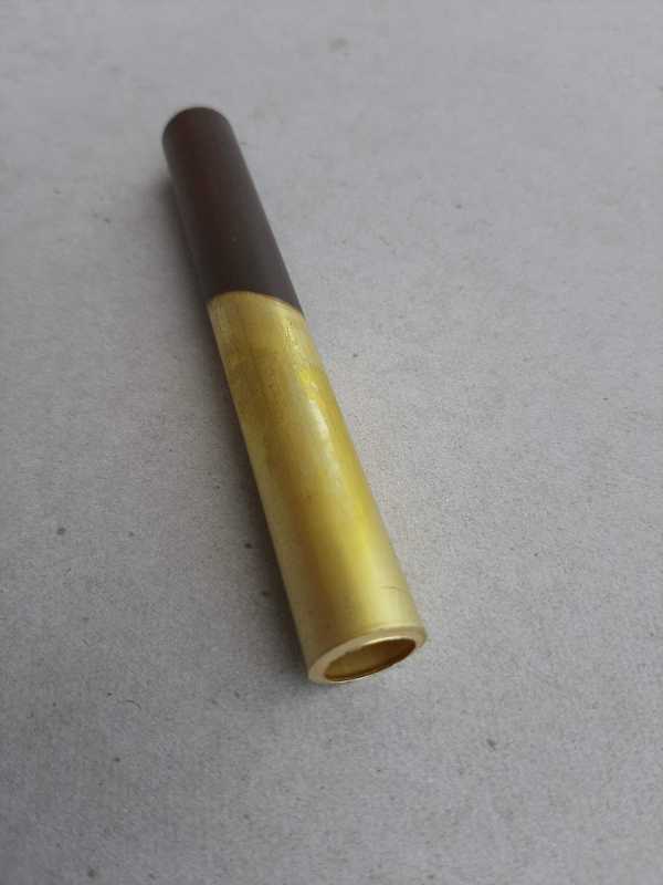

    Here's what it looks like after drying. Any fans of bare brass around?
    So, that's how easy it is for me to clean brass. The cleaned brass will not tarnish for a long time under normal atmospheric conditions.

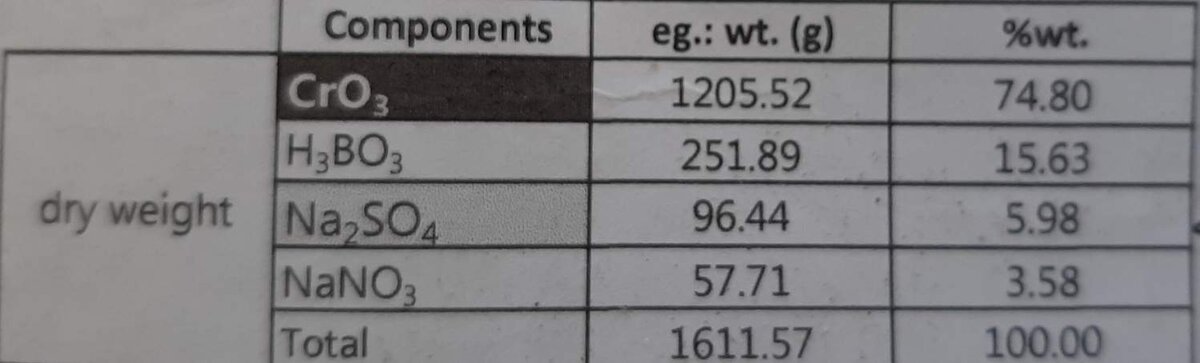

    I'm not exactly certain but I think I might have found it. Looks like it ain't too friendly after all. I'm using it anyway. You can't simply dump the spent liquid into the drain. Here it is.
    Dissolve the following chemicals into eight(8) litres of de-ionized water:
    That's my dark red witch's brew.:p
    Here're the names of the ingredients:
    CrO3: Chromium Trioxide.
    H3BO3: Boric acid.
    Na2SO4: Sodium Sulphate.
    NaNO3: Sodium Nitrate.
