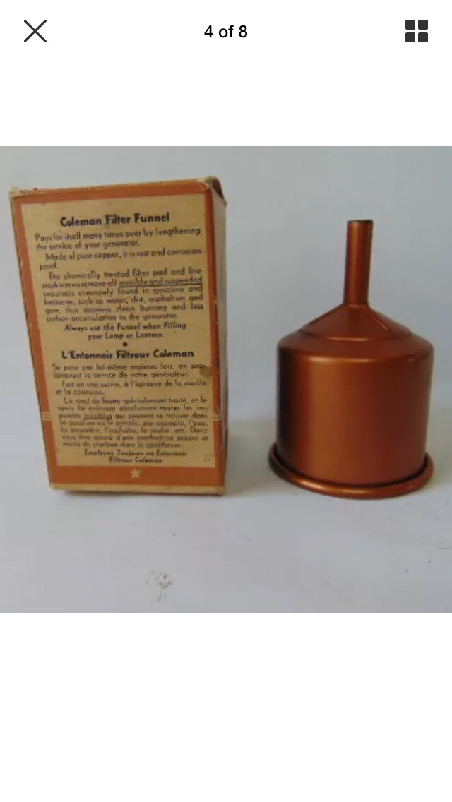

    Can someone please tell me the best way to clean a Coleman Copper Fuel Funnel. Its near mint no dents just dirty. I was told by a guy at work use salt and white vinegar place in a bucket for 30 mins. Im just worried if i do this will it dull or take the clear coat off the fuel funnel, or eat or pit into the copper. Any advise would be appreciated or if anyone has any experience using this mixture. I have a great coleman display of items want to add to it with this beautiful copper funnel.

    Clear coat, you say? Is the funnel clear coated?
    In that case you should stay out of Autosol, and probably vinegar too.
    Just give it a gentle clean up with a mild detergent and water.
    Since you say it's near mint, there should absolutely not be any needs for anything else. Just wash it up in the sink first, and see how it turns out.

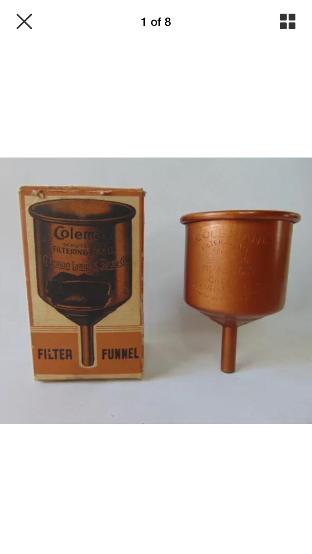

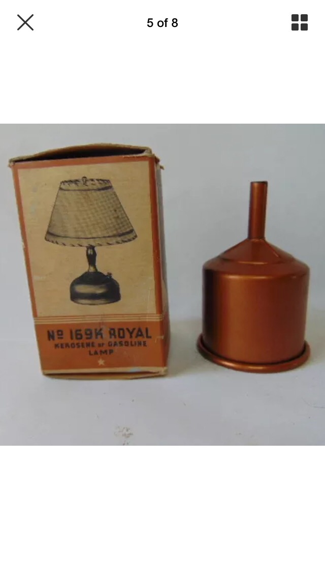

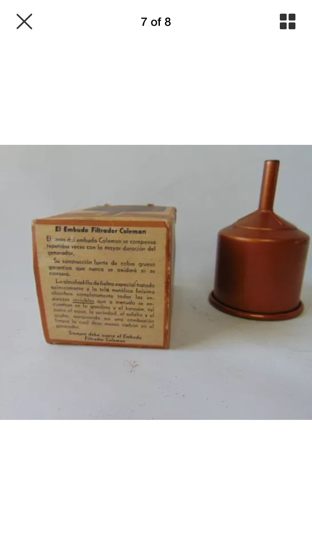

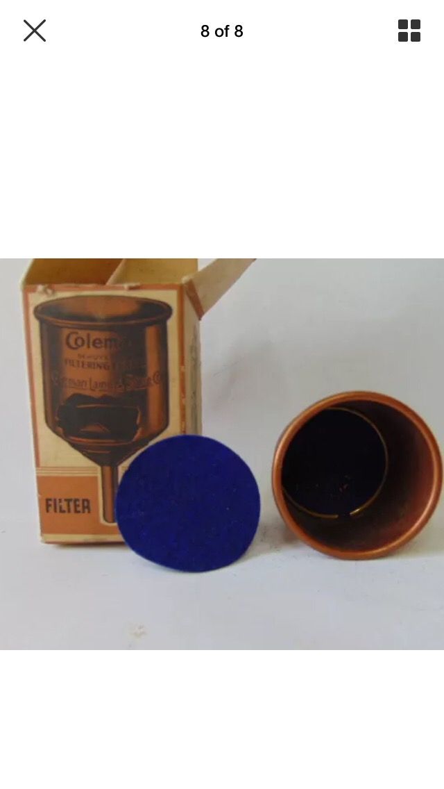

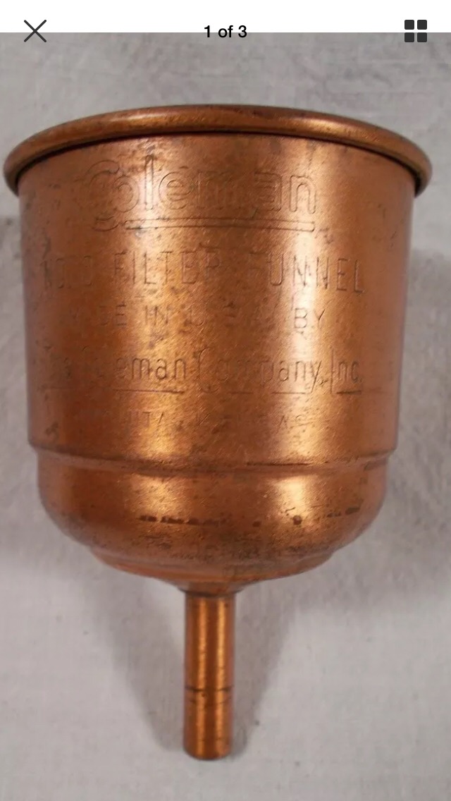

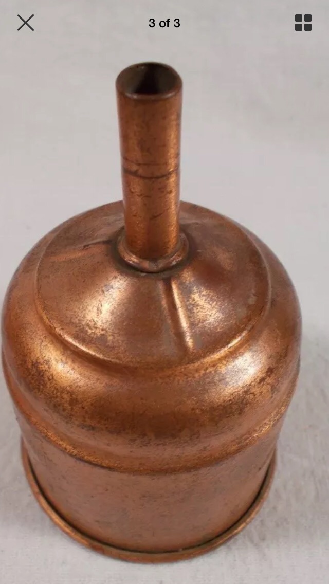

    Not sure if the clear coat is coming off or even if it has one, but if you look at the pictures closely it’s patchy.

    As what Carlsson said or just leave it as it is.
    Unless if you really want it to be brighter and don't mind removing the clear coat(if there's really any), then Autosol.
    Autosol's available almost anywhere.
  13. Carlsson
    3,966
    I think it looks like it's in the best condition possible. A genuine, unused NOS-part.
    Why would you polish that one up? Anything abrasive or rough cleaning would make it almost as an used object, and destroy its rareness, if any.
    A gentle rinse in water and perhaps some dish soap (i.e. not any kind of machine washing detergent).
    But each to his own. If you like shiny objects, it's just to start polish.
    It's your own loss ;)

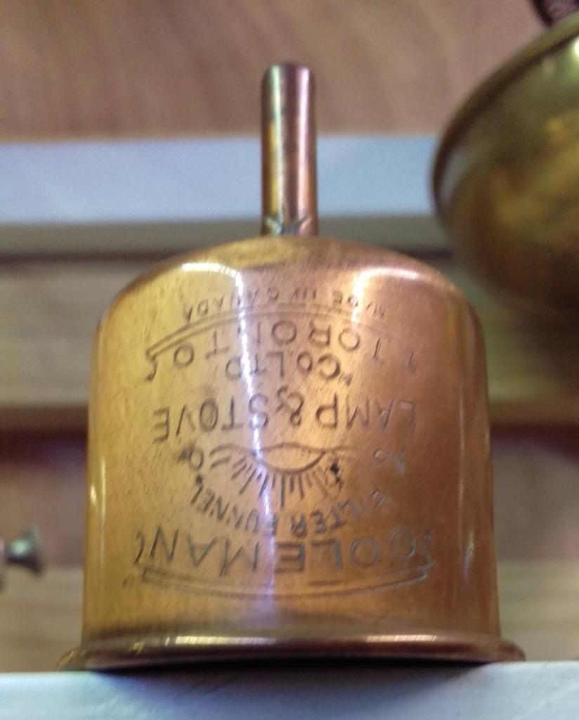

    On the copper funnel below the original thick clear laquer was mostly intact, just a bit dirty.
    The Autosol cleaned it up nicely. It has a nice deep glow or shine to it. It looks lighter in the photo than it is.
    I last polished it when I got it a few years ago; it still looks good on the display shelf.

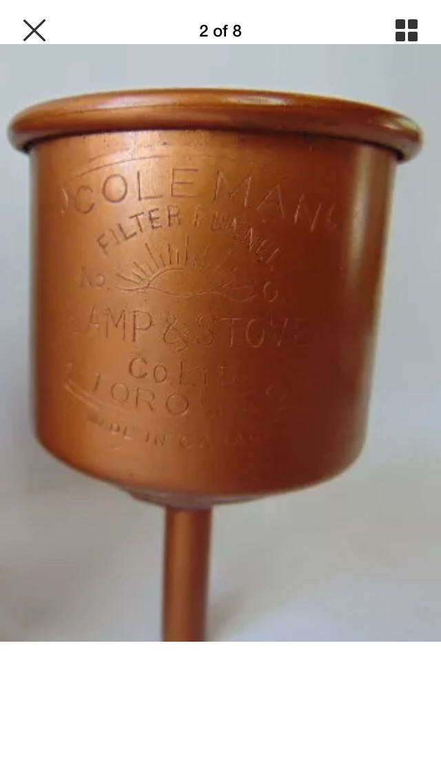

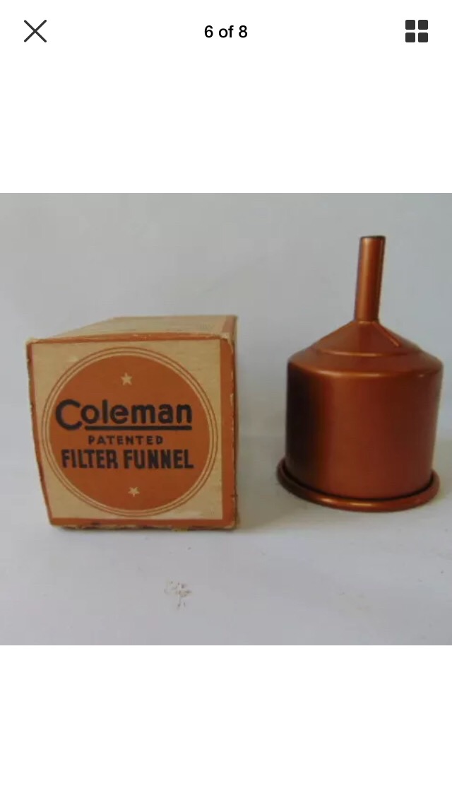

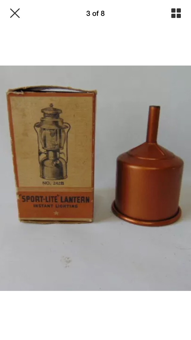

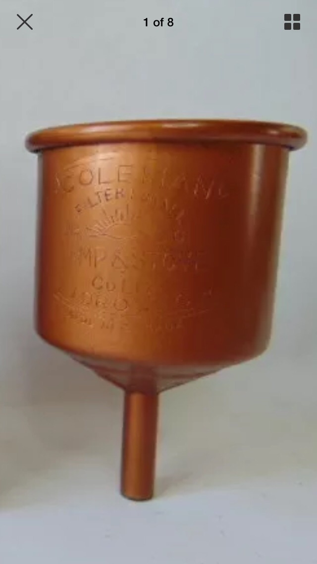

    Ok Ok Ok i have read everyone’s thoughts and opinions regarding cleaning this. With all due respect to everyone that piped up and voiced out, i agree your all rite. Looking back and reading over the replies im thinking now what the hell was i thinking, i could of destroyed a bit of history due to my OCD lol.
    I 100% agree with Carlsson,David,George,ColinG leave it alone let it show its true age and the road its traveled.
    This is my second Coleman Copper Funnel, this one is shmick, comes with the box and spare filter unused. This one is from Canada - Toronto. My first one is from Wichita, Kansas, i’m not really sure what the difference is Toronto vs Kansas but still i dont see many like this, with no dings or dents. Also why no mesh filter in the Wichita, Kansas funnel ?

    That is indeed a fine funnel.
    It would be really good if you could post pictures of it in the Reference Gallery here:
