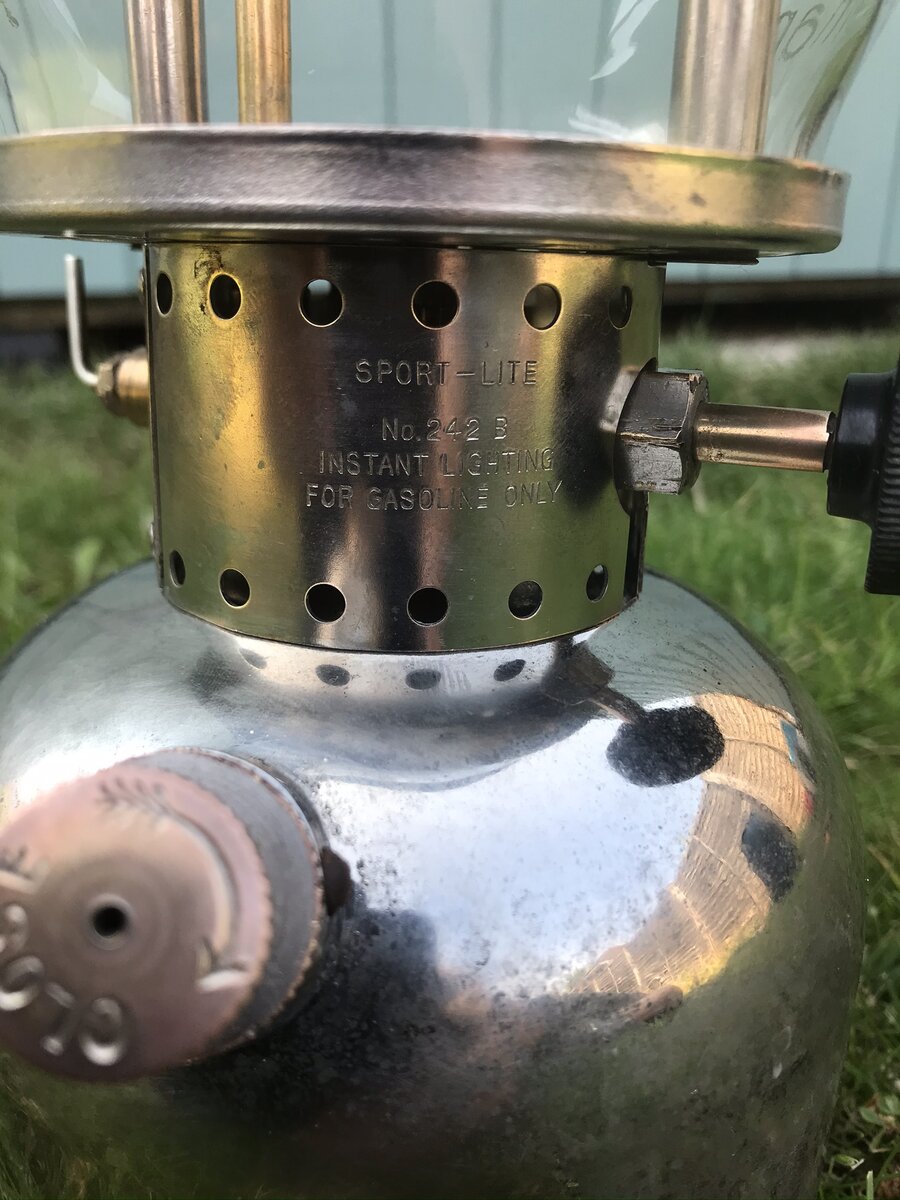

    Simon, Does your lantern have the model number stamped on the collar (base rest)? Doe's it have the small reservoir at the base of the generator like on a Coleman model 247?

    There’s no reservoir so somewhere along it’s history the generator got replaced with a kero one. It was my grandfather’s so maybe he just had to make do during the war. It works but I’m still trying to work out the most efficient way to light it. 94CC1B6E-1029-45DF-8869-E746FD1103B6.jpeg

    Yes I thought it odd as I believed Coleman Canada only made 'gasoline' 242Bs. Have you tried using kerosene and perhaps just attach a tilley metho pre-heater cup to get the thing working. Good luck anyway and it looks like it is in good condition and has the wonderful family attachment
