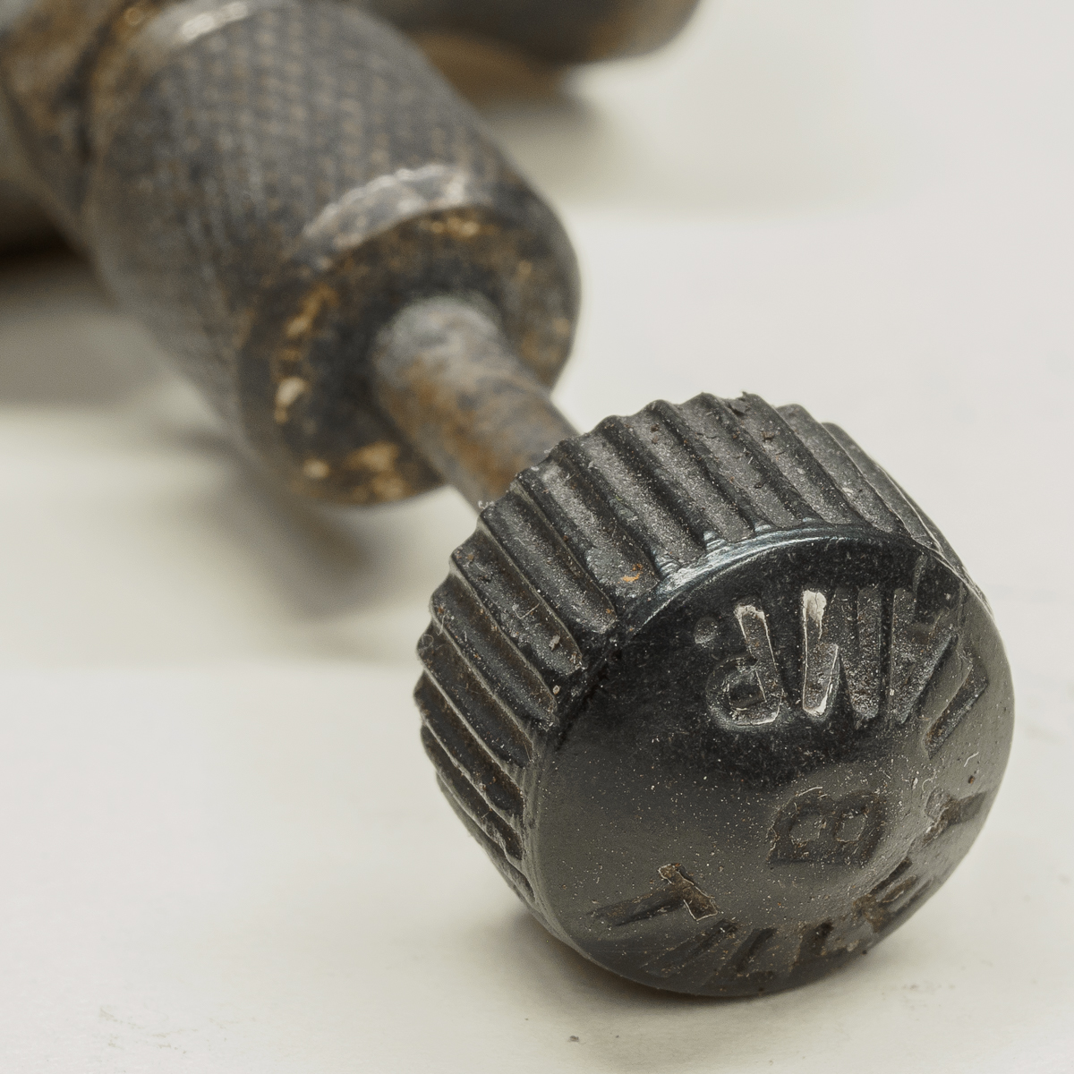

    As mentioned in another thread I am currently in mid fettle of a lovely old Tilley FL5. I have removed many control cock knobs during the course of my pressure lamp education, but not this type. I would love advice from you experienced folk. thanks.
  2. BigStevie
    It should screw off. Some early types of this style have a small grub screw, though I’m not seeing it on your pics.
    Stevie

    Thanks Stevie. I assume it is a rigt hand thread?
  4. David Shouksmith
    Righty-tighty; lefty-loosey!
    Remember to use a thin strip of leather or similar to protect the lamp bits from the plier jaws... :thumbup:

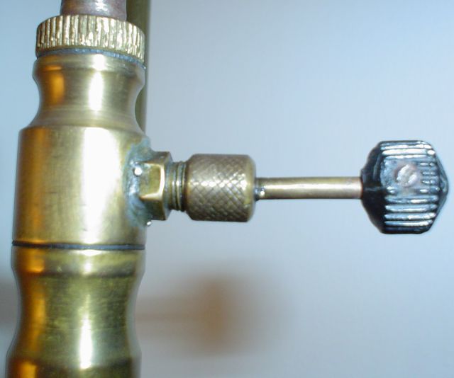

    16,871
    It should unscrew anti clockwise, however, if it is an early knob then the grub screw can be difficult to see because the hole is countersunk and over the years it becomes filled with muck, this photo shows an example.

  6. R100 United Kingdom
    Jul 26, 2019
    354
    Thanks Jeff. I reckon my example has no screw.
  7. R100 United Kingdom
    Jul 26, 2019
    354
    The knob was safely removed today. Thanks all.
