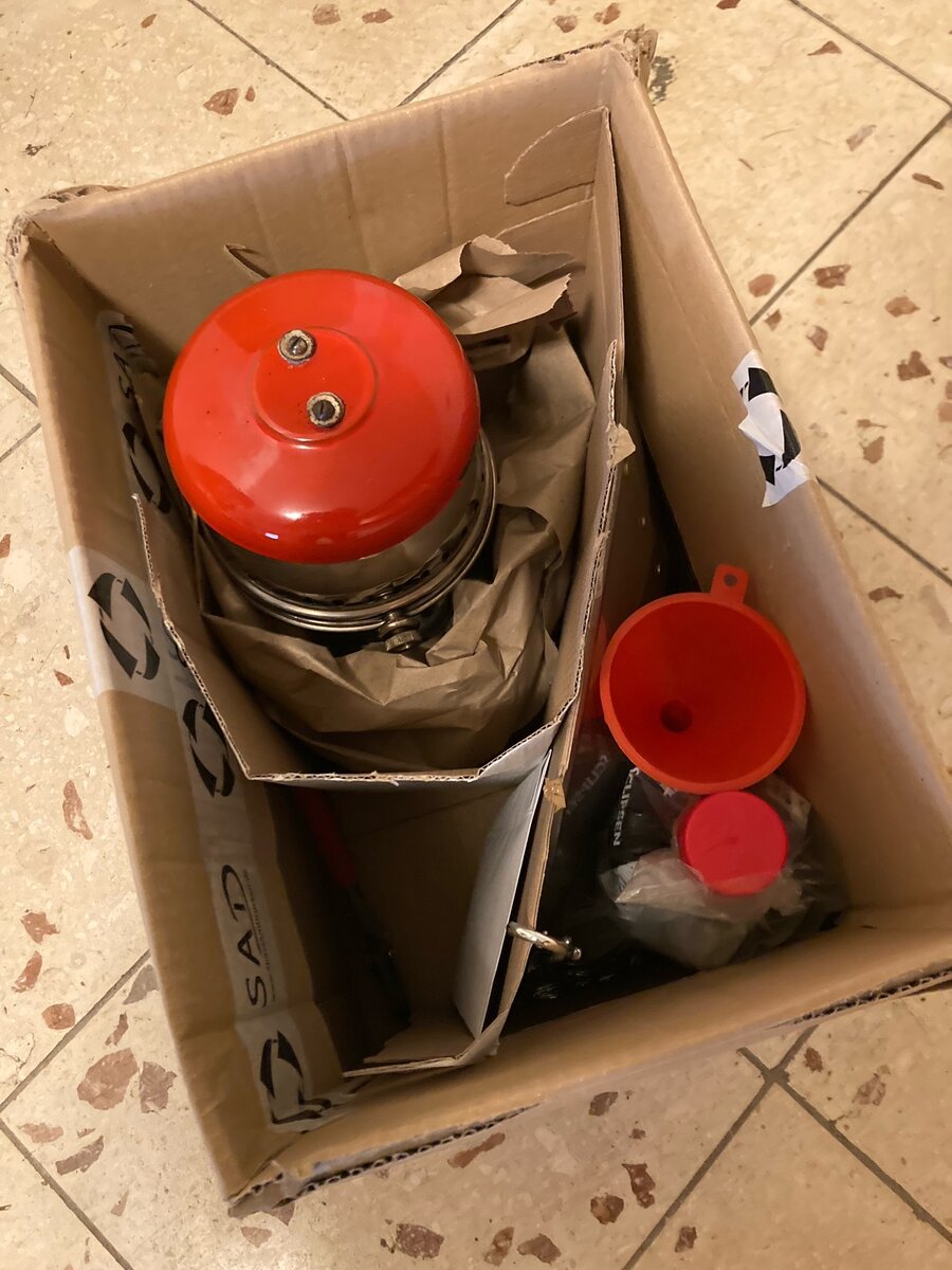

    Hi all,
    next weekend I would like to take one of my pressure lanterns for a short camping trip.
    On a 'regular' petromax I would leave the fuel in the fount, close the bleed air screw, close the footvalve and just put it in the car, fixed in a upright direction.
    Now I would like to bring my Optimus lantern, which has the old style of vapourizer without a shutoff valve... :-k
    How would you transport the lantern?
    - Empty the fount, close bleed air screw
    - Keep fuel in the lantern, transport with open bleed air screw, hope that no fuel leaks during transport
    Any other ideas from the experts? :content:
    regards from germany,
    kk1992

  5. kk1992 Germany
    Sep 25, 2022
    7
    Alright, the consensus seems to be to drain the fount. Better safe than sorry I guess. ;)
    I found an old cardboard box that fits perfectly.
    The fount is empty, the pricker is down and the bleed air screw is open.
    Package for the weekend:
    - 1 litre of fuel
    - priming bottle
    - top reflector
    - two spare mantles
    - lighter
    - fuel funnel
    - metal chain with to carabiner shackles
    plus an adjustable wrench.
    Am I missing something? This should be enough to keep the lantern running for the long weekend.
    - kk1992
