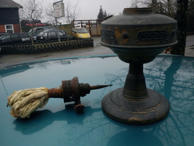

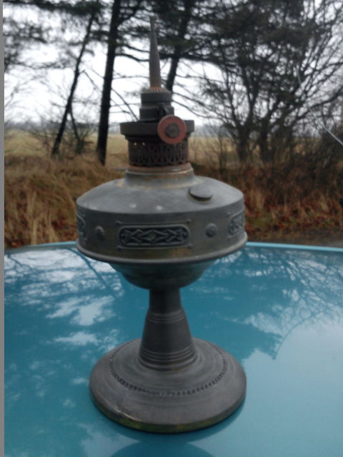

    This is a new fettlingproject to me. The "Kriegslicht"=(Warlight) is made of iron under the 1.ww and burns alcohol, while it was possible for people at home to produce the fuel without being in competition with the army.
    The Kriegslicht works the same way as the Tito Landi, though both to me really are pressurelamps, but not accepted as so.
    The Kriegslicht as the Tito landi, dont work without preheating to build up pressure and vapour, not like the Aladdin 23 that you just light without preheating.
    Did anyone here try to fettle such then please share experience?

  5. Carlsson
    3,963
    I have fettled a couple of HS2, which practically is the same lamp.
    Is it anything in particular you wonder about? I think it sounds like you got the hang of most things already. :lol:
    If the wick isn't clogged up and the orifice is free, it's just to fill it up with ethanol and give the wick time to be well saturated.
    Preheat it and let the stream of gas loose.
    A regular gaslight mantle of the narrow type works well on these, even if a tad bit too large.
    As always, I use old Aladdin gaslight mantles here too, just as with Tito Landi's.
    Good luck, and we expect a picture of it running soon enough!
  6. Claus C
    Dec 18, 2012
    1,787
    Yes PB, common depends on what time you were living. In those war-days these lamps were wide spread out and took over the normal kerosenelamps. They were even sold just as burners to replace existing oillamps and to use the same fonds as those, though some probably also was sold with original fonds.
    Today they are found often attacked by rust and not so common.
    You should show the fettling here Christer. The very thin shield around the burner is to be taken of. The little vertical screw on the side of the shield wont come of straight away. Before I use a bigger hammer I would like to know if it eventually has a left-coil or normal rightcoil and if there is some sort of lock hidden somewhere on it, a lock-screw ex.
    Second is the cotton-wick. I would like to replace it, while the wick almost is falling apart coursed by age. The wick also needs a new stick/fork to go up from the bottom of the burner, because the old one is rusted almost away damageing the wick that way too.
    So wickmaterial is wanted and a place to buy it.
    Then there is my missing gallery. Since they were made to fit kerosene-lamps originally, would it then be possible to get a gallery from a wick-lamp and hammer the 2 screw-on fittings using heat and hammering?
    If you have been through just some of that - then it would be nice to see your experience here.
    I already have a box of upright mantles and the glass I hope to buy either by StugaCabana or local here in DK.
    I will certainly not just fire it up. Its not a Volvo Christer :D I normally chase away the chickens before I start something that old up :D
    After all that - then you might get at picture of it running.
    This fond, by the way, carry traces after flame-gilding. Very very nice but a pity it only is left on 1/4 of the fond :cry:

    3,537
    Nice burners but the combination of metal (steel) and alcohol isn't a good idea.
    Biggest issues are always the wick which is stuck rusted in the burner.
    Claus do you have the gallery too ?

  14. Claus C
    Dec 18, 2012
    1,787
    No Wim I dont have the gallery. This is going to be a harder part to get ](*,) but atleast it doesnt rust so maybe kanabalising will do here - unless you have one too much for sale :D :D
    Thanks Erik, this is good links and also containing further links :thumbup:
    Well I did get the little screw of without problem + the shield.
    The wick I had to remove violently and the metal-tube around it was completely rusted, so a new tube is to be made and that recipe I found through your links Erik :thumbup:
    Right now the unit is in electrolysis-bath and looks promising.
    Fotos of this disasterprojekt will come.
