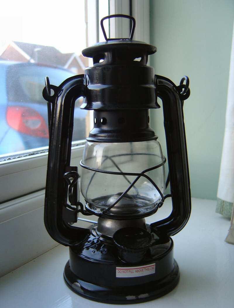

    Well they don't come much cheaper than mine!
    What sort of baffle and would this fit directly above the globe?
    I bought four of these in different colours, red, black, blue and green. For the price it's really remarkable they can make them at all but now I have them I want them to work as they should..
    Here are the pictures..

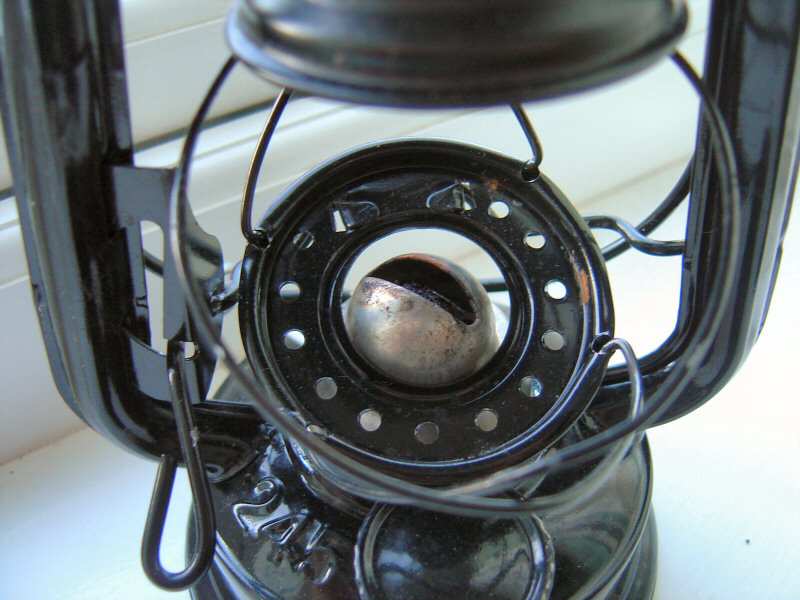

    In this second picture you can see the ring of holes I was questioning earlier..
  10. oldlanternman
    Nov 13, 2012
    45
    The baffle is up under the hood where the air tubes attach and covers up the openings so that the air reaches the tubes openings INDIRECTLY. Deflects the wind.
    I Like those, they're cute. :D
    Oh- and the holes in the globe plate are normal...
