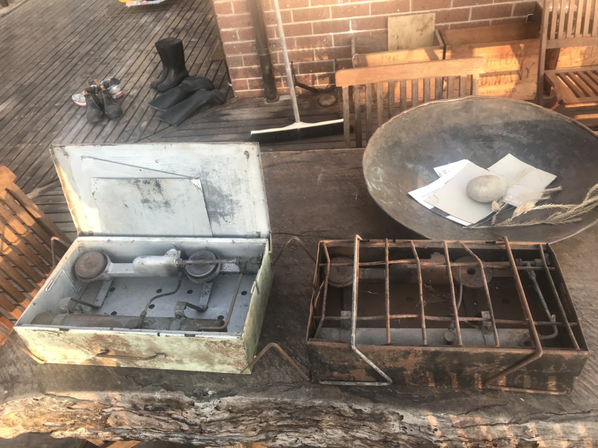

    Not a lamp, but another part of the Australian Gloria story.
    I should be able to get one fully working stove out of these two:

    Working on the stove case:
  12. JEFF JOHNSON
    16,927
    It's progressing!:thumbup:

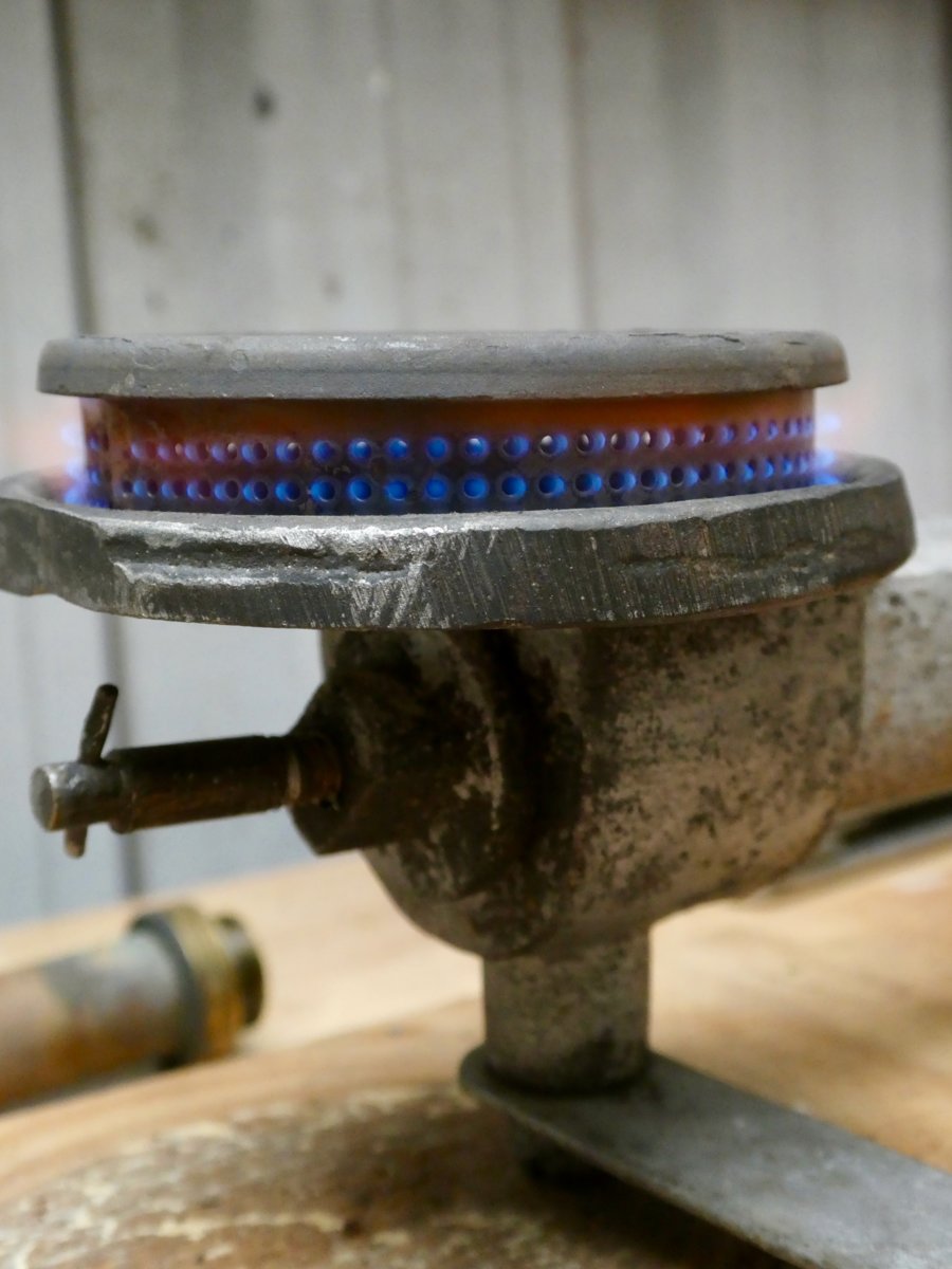

    Carefully getting there... After pulling it apart and fettling bits and pieces, I’m almost ready to test-light it. At the moment it holds pressure and hisses at the right places (and doesn’t hiss at the wrong ones).

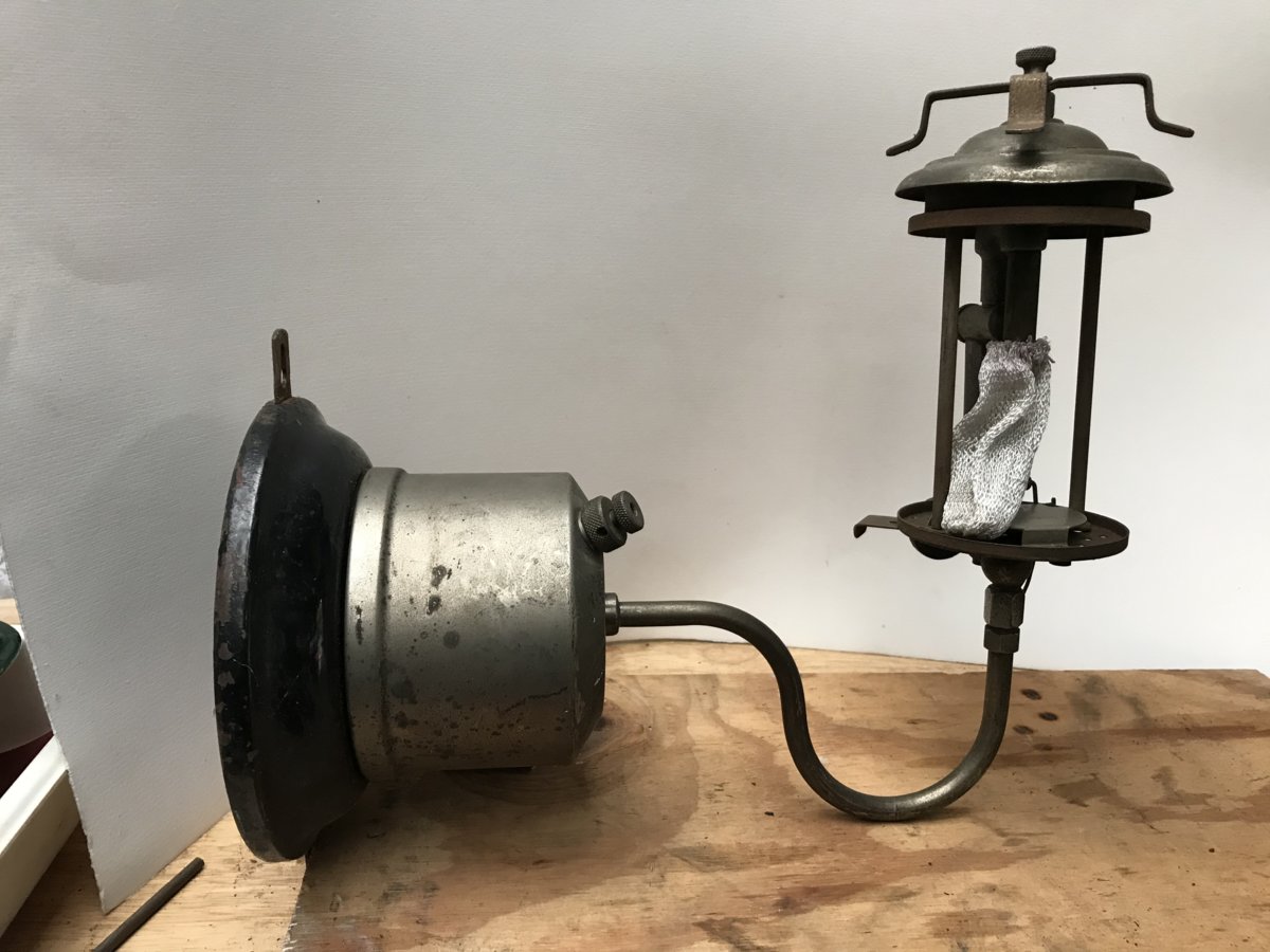

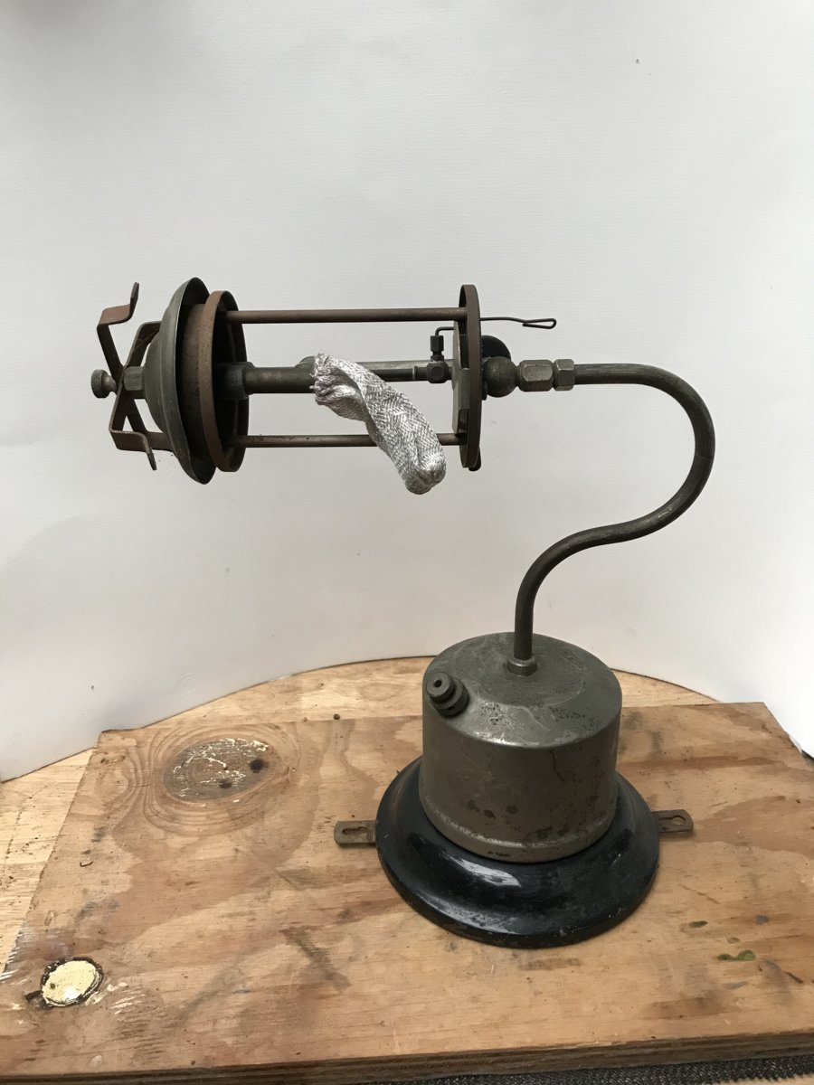

    11,105
    For those who like a good wall lamp, this should be a treat. It’s not Gloria, but it came in the same pile...
  25. BigStevie
    That’s a belter Tony! In my ignorance, I have to ask, what make is it?
  26. Tony Press
    11,105
    It’s a Crystal-lite No. 9 wall lamp, made A. J. Alsdorf Corp. Chicago USA.
    More photos from an earlier thread here.
    Sold in Australia in the mid to late 1920s. It’s not very common. It has the fittings for both the mica chimney (globe) and a glass shade.
    I’m looking forward to getting it running.
    @BigStevie
