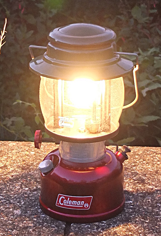

    Parcel arrives, take upstairs to open, bring packaging downstairs. "Another lamp or stove then?" It's just spare parts dear...
    Sorry about the non-standard colour, what was a nice chromed tank had started going rusty so has been wire brushed and treated and painted metallic red - the only colour I had left in sufficient quantity! The hood is in really good condition so it can't have been used much. Boy is it bright though!
    I think I need a new excuse now though!

    Hi expat very nice indeed, even though not a original Coleman colour it looks fantastic, you have done a brilliant paint job and it really suits it.
    It is a shame the original chrome plaiting was in bad condition and had gone rusty, i agree with your decision and would have done the same, not just to make it look nice but to preserve and protect the tank well done there

    Thanks, yes it was a shame about the tank :( I like a good chrome finish!
    It took a good wire brushing (hand wire brush then a wire brush in a drill to finish off. Then Kurust rust neutraliser and Rustoleum combined rust killer and primer followed by Holts automotive paint and three layers of lacquer.
    The decal is the original one glued back on with craft glue in lieu of a new one...

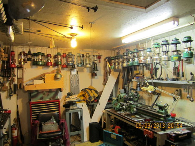

  13. Mackburner
    Dad needs to pay me a visit after which he will view the light scatter of lamps you have seem more like responsible collecting. I am not in any way denigrating your pile but if he can only see some then that is a light scatter. Here we have walkways between lamps to enable progress through the house. ::Neil::
