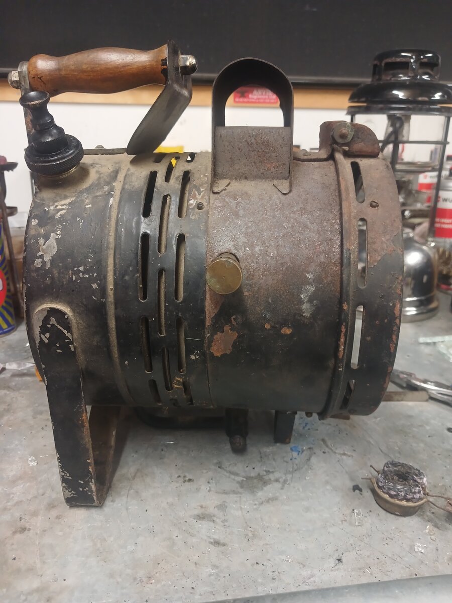

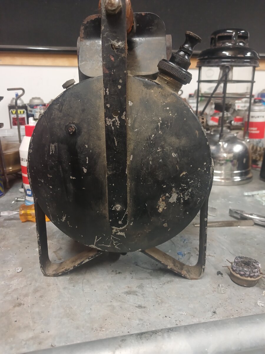

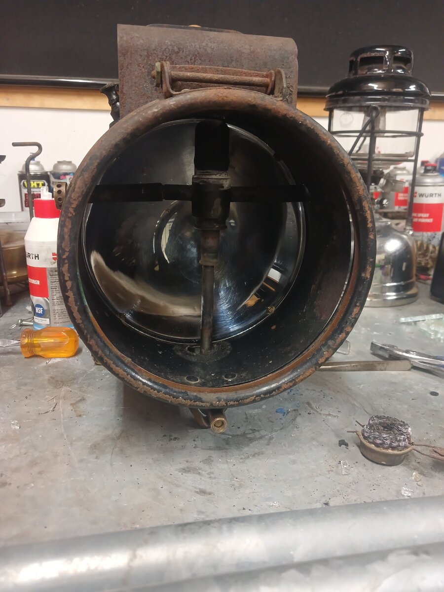

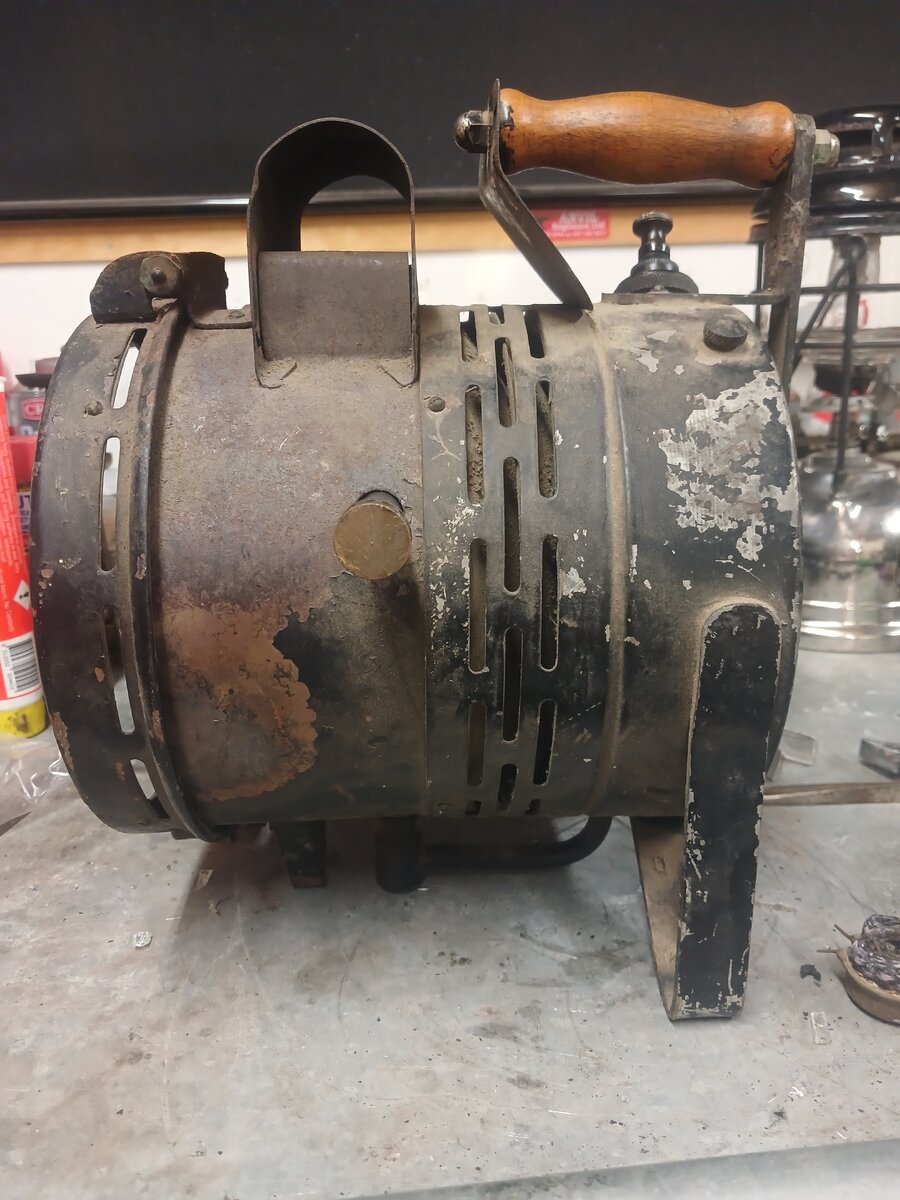

    Hi guys. I got this wee gem tonight but know nothing about it. Am I correct in thinking its an AL 21 ? Apparently this one served during the war helping light up temporary runways for aircraft. The seals are the same as my x246 uses but is the mantle the same ? If not what do I need to get ? As you can see it needs a glass so what type of glass can I use or where can I find a glass ? Is this s common lamp or a bit of an odball ? Any help welcomed as usual team. Many thanks again

    Nice find :thumbup:
    i think the control tap is just a pricker control on these, no on/off, still has the gland washer tho.. i can see a pressure release as well :thumbup:
    i seem to remember Darryl Durdin used a Fresnel lens for one of these?
    or maybe another member might have one
    regards
    pb
    **edit** yes the mantle is different but a Tilley can be used if you use a thin bit of wire to secure it to the burner? a freezer bag wire ?
