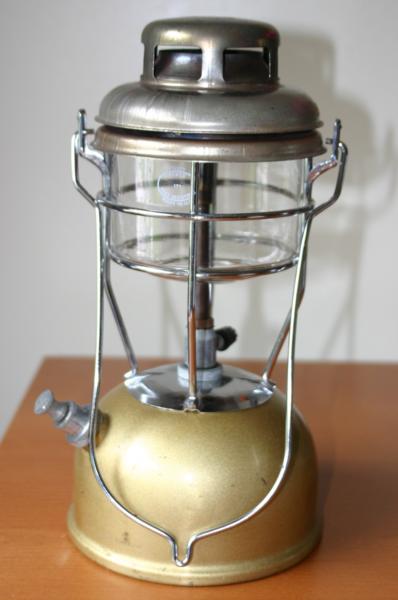

    Hi People I'm new here and new to Tilley lamps, I bought one today to see how I get on with it and to look at how they are maintained and if I enjoy it I'm going to start collecting them, anyway I have my first question so here goes the lamp I have just bought has stamped on the bottom 272XB and on the tank front it says Tilley United Kingdom, I've looked around to try and find some information about this model but without success so I'm hoping one of you pro's can help me.

    Hello and welcome aboard, the 272 stands for February 1972 and is the date of manufacture, cheers.

    Thank you both for your quick reply and help/advice. Below is the picture of the lamp in Question. ;)

    Not so common these so a nice find. Model is X246B which is common enough but this is the version with a chrome plated hood. I think I have seen maybe half a dozen of these. I know the hood looks like clean steel but when you find one in its box the box label is over stamped "Plated Hood". I don't know how many were made or for what period but so few turn up there cannot have been many. ::Neil::

    Thank you for your reply this will help me in future when I need spares. I can't believe how quick you guys respond and your all so helpful. I don't seem to get any notifications about replies but I guess you can't have everything? thank you very much and I'm sure I will be back with more questions as I buy more of these lovely lamps. ;)

    I've been trying to find out some information about this type of lame with a chrome top but don't seem to be able to find anything? can anyone point me in the right direction? and does anyone know what I can find some instructions for them?

    You got all I know on these chrome top lamps. PM me with an email address and I will bung you the instructions. ::Neil::
