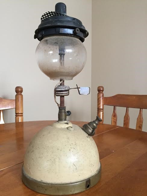

    Just took possession of this lamp that I used to learn to read and write in a little fishing village in Newfoundland, Canada. The only markings say Tilley England. Would like to identify the lamp so I can seek help in refurbishing it.

    The tank and the pump and the control cock and the vapouriser where originally part of a 1950's Tilley R-1 radiator, the handle and the reflector and the heater burner and the wire guard have been removed and a Tilley lamp burner and gallery and a 182 globe have been fitted.
    The link below shows how it would have looked.
    Tilley R1 Radiator

    So the hole in the brass band and the threaded fitting in the top of the tank were for a handle?
  5. Tony Press
    Yes. See, for example, the Tilley R1 heaters in the Reference Gallery.

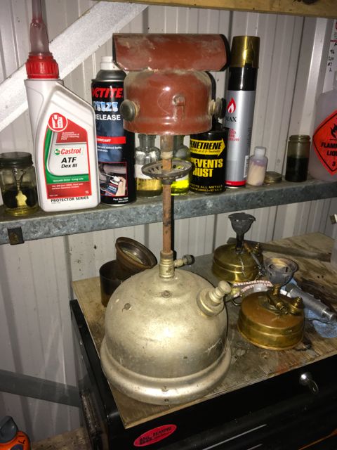

    .... by the way, I have this lamp (that has the hole/stud} for a handle:

    Tilley ..as well as other manufacturers use a 'modular' design, that is to say, when taken apart, many of the individual components can simply be interchanged with other Tilley lamp and heater models. This does mean you often see a different tank, top, reflector or glass than was originally intended. Therefore, if you were set on restoring this back to original you effectively have the choice of a heater or table lamp. Having said all of this the sentiment for me would dictate that it is kept as it is and just given a good service.
