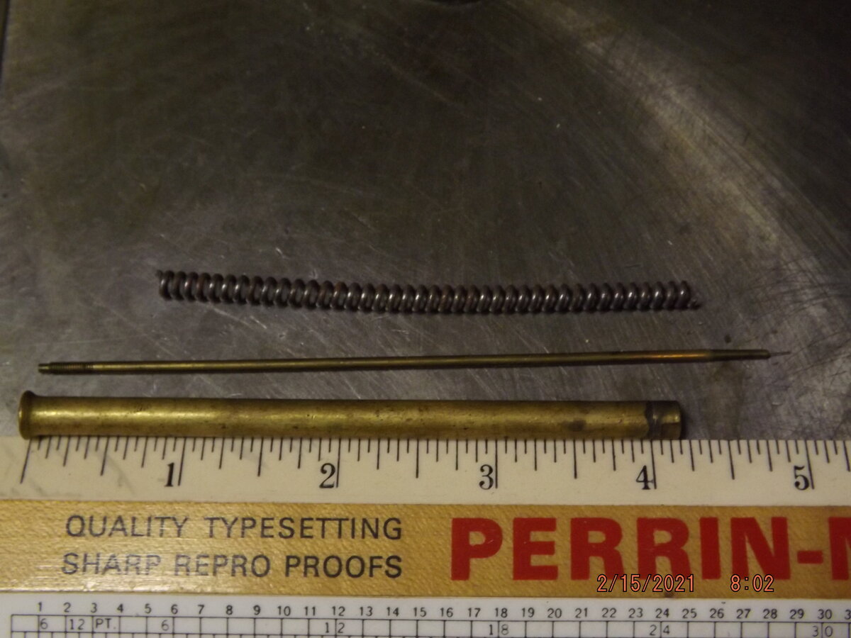

    Going thru my spares today and found a few of these generators, Fitment unknown to me.
    Just about certain to be American made, but that's all I've got.
    Quarter inch thick, four and three sixteenths inch long, steel spring internal, threaded pricker rod about five inches long, including pricker wire. Jet marked D

    Is it conclusive that the pricker rod belongs to the generator? It looks too long to me. Of course, I don't know the set up of the pricker but it does look too long.
  7. burndout
    Jan 10, 2011
    108
    Yes, I have five or six of these, all the same.

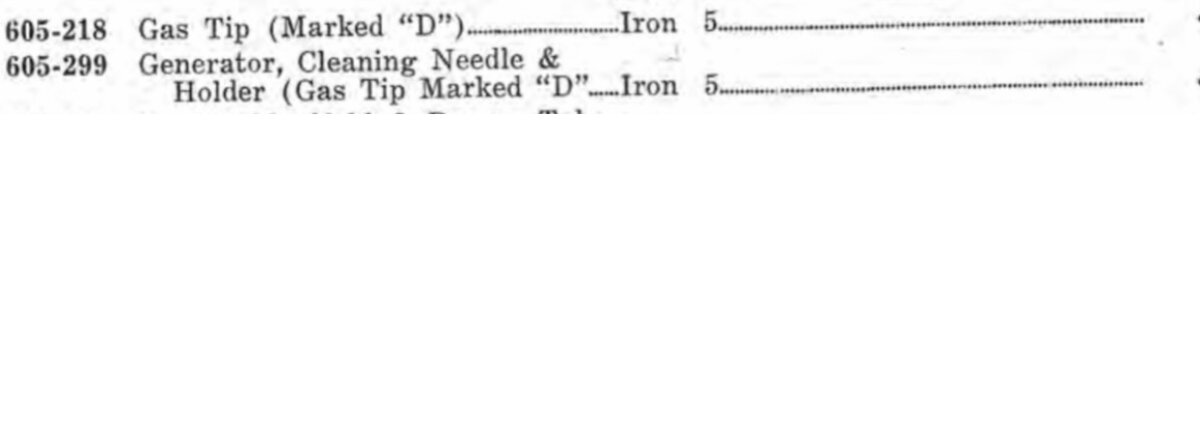

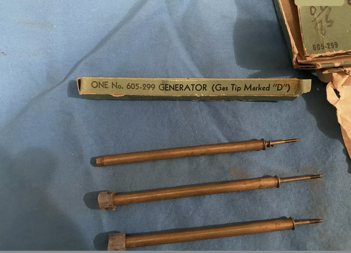

    Looks like if it is jet stamped “D” likely Coleman no. 605-299 generator for torch lighting Iron model no. 5 1929-1933.
    Jet part no. 605-218.

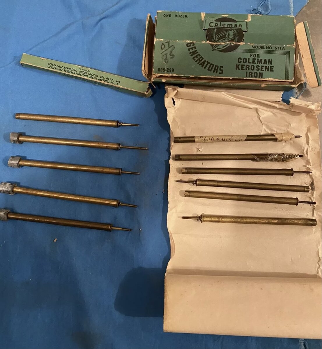

  14. coleman54
    Jul 21, 2020
    272
    Oklahoma, USA
    3ECD4519-6FFC-4AFE-A800-1AE2DA7868D2.jpeg 2209881F-CDE8-4EF6-AC4F-FCE1069332C7.jpeg

    I think coleman54 has nailed it. Coleman 605-299 for 611A, or #5 irons.
