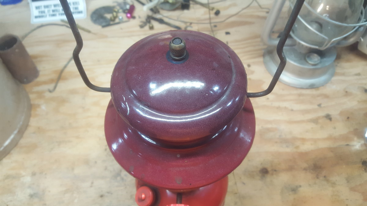

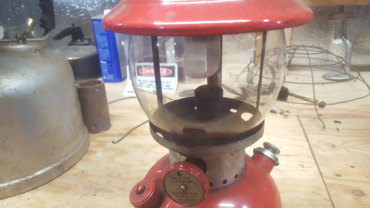

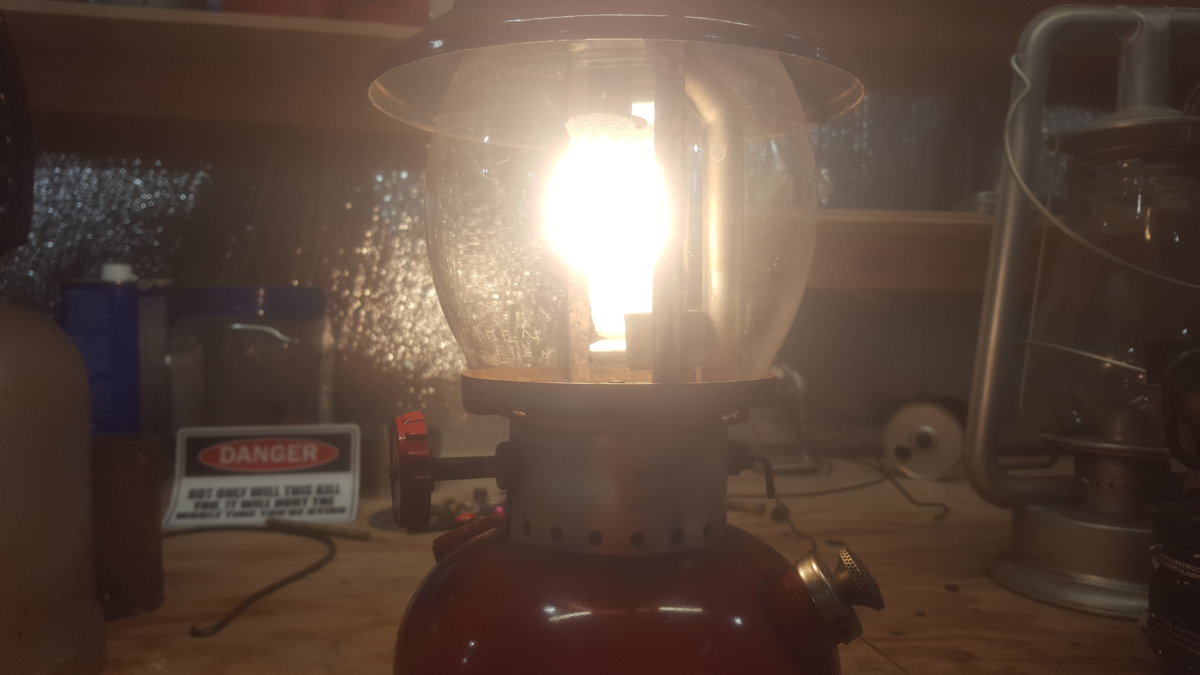

    While we're at it, here's mine, fired up this morning.
    Overview, showing preheat cup:
    Adding meths:
    Preheat:
    Let there be light? Well alright, if I must:
    Additional heat discoloration:
  16. Big ERNIE United States
