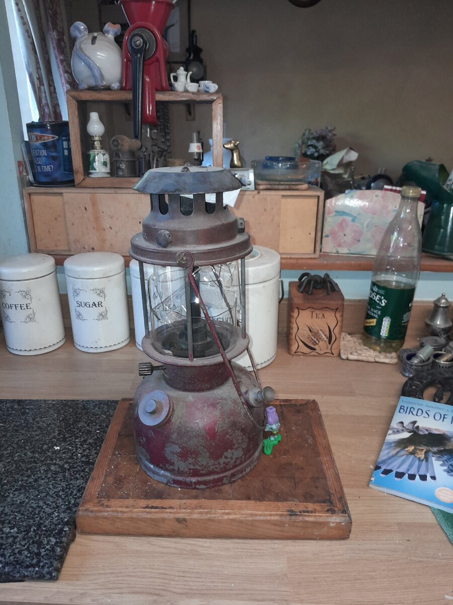

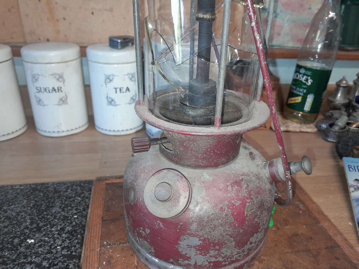

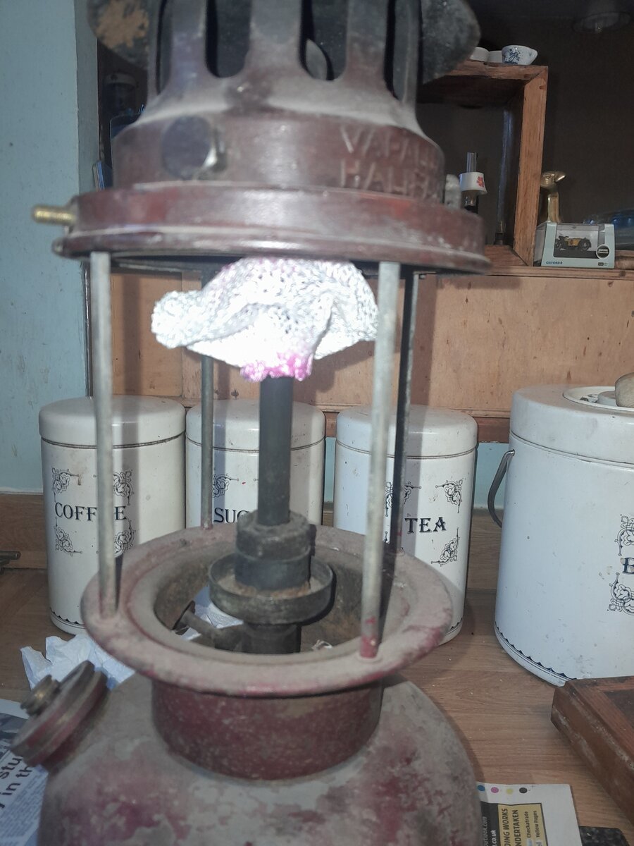

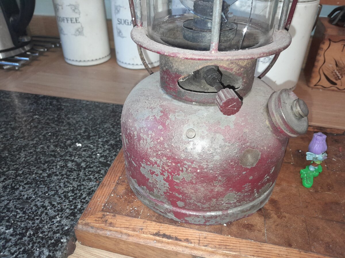

    I got this for £5.
    But the glass broke on the way home.

    It's had a repaint in its previous life, the handle should be plain galvanised....

    oh, the seller left it in the cage?
    well it’s still a bargain but a shame
    is the colour on the underneath of the base different or the same ?
    regards
    p
  4. ROBBO55
    4,453
    Vapalux E41
    E41
    It should clean up nicely :thumbup:
    16,919
    Hello Martin, it's actually a Vapalux 300 X, the E41 has a different hood.
  6. David Shouksmith
    A completely different top altogether, more akin to the Petromax arrangement...

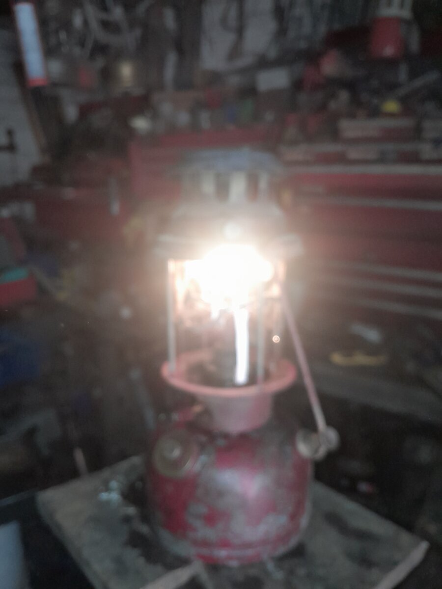

  9. The_Yellow_Ardvark United Kingdom
    Sep 13, 2020
    104
    Wiltshire.

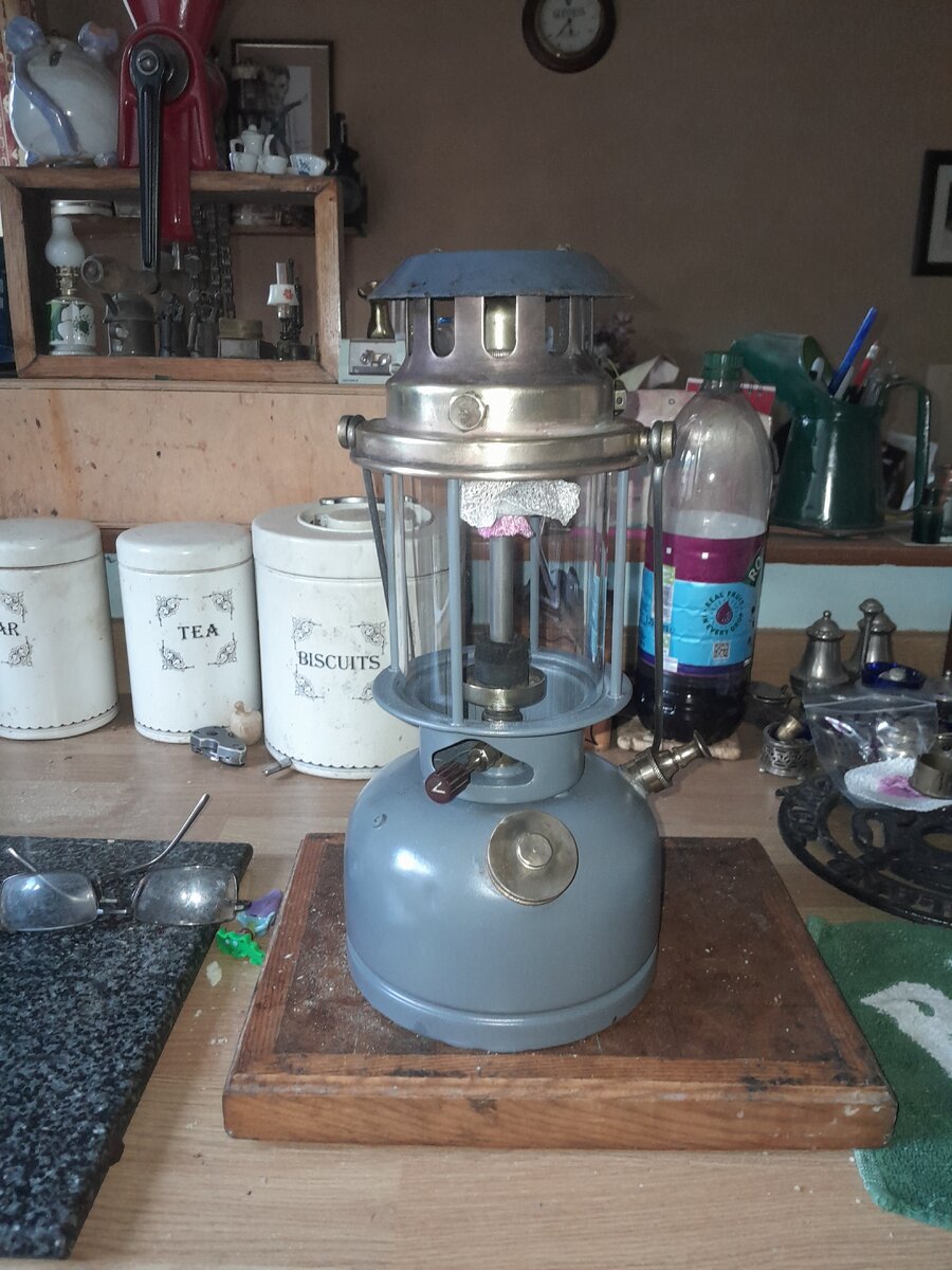

    IT LIVES!!!!!!!!!!!!!!!!!!!!!!!!!!!!!!!!!

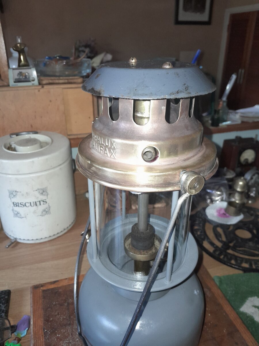

    OK OK badly, but as proof on what is needed, it is alive.

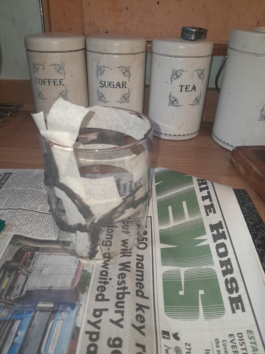

    2 Pack glue to hold glass together.
    New cup washer.
    ITS A FLUFFFFFFFY!!!!!!!!!!!!!!!!!!!!!!!!!!!!!!!!
    A quote from a 5 year old.
    Now I know what spares are needed

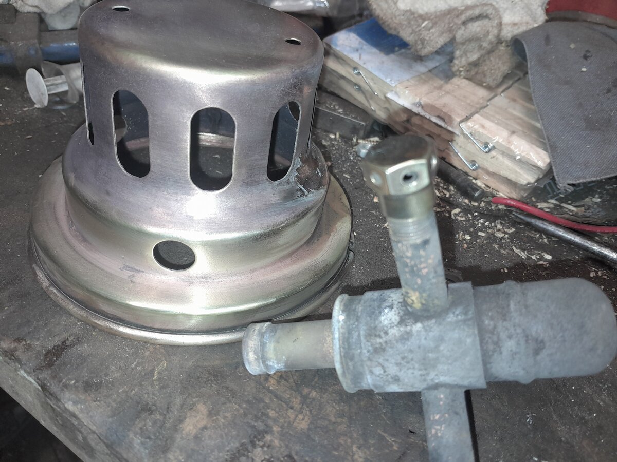

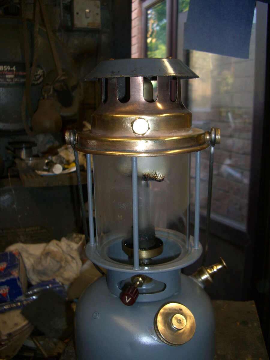

    the rebuild stalled for 5 days, as I was in need of one part, that duly arrived.
    Thanks Mike, good service as normal.
  12. The_Yellow_Ardvark United Kingdom
    Sep 13, 2020
    104
    Wiltshire.

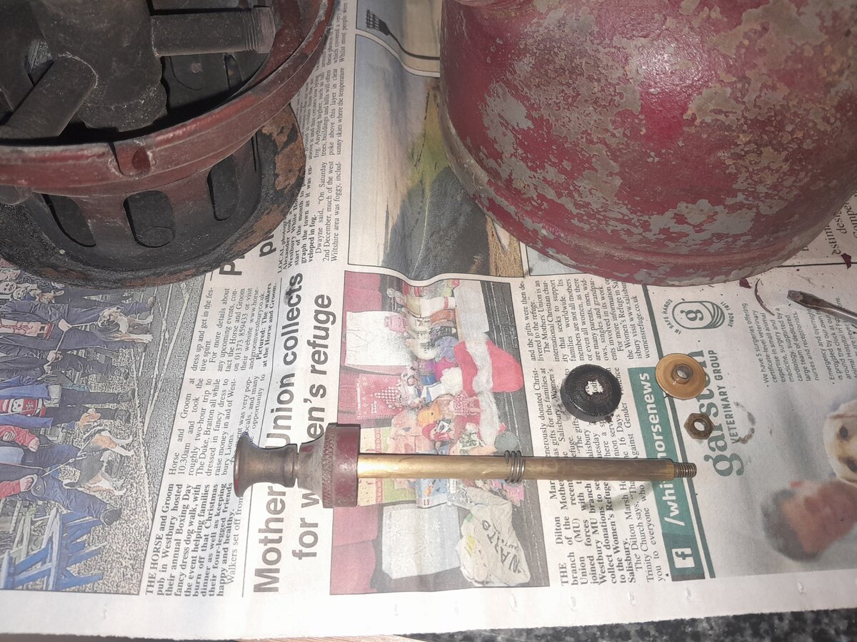

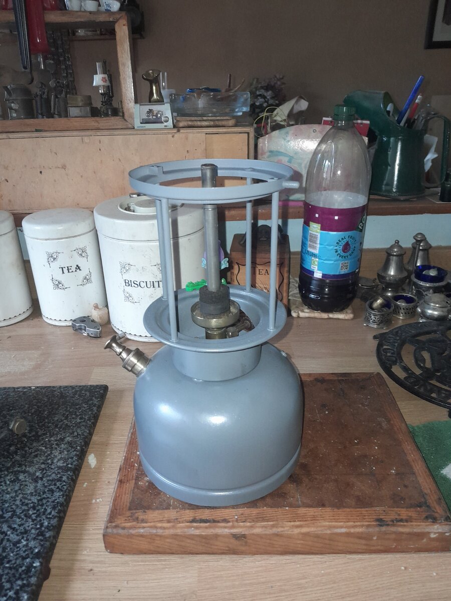

    The part arrived and we set too getting it going.
    New seals, as a matter of course. New Vaporizer, new glass and a lot of buffing on the polishing wheel.
    Part arrived, then so did a call out.
    But I did get some WW2 vintage items from the customers site.

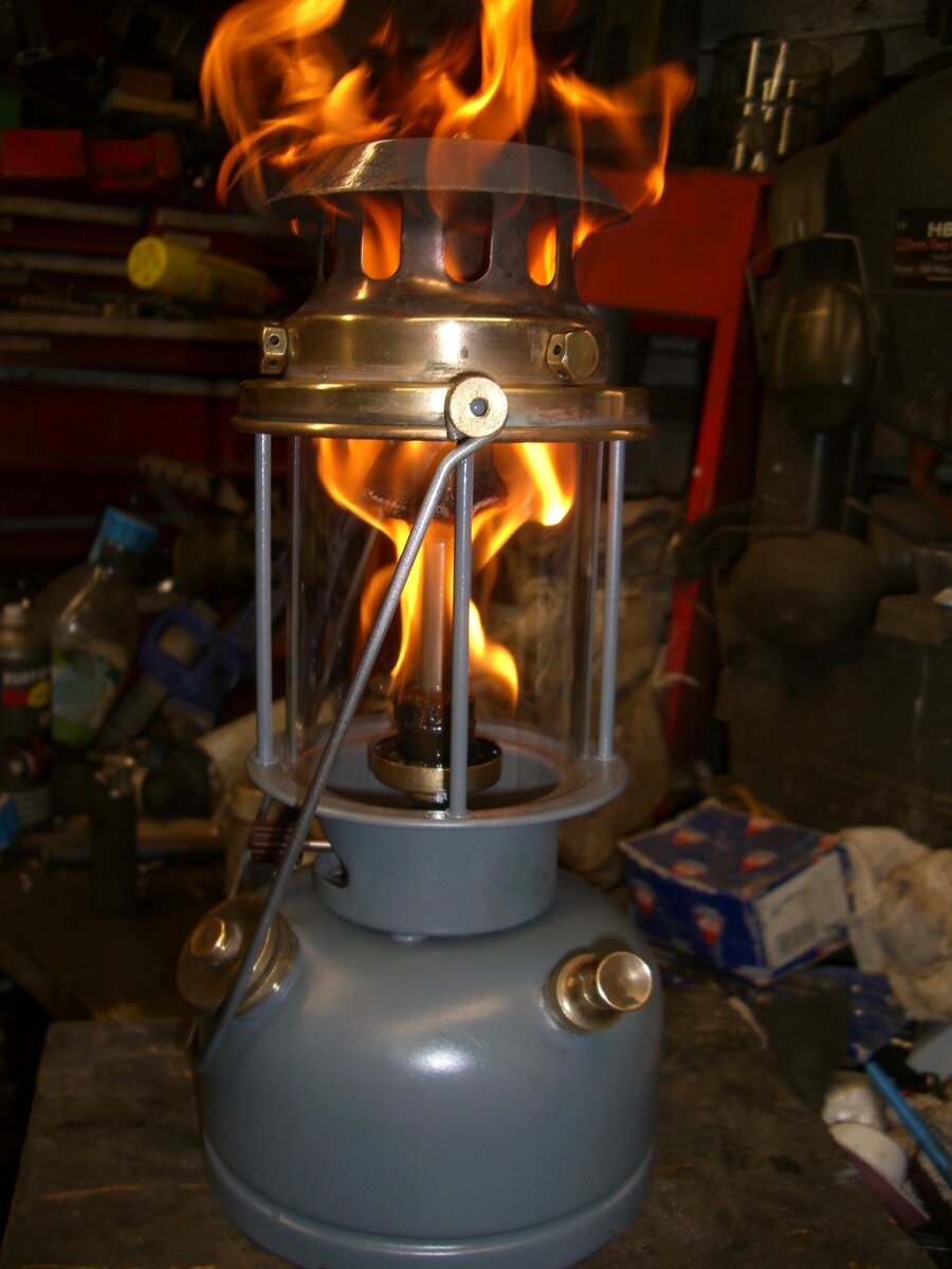

  13. The_Yellow_Ardvark United Kingdom
    Sep 13, 2020
    104
    Wiltshire.

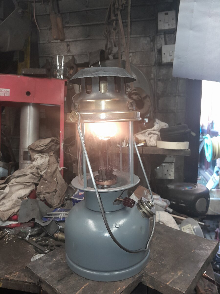

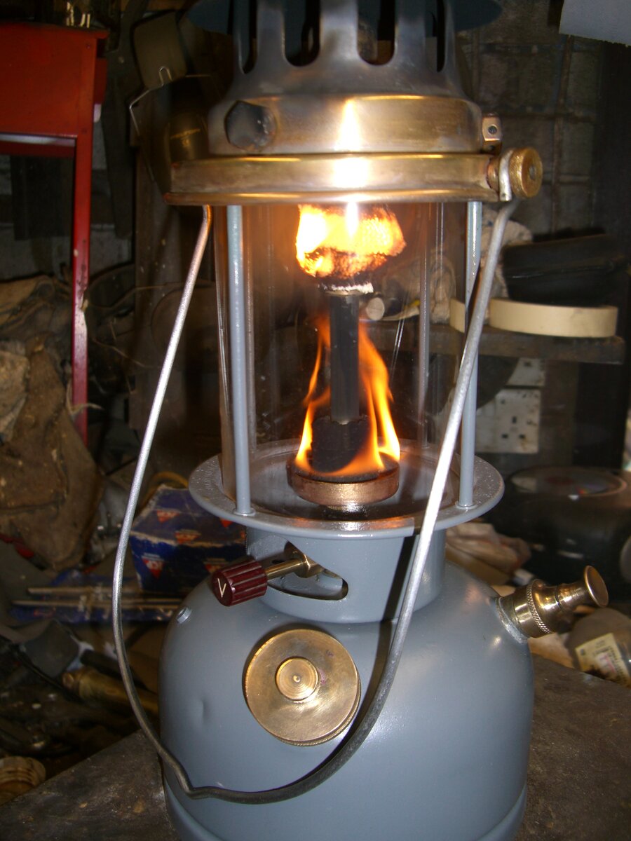

    Nice and early, but the lighting took time as there was a blackbird fighting a worm.
    plus the robin wanted food as well.
    It is alight and the flames are burning nicely.
    decent Meths is needed, not the purple fluid from B&Q.
    Fuel is leaking from the vaporizer, in the off position.
    A single bit of dirt was in the control tap. That removed and we tried again.
    Getting there.
    I even got the pressure indicating nipple to work as well.

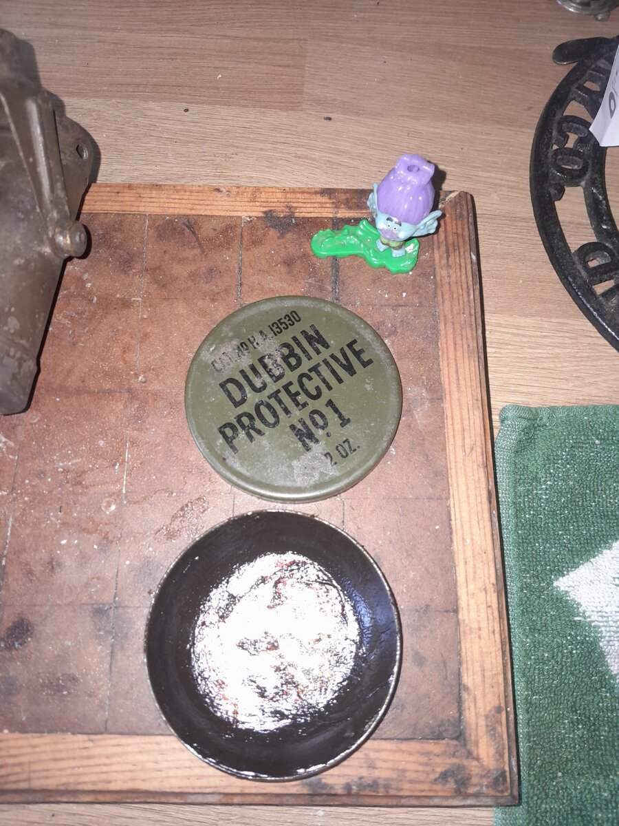

    Oh yes the dubbin tin had some left.

    4,118
    Looking great ! :thumbup:
