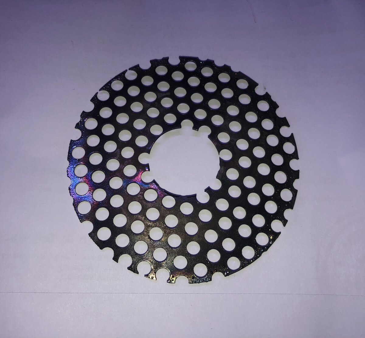

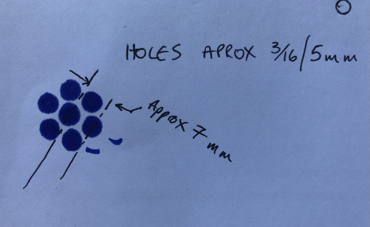

  10. podbros
    4,036
    The measurements without pics are
    3 + 1/4 O/D. (82.5mm)
    approx 1.2 mm thk
    centre hole to match burner dome 1”
    (25mm may be too small)
    the small holes are approx 3/16” dia (5mm) and are approx 7mm apart

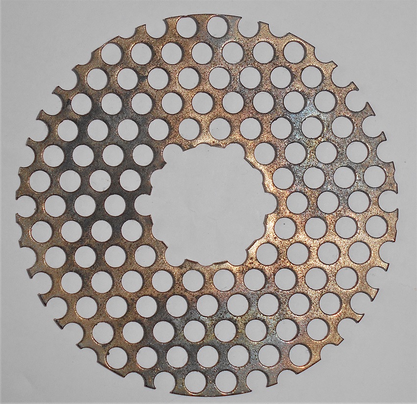

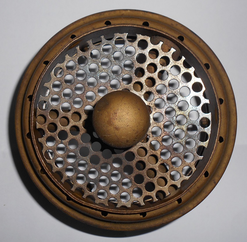

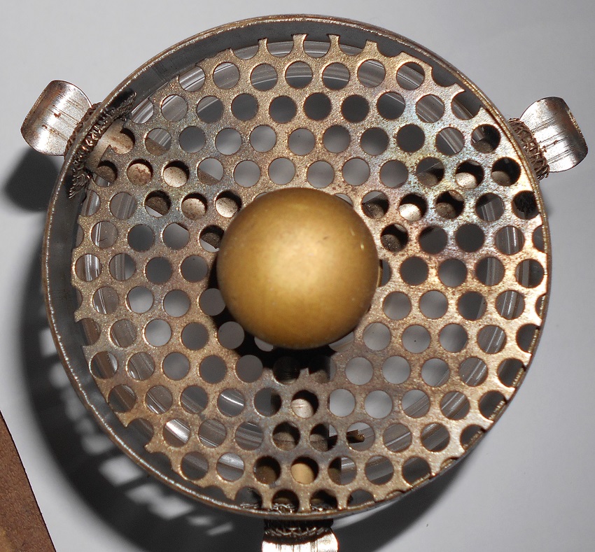

    Here are images of the upper insect screen which came as standard on the TL120A table lamp.
    Equally at home on an earlier gallery
    Stainless steel 0.8mm thick. Outer diameter 82mm. Centre hole for burner mixing tube 25mm. Perforations are 4.63mm diameter at 6.5mm centres.
    Plenty of suppliers on the web for perforated stainless steel sheet if you need a 4M x 2.5M sheet. Though I never looked, I suspect much smaller sizes could be found on eBay. You could also use brass and if you can't find perforated sheet, I don't see why mesh couldn't be used provided the wire was of a suitable thickness and holes of around 4.5 / 5mm
