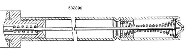

  10. Mackburner
    Here is the patent drawing for this vaporiser. ::Neil::
  11. ateallthepies
    Oct 6, 2012
    238
    Thank you Neil, it makes even more sense now.
    I wonder where the majority of the carbon builds up in these things?
    Steve.
  12. Neighbor Al
    Nov 21, 2011
    1,062
    Russell, PA United States
    Looking at the drawing, couldn't a user unthread the tube from the base and use a wire brush to clean out the body? I'm just say'n...

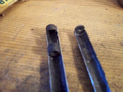

  19. longilily United Kingdom
    Jan 25, 2011
    1,450
    Dungeness
    I sliced open a tilley a few years back now, but managed to find the pic ( Im no David Bailey though ok ) [-(

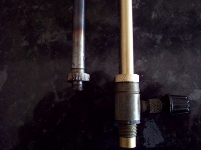

  21. David Shouksmith
    Stu does these conversions and it's all described in a thread on here somewhere. They have the advantage of having a replaceable nipple and thus can be serviced. I don't have one so I've no idea what they're like to use.
    Having said that, both versions of Tilley vapourisers are easily available and they're not likely to be in short supply any time soon - I must have at least a dozen NOS ones lurking around here awaiting use...
  22. longilily United Kingdom
    Jan 25, 2011
    1,450
    Dungeness
    i made one a little while ago, though it was for the pure fun of it
    At the end of the day, it wasn't worth the agro of making them as David quite rightly says, there's an abundance of them around and about
    Drilling the jet was the trickiest bit, got a pic of it working somewhere ](*,)
