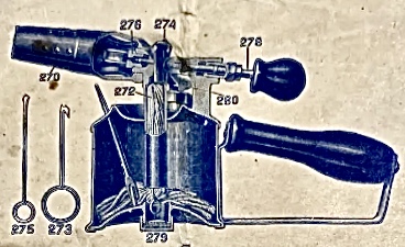

    However I have seen a Benzolene blow lamp for sale, a Vintage Brass Blow Torch British Made Monitor Benzolene No. 43A
    There's no pump so how do these work please?

    No pump, ‘benzoline’ (old name for gasoline without lead or additives), a priming with methylated spirits burnt in the priming cup inset into the top of the fuel tank causes the volatile fuel in the tank to heat up and pressurise the air space above the fuel.
    The fuel to use these days is Coleman fuel or alkylate petrol (Aspen 4) obtainable in the UK from some garden machinery specialist outlets.

    These blowtorches are usually more than 70 years old.The suction wicks are rotten , or there are only remnants left in the intake tube. Then the blowtorch no longer works, because he doesen't have a pump . A new suction wick must be inserted into the suction tube. I use rifle cleaning wicks, a long upwardly bent cotter pin,or a nail for this. The new wick should sit tightly in the tube . Many manufacturers also have a small sieve built into the very end of the intake tube. I also like to use Aspen 4 as fuel.

    Do not hesitate. Buy it regardless of what. Figure out how to make it work later. :lol:
    It doesn't need a pump. Operates like what other members had already described.
    You will certainly need volatile fuels like gasoline, Coleman fuel or equivalents. Don't expect it to work with kerosene.
    The wick is crucial. It helps administer just the right amount of fuel to the jet/nozzle orifice for proper vaporization without flooding it during initial preheat/startups.
    Subsequent heating of the fount or tank after startup and during operation provides some self-pressurization of the air inside it.
    This ensures stronger wicking of the fuel to the point of discharge.
    Use fresh fuel which still contains most of the more volatile components in it.
    Benzoline is no longer available. Modern gasolines might foul-up more quickly. Coleman fuel and light naphtha are cleaner alternatives. Alkylate gasoline is similarly clean burning and purely paraffinic/alkanes without aromatic hydrocarbons. These might be more available in your location too.

    To create new wick, nothing is better than a mop with cotton strands.
