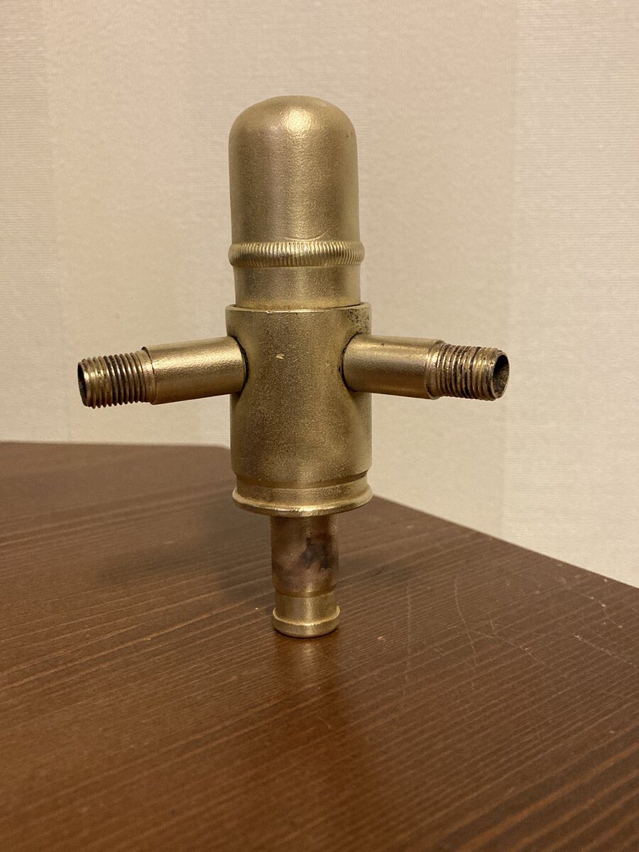

    Here is a Tilley-compatible burner I bought from Tilley Lamps and Stoves not long ago and just recently took into use with a fully restored and tested Guardsman. It started acting up lately so I tried using the hood and burner assembly on other working Tilleys with the result that wherever I used this burner, the performance of the lamp took a dive.
    Today I decided to trash the freshly installed Tilley mantle and clean up the burner to see what’s going on. If my eyes aren’t deceiving me, it looks like the air tubes have begun to sag and the walls of the burner body have crumpled at the air tube inlets. The threaded portion of each air tube is also distorted.
    I’m currently running the Guardsman that previously hosted this burner with a newer X246B burner and it’s working just fine. If I were a betting man I would say that I’ll bet it will continue to work fine with the Tilley burner for the long run, barring any unforeseen other problems with the lamp.
    Did I simply get a dud burner, of is there something specific I should be looking for as far as issues with the lamp that might have caused this to happen?
    That burner does not look good.
    The best test to do now would be to find your best-performing Tilley, put that burner on it, and see if it underperforms.

    Thanks, Tony. I’ve tested this burner on all my Tilleys and it makes every one of them perform terribly. I usually end up aborting the test after a couple minutes when it’s obvious the flames are never going to stay inside the mantle.
    I’ve also tried using the hood and burner of my best-performing Tilley on the lamp the Juliands burner came from and that combination works beautifully.
    In that case, it is a dud for some reason.

    It wasn't made like that. It has over heated and deformed under the weight of the hood. Possibly it was burning up in the dome at some point?

    I had indeed read your post(s) in that thread yesterday. Out of curiosity, was that also a Juliands burner? It sure looks like one with that hyper-elongated dome. Maybe that’s the problem? People talk these up because they weigh significantly more than Tilley burners, but perhaps more burner = more heat = more failures like this.
    Jeff, I hear you about the scrap parts, but by the look of things all I could reliably salvage would be three nuts and a spigot. Pretty expensive for little bits and bobs. I’m guessing I paid around 40€ for this with shipping and customs fees.
  9. JEFF JOHNSON
    16,897
    The burner dome looks okay and the mixing tube which is located inside the dome may be okay and I would remove the air pipes and check them.

    I wouldn’t use the air pipes anymore even if I could remove them, which I can’t. The threaded section of the outer end of each tube is canted upwards.
    I agree the dome looks OK, but I don’t feel like I could trust it since that’s probably where the problem occurred. Also, I can’t remove it by hand, nor the spigot. I won’t put a wrench to either of these parts or clamp any part of the burner in a vice. I lost an otherwise good burner that way not long ago, even when not using much force and taking care to wrap the surfaces in protective material.

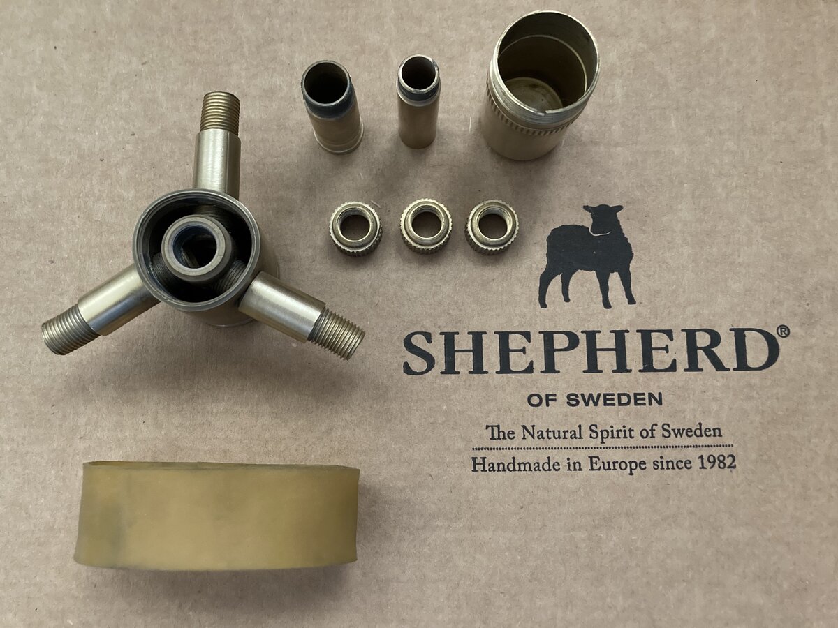

  11. Jaska
    Oct 2, 2022
    232
    Finland
    I have now managed, somehow, to disassemble everything that can be disassembled by hand, with the help of a giant rubber band folded and wrapped/stretched around the various appendages after soaking in scalding hot water.
    Check out how distorted the body of the burner is! I wasn’t able to remove any of the air tubes as I think they’ve become misshapen as have the mating holes in the wall of the burner.
    In the second picture, zoom in and observe how there’s a chunk of metal missing from the end of the threaded tube. There also appears to be a stress crack extending from that further down the tube. To me, that looks like shoddy quality and workmanship. Remember, this burner has not been used more than a few hours total (not possibly more than 15-20) and I’ve disassembled it exactly once, by hand.

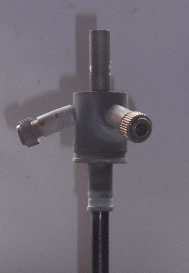

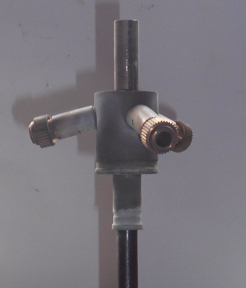

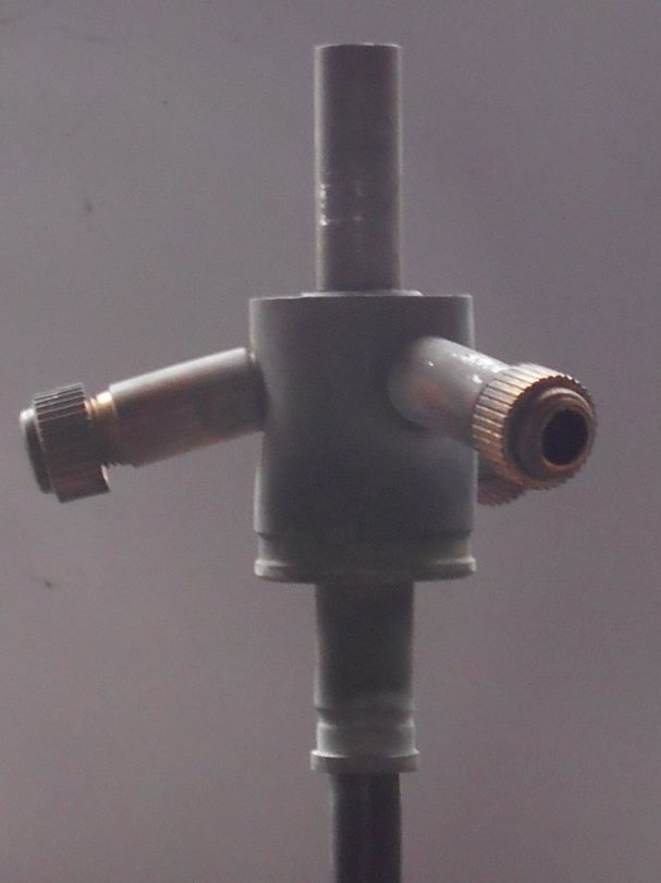

  23. Henry Plews
    3,068
    @Jaska yes, I'd use that burner.

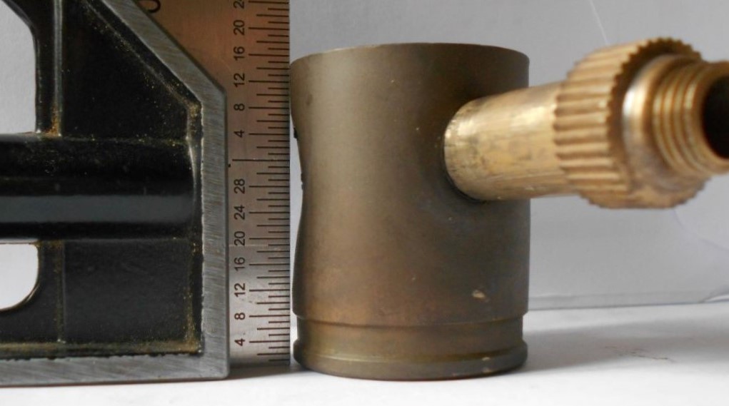

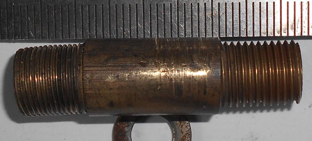

    The following images are of the burner from my Tilley TL136 after aproximately 100 hours burn time. I bought it from an eBay seller - NOT Juliands but it is very similar to those sold by him. This burner DID NOT have underburn !
    The deformed burner body.
    An example of how the air tube threads have bent at the burner end.
  24. Tony Press

  25. Jaska
    Oct 2, 2022
    232
    Finland
    @Henry Plews Thank you for posting those detailed photos. That looks exactly like what’s happened to my burner.
    I’m now burning in a new mantle, which I also happen to have bought from Juliands, on my trustiest Tilley with the freshly cleaned and reinstalled Tilley burner I pictured earlier. Good stuff, I say! These mantles have been kind of hit or miss with my lamps, but this one seems to like them.

    @Henry Plews Wow that's the worst burner I've ever seen.
    Do you have any ideas why this happened?
  27. JEFF JOHNSON
    16,897
    In my opinion, the brass which those burners are made from is not up to the task.
  28. Henry Plews
    3,068
    I agree with @JEFF JOHNSON , the brass just isn't up to the job.
