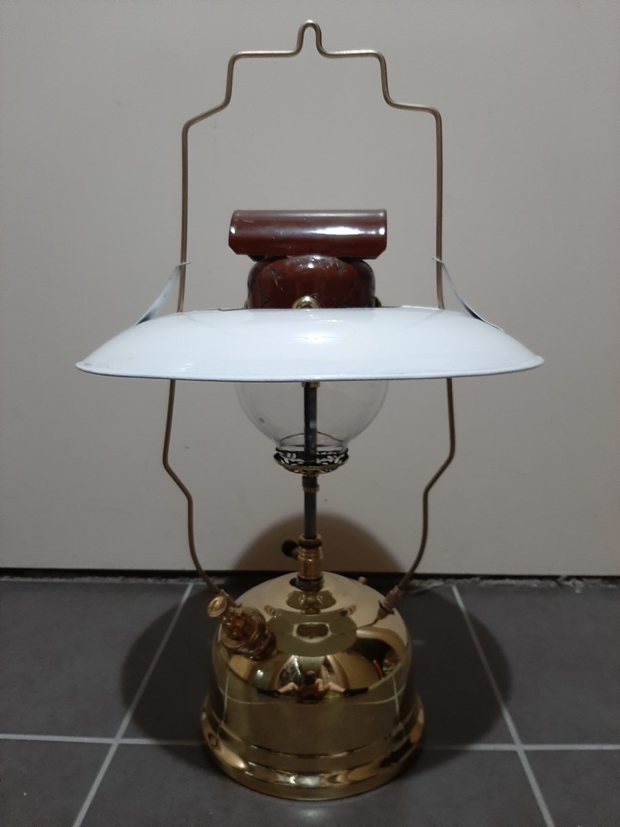

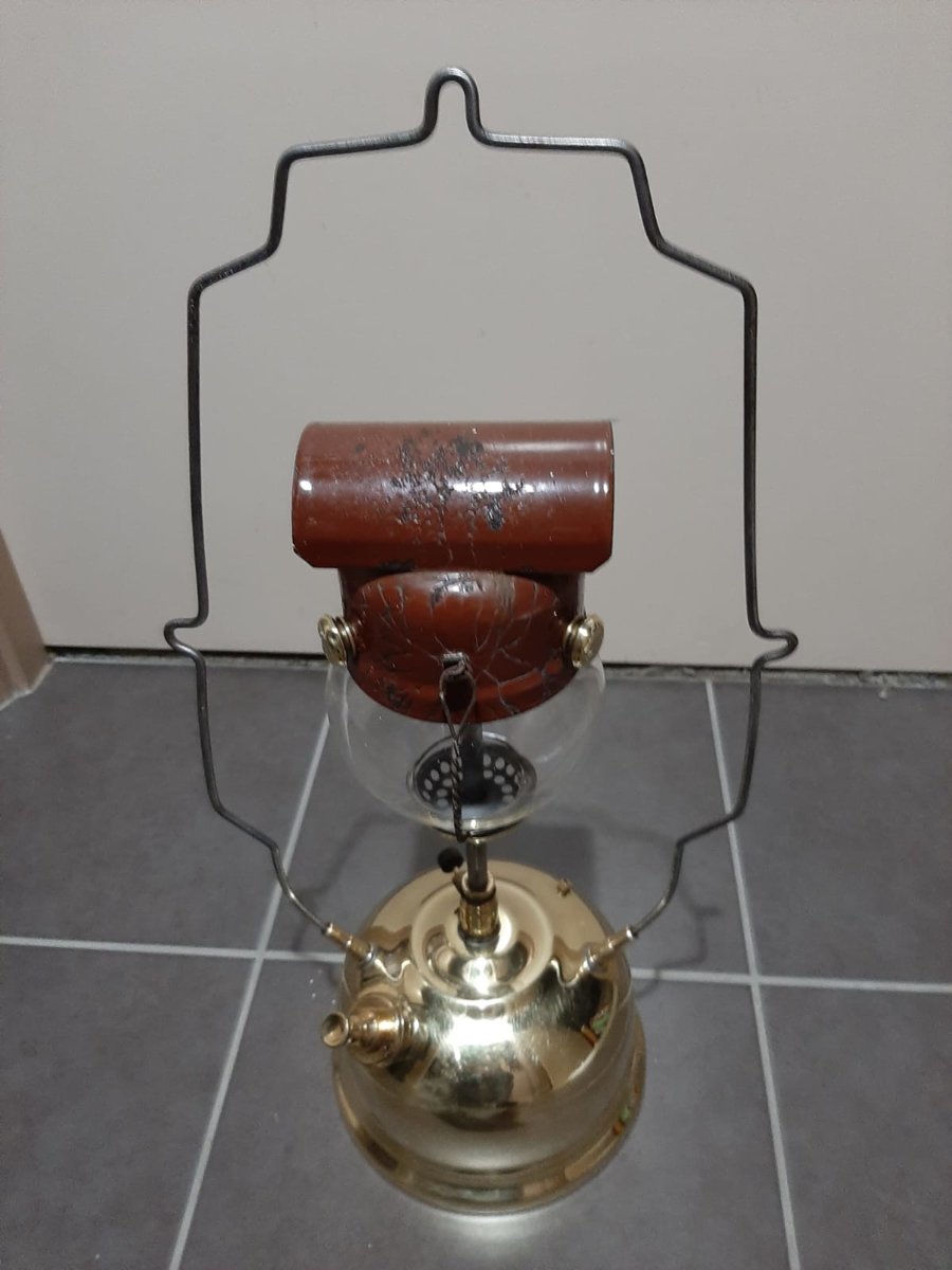

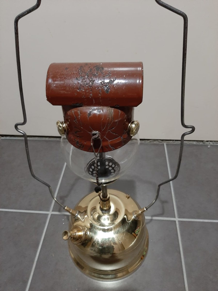

    Hello am i right? if so what years did they make them can someone tell me thanks EX100 hanging lamp 1.jpg EX100 hanging lamp 2.jpg EX100 hanging lamp 3.jpg EX100 hanging lamp 4.jpg

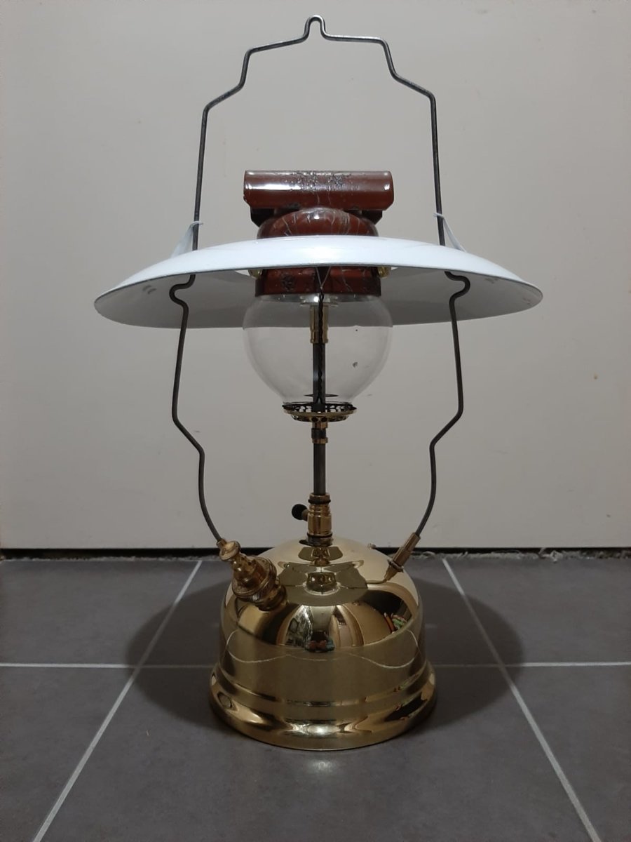

  4. Buggerlugs
    and it works well new seal can't go wrong EX100 second adition hanging lamp 1.jpg
  5. ROBBO55
    4,453
    @Buggerlugs
    Yes, I would say EX 100
    But I believe the lower bug screen is Kayen
  6. Buggerlugs
    what should the lower bug screen look like? do you have a photo thanks
  7. Henry Plews
    3,073
    Production years from 1939/40 to 1946

    Hi nice set of lamp you have.
    This forum also has a question possibility maybe
    a steep learning curve but it gives a lot of information ;-)

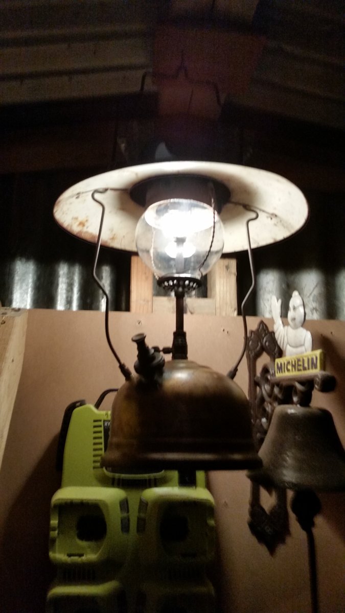

  9. ROBBO55
    4,453
    The bug screen is the same as the one on your table lamp.
    Tilley lamp?
