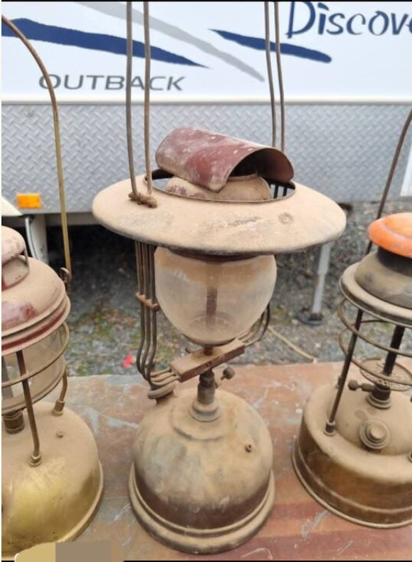

Is this lantern cobbled up?

    Any ideas. Thought it might be a cobbled together. First time posting so not to sure.

    The hanging frame and reflector aren’t Tilley bits but the rest of it seems genuine.

    the tank may have been adapted from a table lamp ?

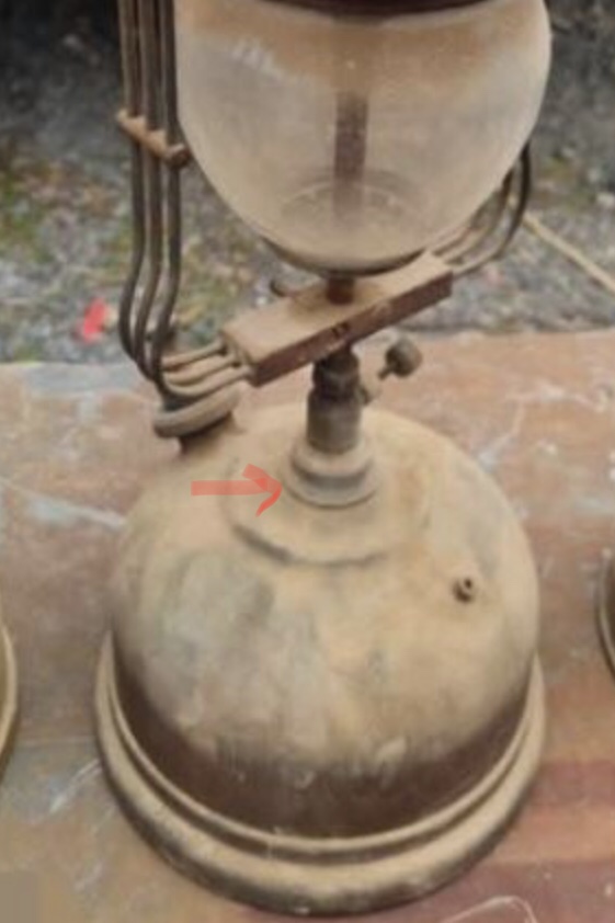

    Is the arrowed part the remnant of the column??

    The tank is a Tilley table lamp. The hood and glass is from a Tilley lantern (EX4/100/similar). The lower insect screen is Tilley and appears to be being used to hold the glass in place. The reflector and bail are not Tilley.
