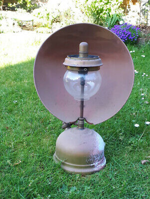

    I read in Jim Dick book that a R1 conversion lamp which had a table lamp gallery style was released in America.
    Does anyone know if this is how it would have looked?
    Or did it have the latter R1 Fount?
    Any help would be much appreciated as I know there are alot of people that have so much information on this forum, which might be able to answer this question thanks.

    I have seen three of them, they all had the later style tank; but it looks good with the early tank also.
