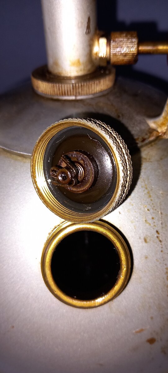

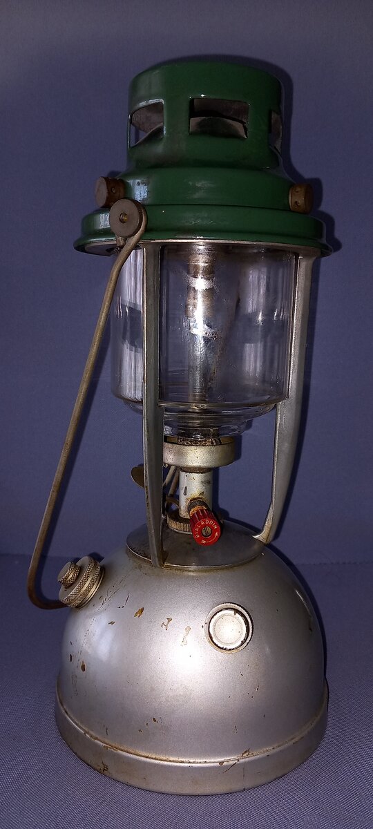

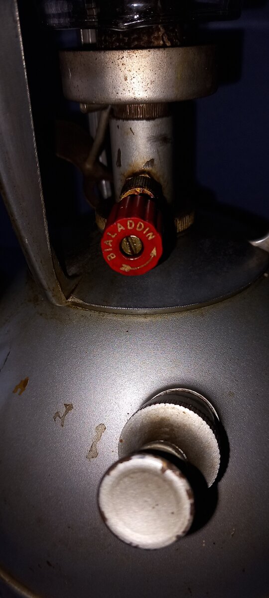

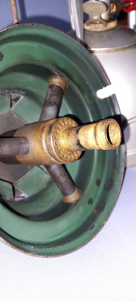

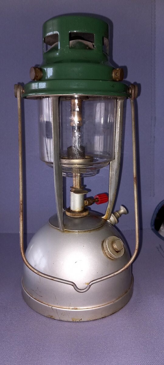

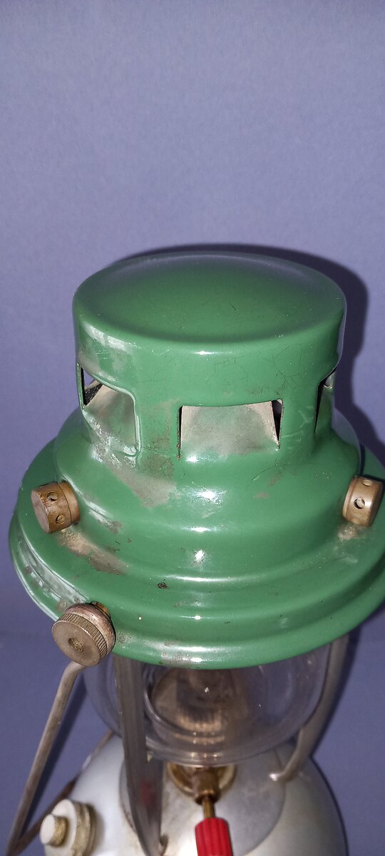

    By chance I came into possession of a Bialaddin (Vapalux?) 320 in excellent condition.

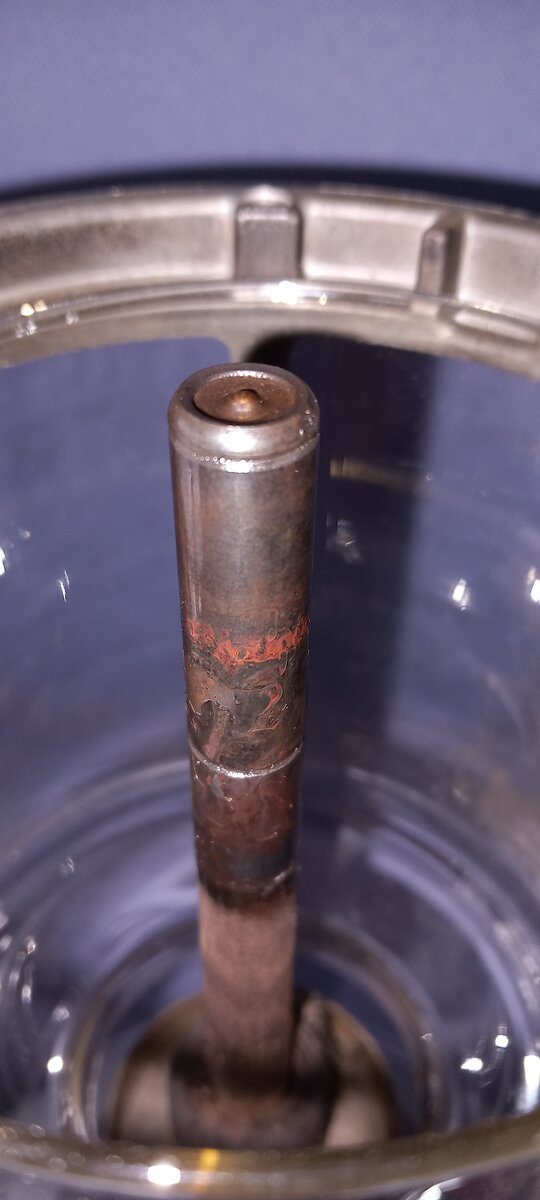

    It is my first British-made lamp; a lamp that I have never looked favorably on especially due to the near impossibility of finding spare parts, but now that I have it in front of me I must admit that the construction is well made overall. Not being very familiar with this type of lamp I don't know where to start: whether to dismantle it for a quick clean or try to light it for the first time straight away. I would like to know more about how to proceed. For example, are the mantles for gas lamps (the ones with two holes) ok? I read on the forum that these lamps are now made in Korea (?) but I think mine is an original English one but I don't know the year of manufacture.
    What suggestions can you give me? Where can I possibly get spare parts if I need them?

    I always change all the seals now just to eliminate niggles later when fettling but as they may be harder to come by near you just do a bubble check/dunk test under pressure/no fuel and see what you have?
    regards,
    pb

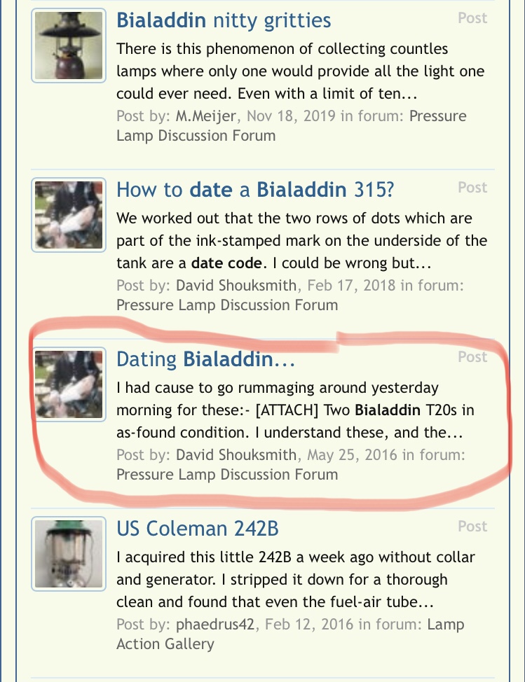

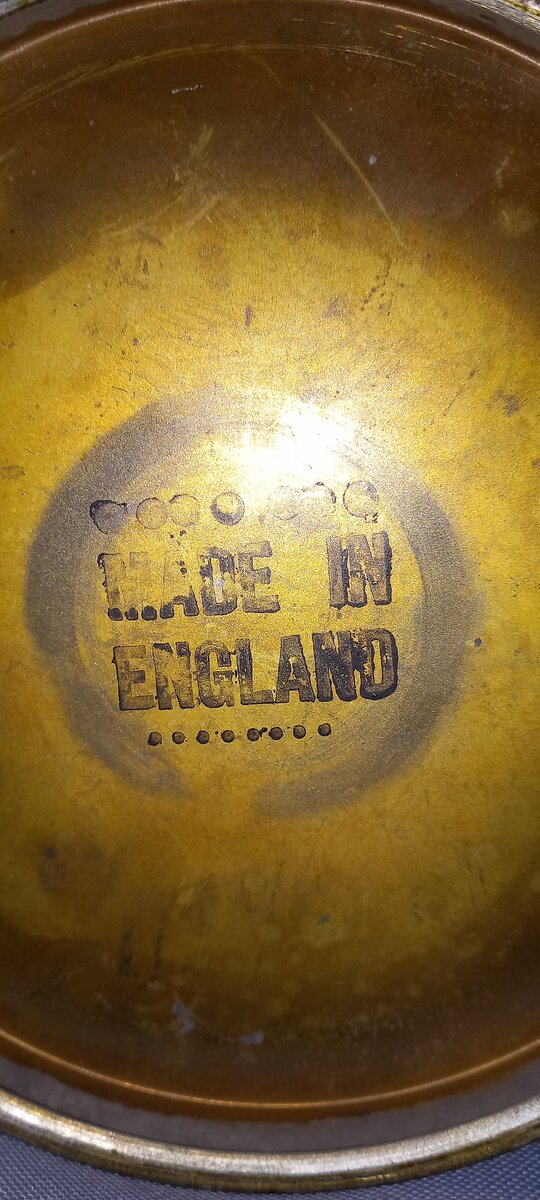

    the dots under the tank are a date code :thumbup:
    Do a search for ‘Bialaddin date code’
    and scroll down, it’s the 7th thread and it’s called ‘Dating bialaddin’ should confirm your lamp is 8th month of ‘67

    Hi, damn dated 1967, I would not have imagined it (I thought it was from the early 80s for the excellent conditions) and above all thanks for your tip.
    I will do as you suggested, I only have a doubt about the mantle (which type to use). I will post the ignition here with a photo.
