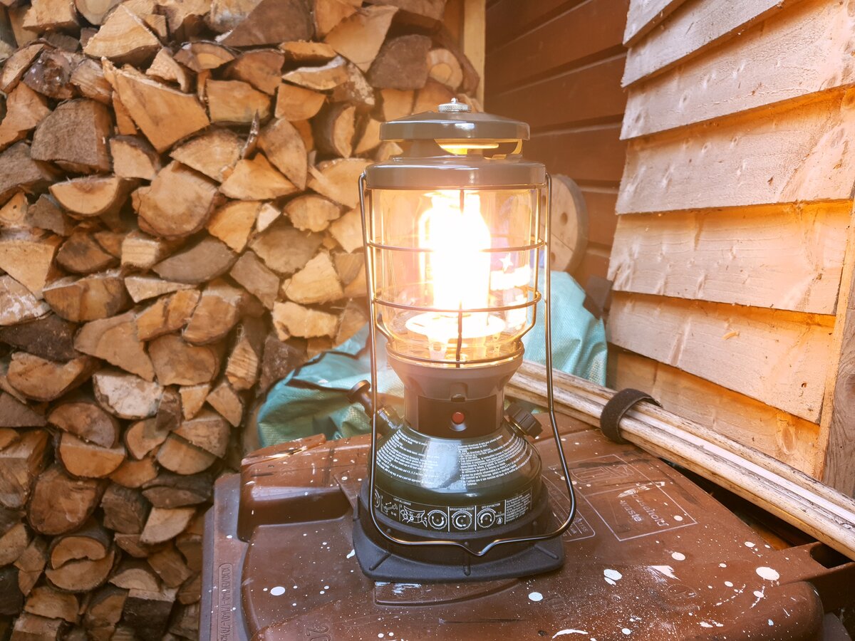

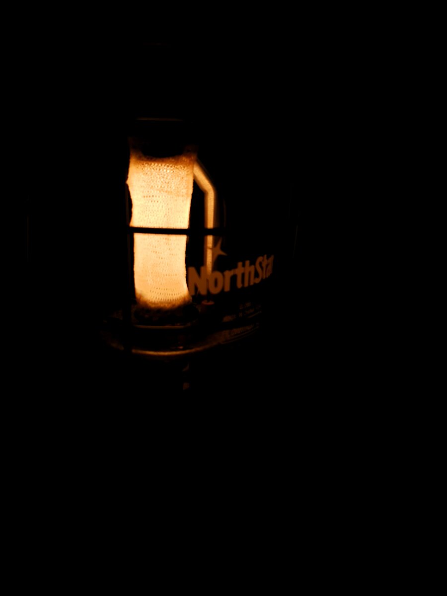

    Put a few drops of light sewing machine oil into the pump about 550 ml of Holts brake cleaner into the tank then pumped up 30 times, opened the valve about half way and pressed the ignitor button and waited, some 15 seconds later....
    A couple of small flares whilst starting, to be expected, slightly bigger flare and it lit, nothing worrying at all and no hair singeing mushroom cloud fireball.
    Just letting it burn to complete the mantle burn in.
    Its louder than my Petromax lanterns!.
    Pictures coming up.
  22. chocki United Kingdom
    Mar 19, 2022
    138
    Wolverhampton, UK
    In my wood store as its really windy today.
    Stopped down to check the mantle.
    Nice even light along the length.
    That warm glow is about right for the colour, camera set to 5500k and yes the lamp is more of a warm white rather than a daylight white, which on an evening should be nice and relaxing.
    Cant wait to light it up later when it gets dark.

  23. MYN
    Looks good:thumbup:
  24. Mr cod
    Mr cod Subscriber
    Jan 21, 2018
    547
    Aylsham norfolk
    Looks like it's doing exactly what it should do.
