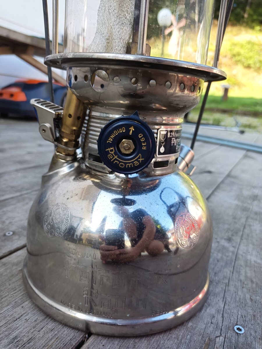

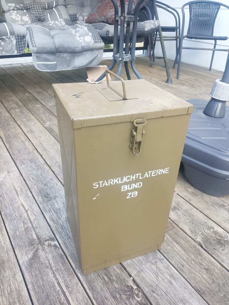

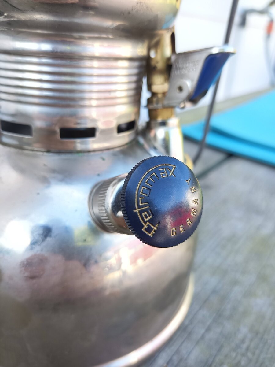

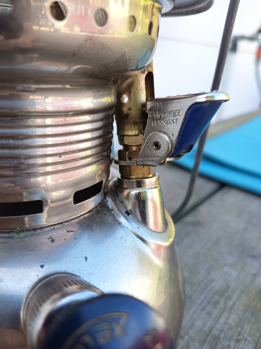

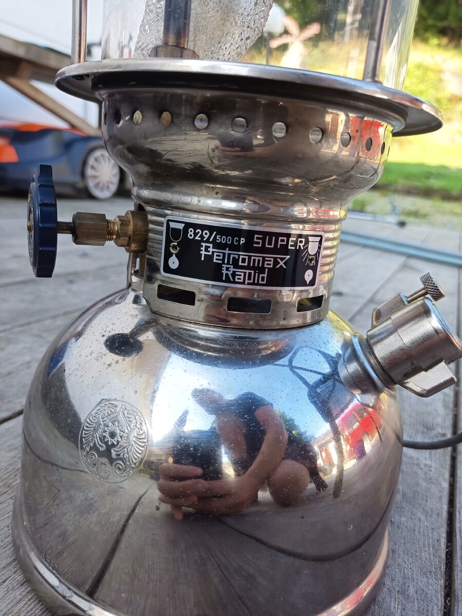

    Pics of it. Ok so its from 85. Perhaps its not the original lantern for this box? I got some kerosene now, do I dare to light it? Or should I get the preheating tray first for a more gentle start? Or could I improvise with something? I'd like to see some light :mrgreen:

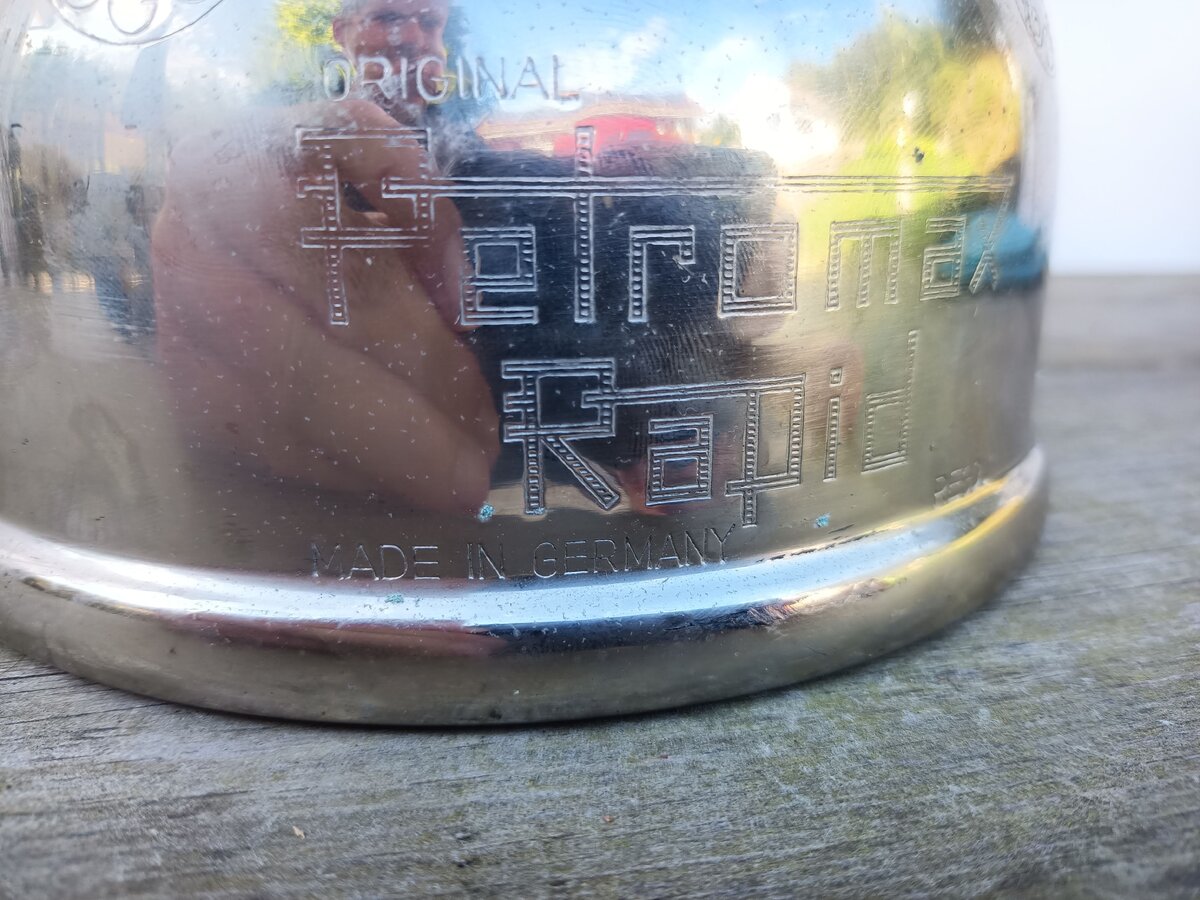

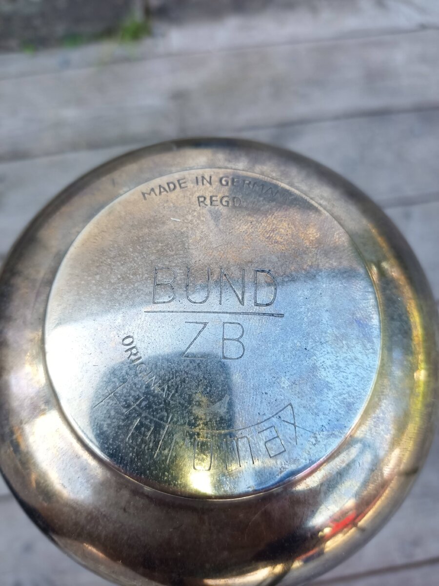

    Why is a lantern that is made in Portugal stamped with "Made in Germany" on the tank and also on the top vent, together with "Bund ZB"? It aslo says original Germany on the manomenter and pump handle. It also says "REGD" what ever that means. On the riveted type plate it says "829/500CP SUPER Petromax Rapid"

    Then you misread the number.
    I would like to see a photo of the4-digit number, please.

    Other than the box, it does not appear specifically military. The lantern in the picture itself appears to me like a regular Petromax 829, not the 829B. If it comes with a looped vaporizer, then it should work like the usual kerosene-fueled Petromax. A close-up photo of the vaporizer would confirm that. If it isn't meant for gasoline/benzin like some military lanterns, it would be advisable to avoid fueling it with such a highly volatile one. (Although I have personally did so...deliberately :twisted::mrgreen:. Well, it does work perfectly with petrol, provided every seal and all features are flawless. Otherwise, things might go catastrophically wrong and lead to some great regrets).
    The pricker control wheel and pump knob are still blue in colour, which indicate more recent manufacture. Most earlier ones from the 1950s or 60s would have turned brown from exposure to light and atmosphere. The blue colouring from the originals would darken in such a way. These are not to be mistaken from the currently produced ones from China, which, are somewhat a slight bit brighter blue and would not darken like the originals to brown, no matter how long they've been exposed.
    REGD means 'Registered'.
    The first thing you should be checking once you finished going through the instructions and guides is to ensure it isn't leaking. You could oil up the leather pump cup/diaphragm and test whether you can pressurise the fount with the pump. Test it both with and without fuel. You need not be in a hurry to light it up with the mantle. The last thing you'd want is having to strip it down again due to a nuisance leak somewhere during showtime :).

    This is a German Petromax for Civil defense.ZB = Ziviler Bevölkerungsschutz .
    They always had a shiny nickel plating .They were never used and stored in metal cases,which is why the blue color is so well preserved. @Malmen probably read 3158 instead of 3153 .
    3153 = week 31 ,year 1965, Wednesday

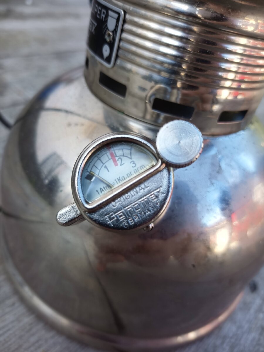

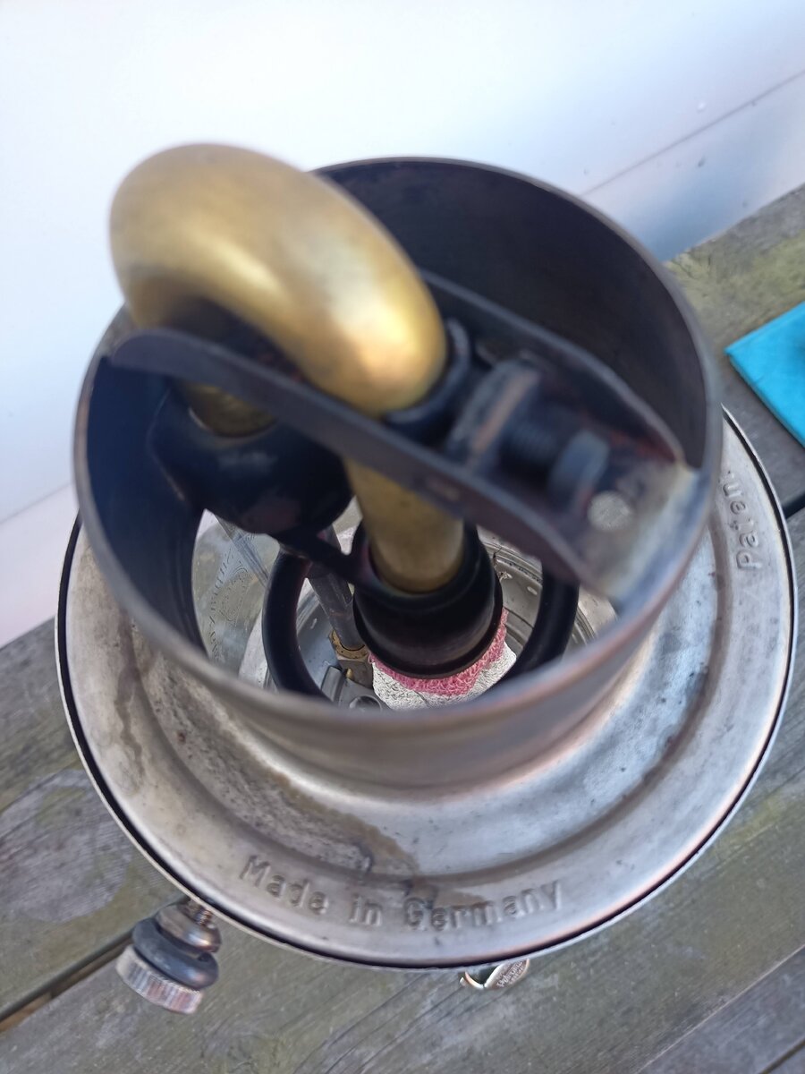

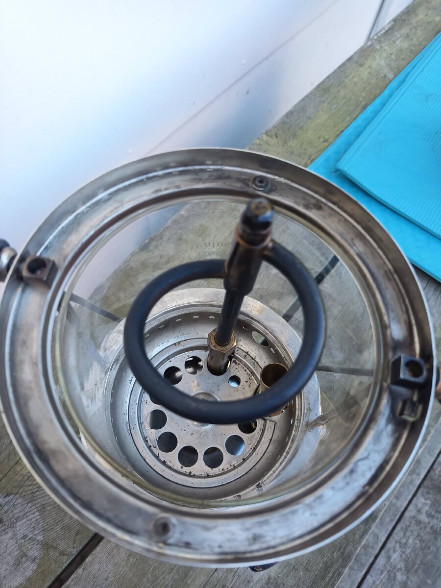

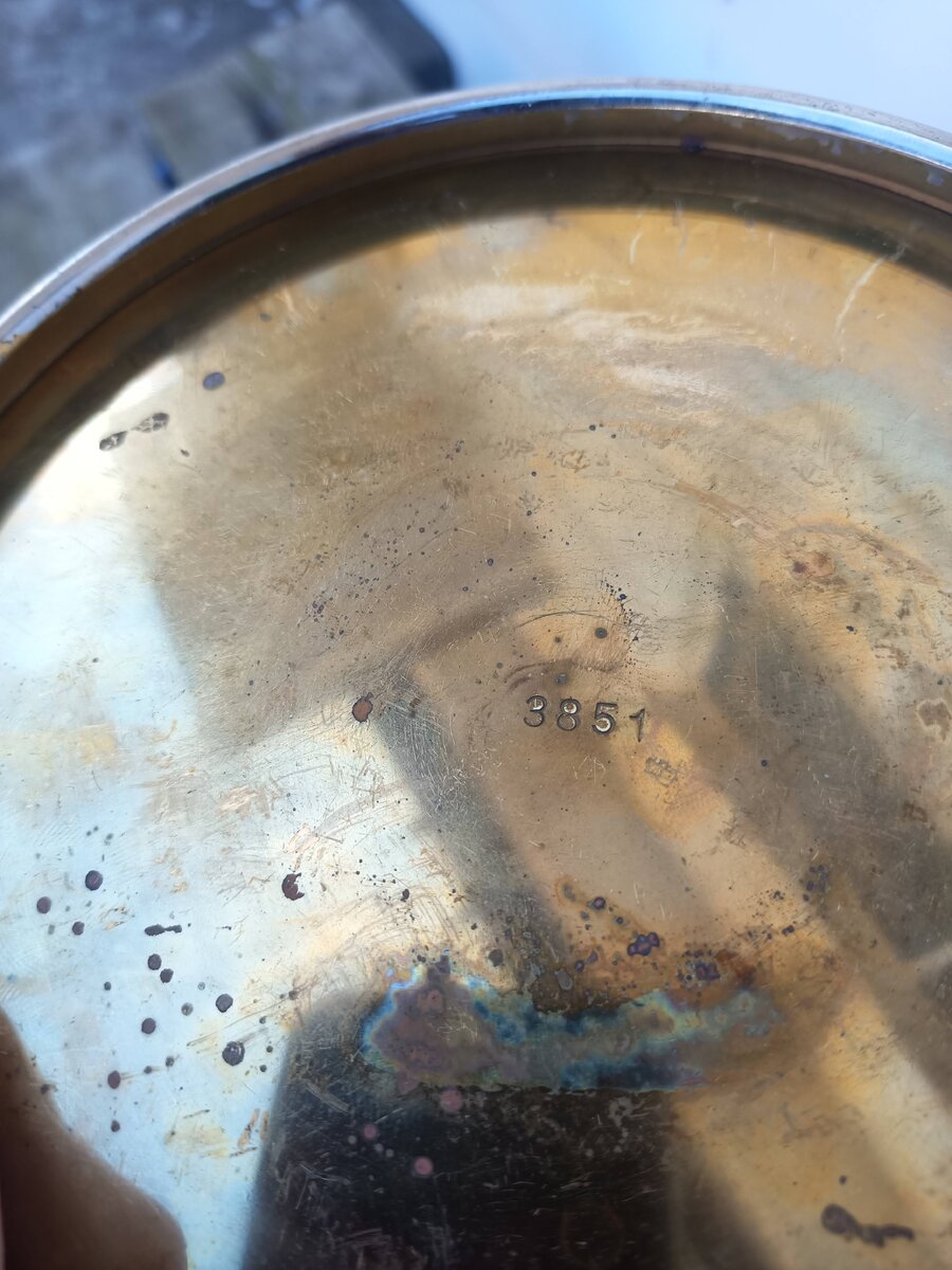

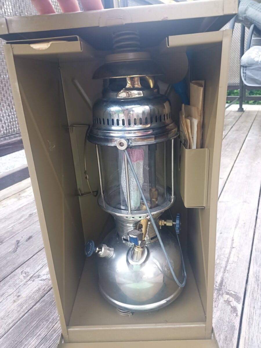

    IMG_20250801_093129.jpg IMG_20250801_093811.jpg IMG_20250801_093628.jpg IMG_20250801_093533.jpg IMG_20250801_093457.jpg IMG_20250801_093449.jpg IMG_20250801_093415.jpg IMG_20250801_093314.jpg IMG_20250801_093256.jpg IMG_20250801_093224.jpg
    Thank you so much for all the info! Here are some more pics. I remembered the numbers all wrong! It is 3851!

  14. MYN
    That's certainly original German-made. Stamped date codes mean 1960s and later. Looped vaporizer would suggest kero operation. Once you've removed it from the box for use, the blue plastic parts would eventually darken deeper towards brown. It won't be anything different from a regular 829, 500cp except for the additional 'BUND ZB' stamping on the top cap.
    You might not necessarily need the spirit dish for gentle start. Just ensure that the rapid preheater torch isn't leaking anywhere and working as it should first if you decide to light it without the alcohol slow start. You can always supplement it with a dish later.

    You've truly acquired a fantastic Petromax Rapid with its original storage box :thumbup::thumbup:
    I congratulate you and wish you continued success .

  17. bp4willi
    1,156
    3851 =
    Week 38
    Year 5 in 60ties = 1965
    Day 1 of workweek= monday

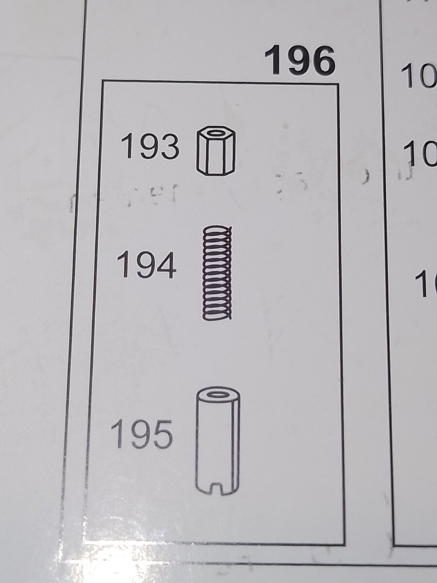

    You need to install a new valve seal # 193 at the very bottom of the carburetor.

    Thank you! I just ordered some parts from Petromax.de but this seal is of course the only one you can't order! I got the lead seals and a leather seal for the pump and a alcohol tray and some other things. Is there anyone here that I can buy this #193 part from? Or can I make my own seal with an o-ring or something? I have lots of o-rings in small sizes.

    During startup, either with spirit or the rapid preheater, there should not be any fuel inside the vaporiser/carburrettor. Otherwise, the heating would cause semi-vaporised fuel to spew out from the jet/nozzle and burn with yellow flames. The protruding needle won't shut off the fuel. It is not meant for shut off.
    The footvalve or fuel pickup tube assembly in the lower part of the vaporizer located inside the fount is obviously leaky.
    It is not surprising to find at least a seal or two that do not function properly for something that was made 65 years ago. Part 193 can be purchased as it is available from the above site. Or you could fashion out the pip part from fuel-resistant Viton sheet or cork. There is a central protrusion of metal/brass serving to protect the rubber from direct contact with the foot valve actuation rod. It makes the pip(homemade) replacement slightly more difficult and fiddly. You'd need to make a centre hole on the punched-out rubber or cork pip so that it could be fitted into the part 193's cup.
