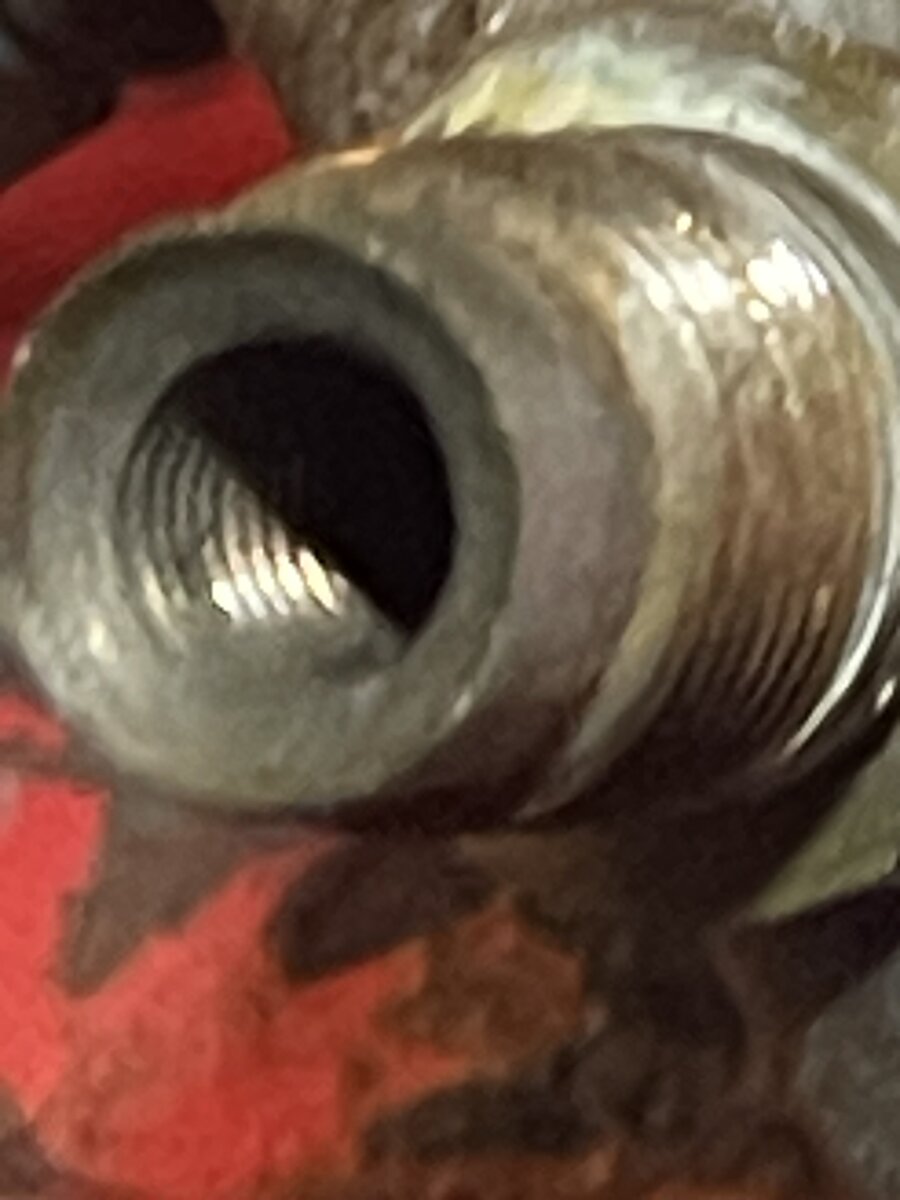

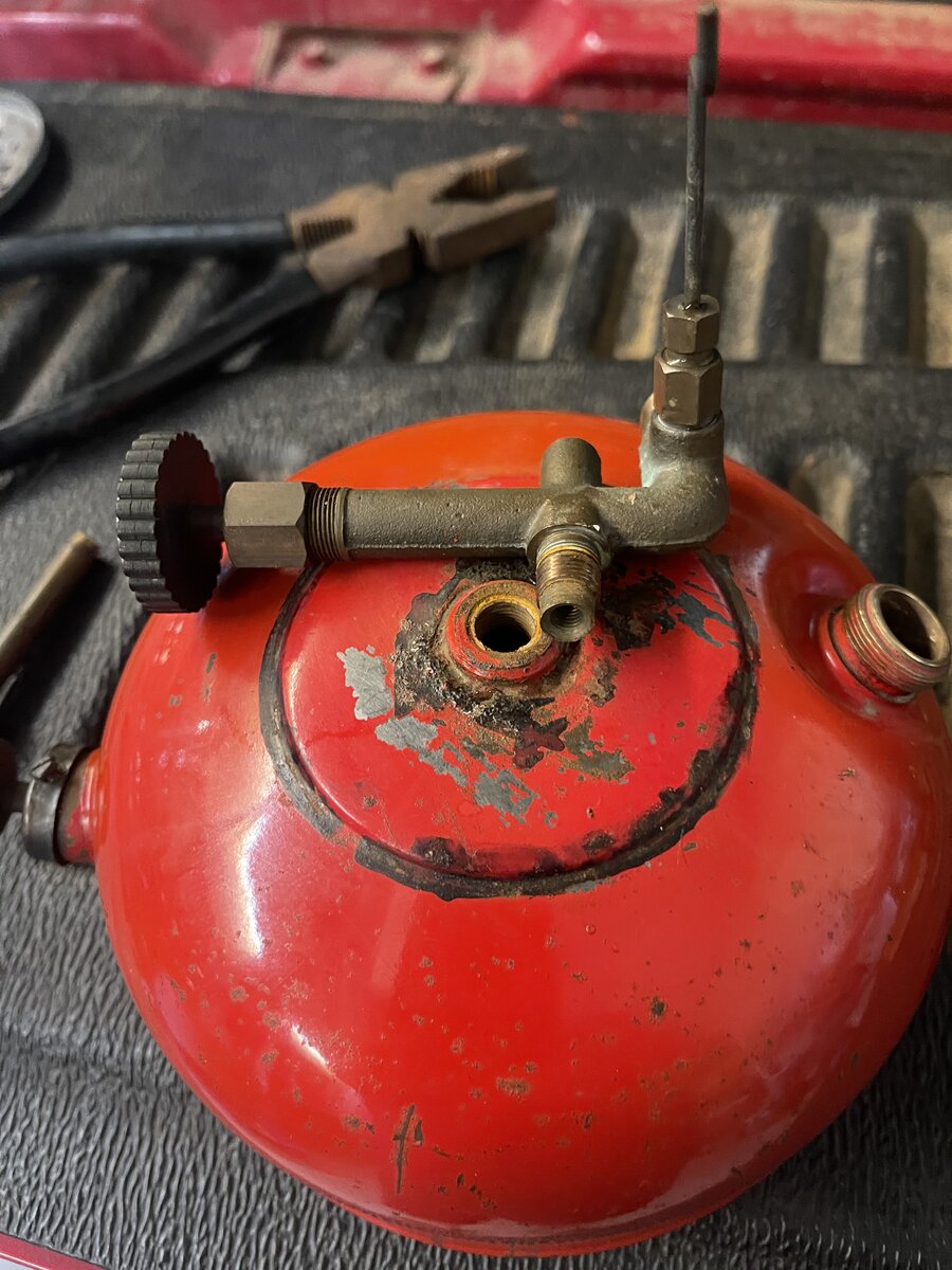

    Hi fellas, I have this Kamplite, it wasn’t running right, I did the usual checks but still not right . So I’ve dismantled it down to find I have no fuel pick up tube it gone,
    Can any Kamplite fella please enlighten me on any spares or alternatives. IMG_1866.jpeg IMG_1865.jpeg IMG_1864.jpeg IMG_1863.jpeg IMG_1862.jpeg

    @Sellig33 is correct in stating you can make your own pickup tube, but the preheater side of the lantern won't work.
    You will have to preheat the vaporizer. A preheater cup is pretty easy to make.
