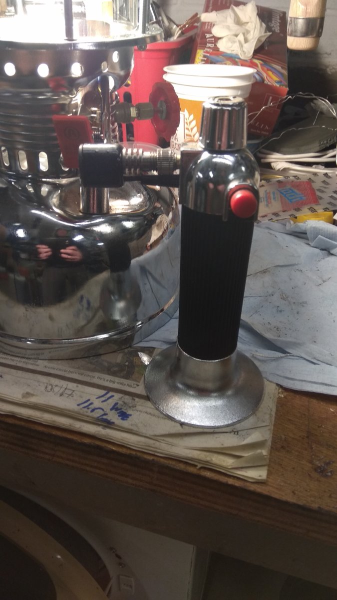

    Soft start, unless it's the sea anchor when it's the awesome noise of the quick heat blaster! I've had no success getting the blaster lit with a match but with the mini cooking blowtorch (stolen from the kitchen) it lights great every time.
