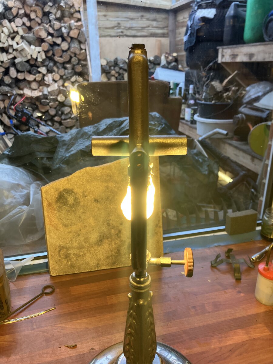

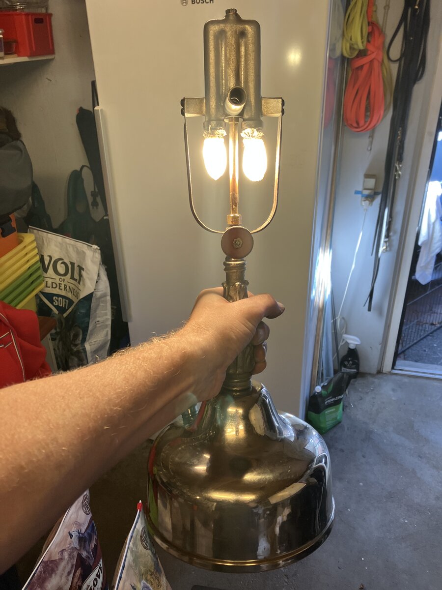

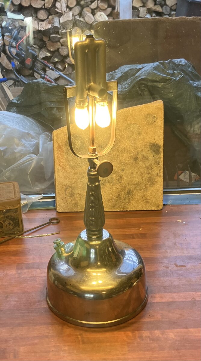

    Thanks to @Mackburner - I know now that this is a Kerosafe - no pricker= made between 1915-1920.
    Pics are from my shed during first take-off.
    The handle is Cast Iron and heavy.
    I use a standard Coleman pump, which fits fine.
    8E2E4C46-262F-4161-9699-745962E0C1D3.jpeg AE95D8D4-2CF6-470B-B794-1FC770F044F2.jpeg 27A5F213-8549-4B83-9205-05EF2BE6881B.jpeg 724BAD44-91FF-470A-AADA-83285B6DBB1E.jpeg 2E9C2A3D-35DB-4078-8F15-3099151275B0.jpeg 89961CDB-ECF4-4CB4-9AE8-7AE966FEC918.jpeg 9F1E72C6-9CA2-4073-9610-81FBD3E2DC58.jpeg 7998619B-291A-43E9-847E-4A6B3464E205.jpeg 43AF9B63-3BE6-4BAA-8161-57187F62111B.jpeg 2B2CE726-9636-4CBF-B5D2-AD1A0D9635A2.jpeg AE9CD4D0-8E92-4D30-A67F-E5C22BAACCCF.jpeg

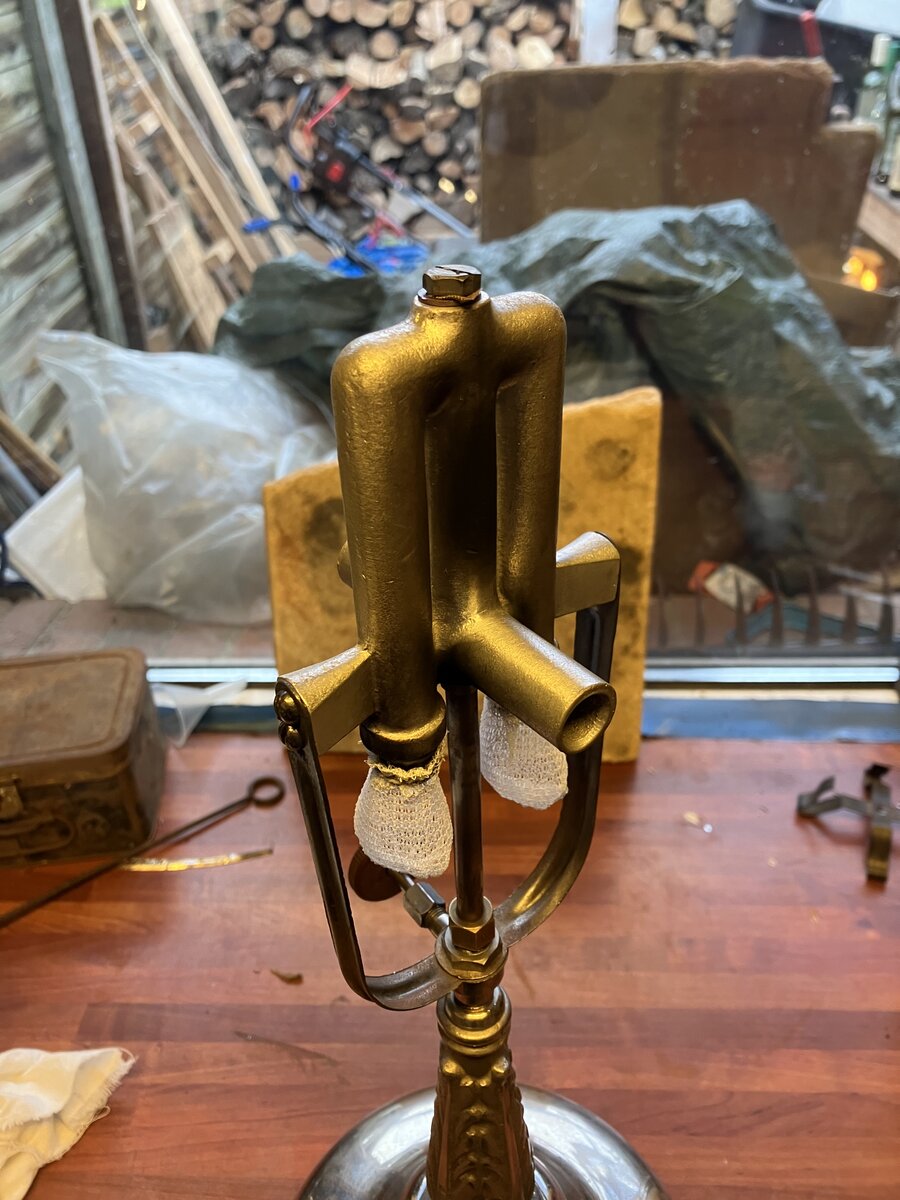

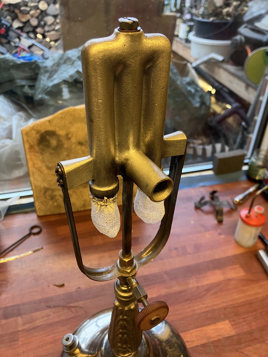

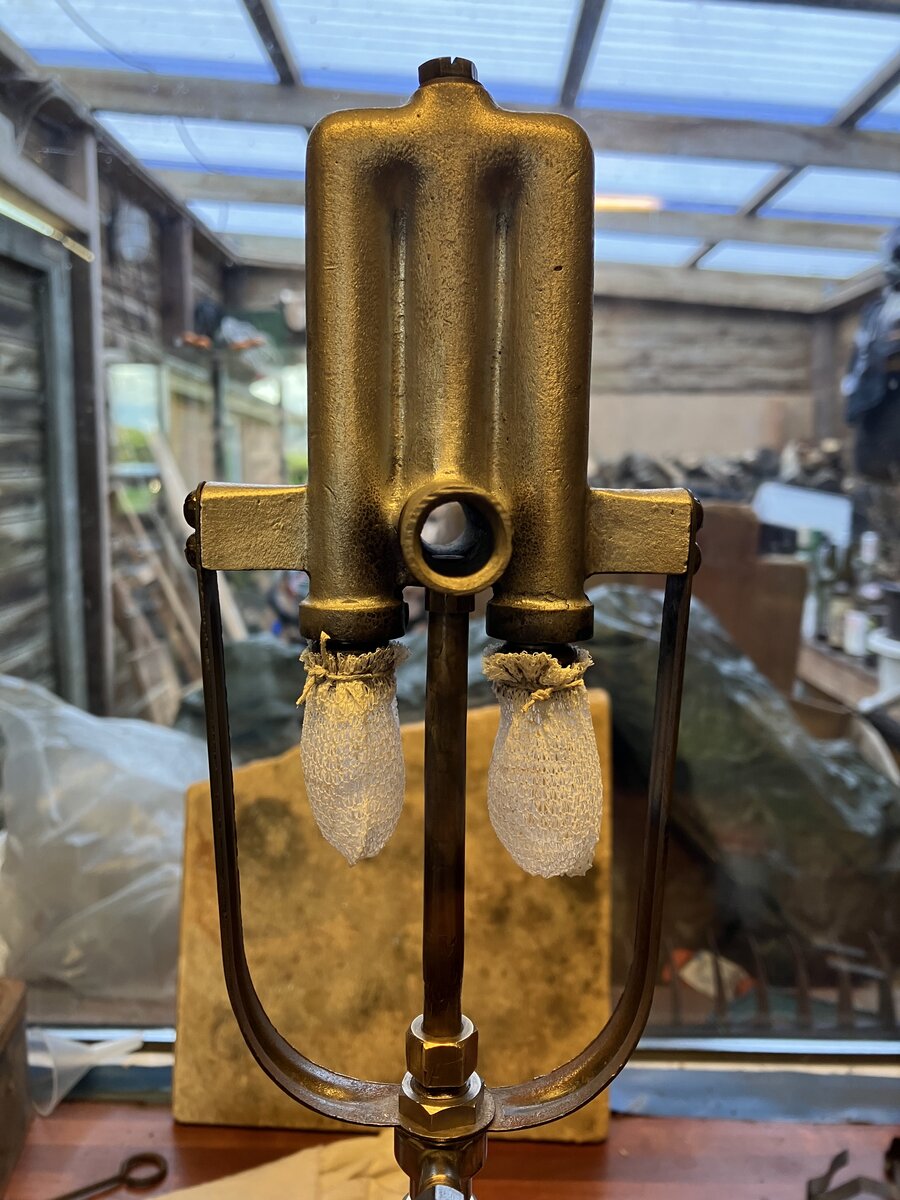

    It had stress cracks which I sealed - As per advice from Neil/Mackburner I removed some ugly brown asbestos from inside the Generator and replaced it with some very fine brass mesh rolled up inside the Generator.
    Mantles are two old Coleman 21 Silklites.
