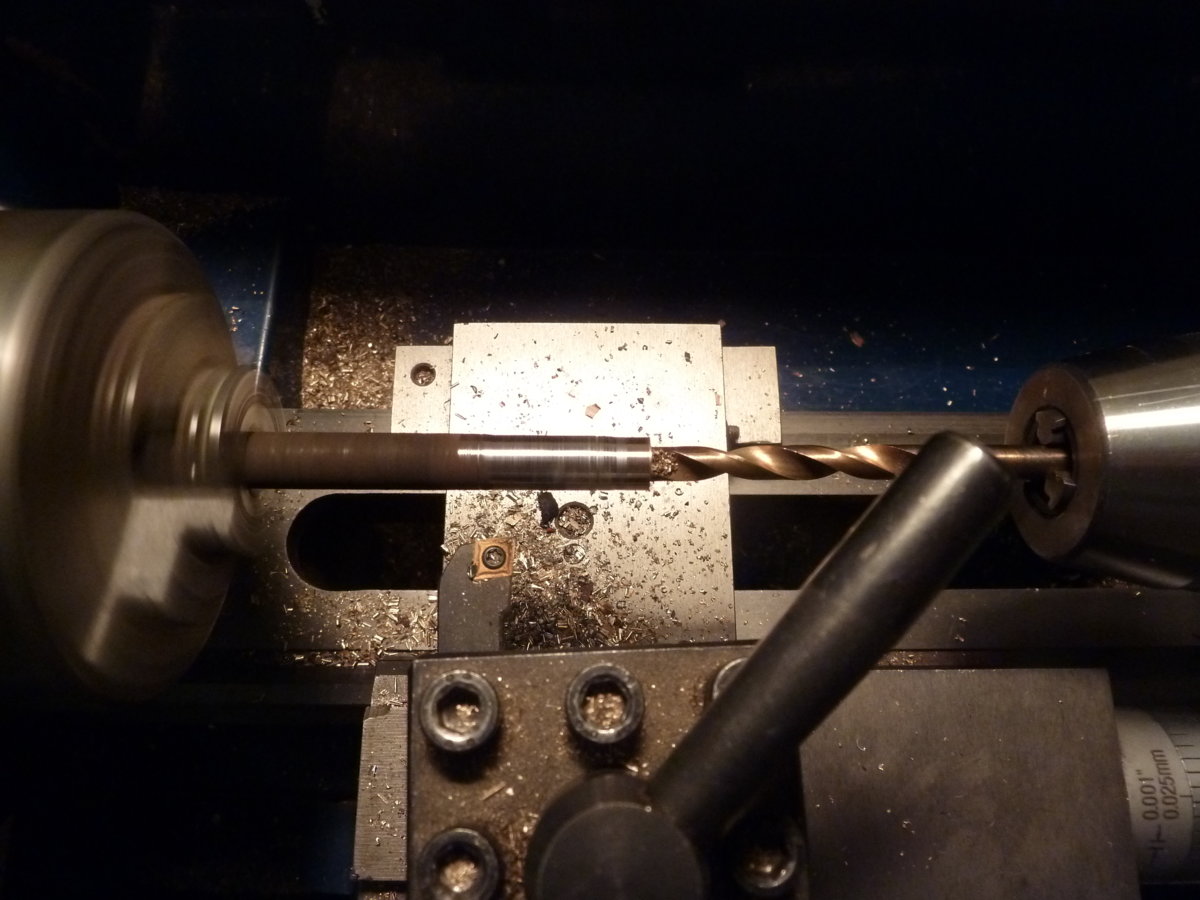

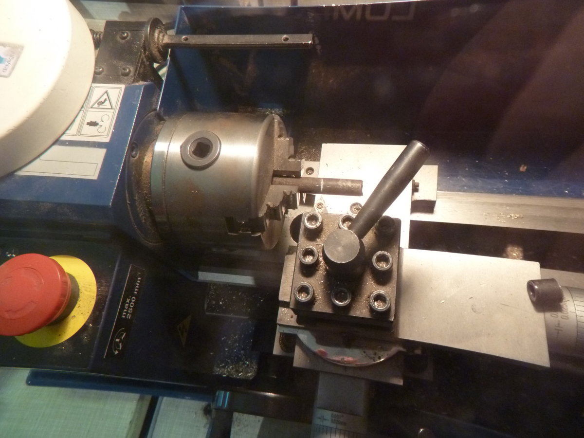

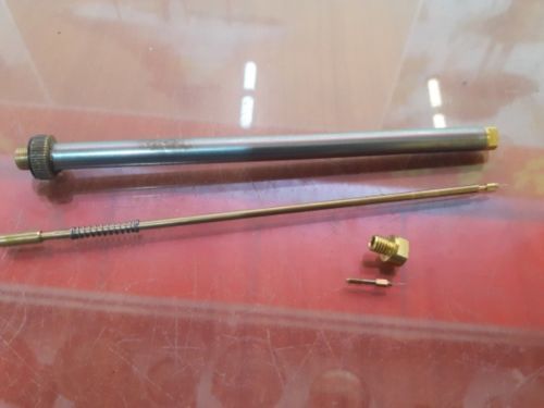

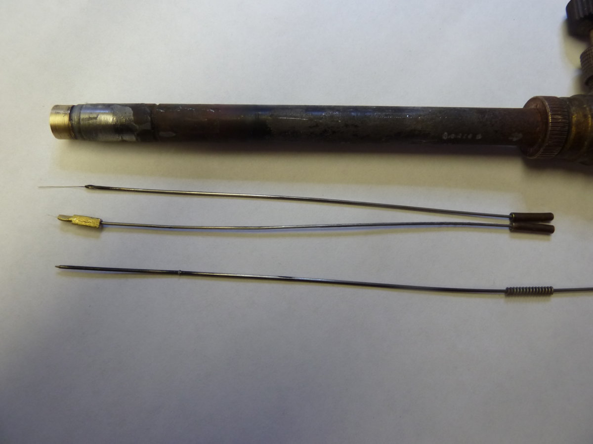

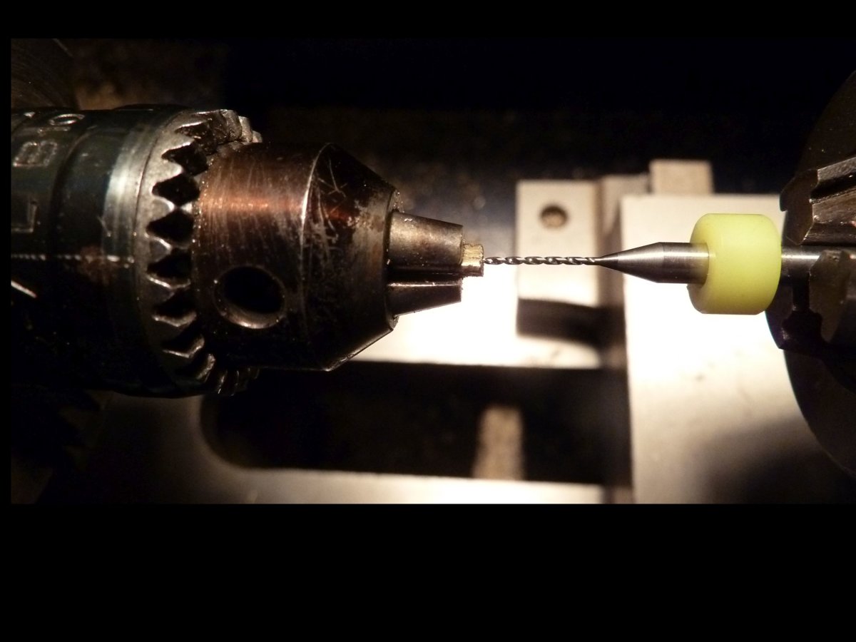

    Hello, I do it this way: I edit the evaporator on the lathe and so I can use a nozzle of a Petromax and clean the carburetor inside. A wire is soldered to the cleaning needle to clean the nozzle. So I can continue to use the evaporator of a Tilley lamp.
    B
    R
  12. 1956LD1
    Jun 8, 2017
    41
    Hi,
    I would love to hear more about your conversions such as parts, threads, and general performance.
    Vielen Dank,
    Josh.
  13. rollschmidts
    rollschmidts Subscriber
    Jan 8, 2011
    222
    If I do not bother anyone, I like to do a little reportage with photos. is that OK.?
  14. Tony Press
    11,026
  15. 1956LD1
    Jun 8, 2017
    41
    that would be great!!
  16. rollschmidts
    Jan 8, 2011
    222

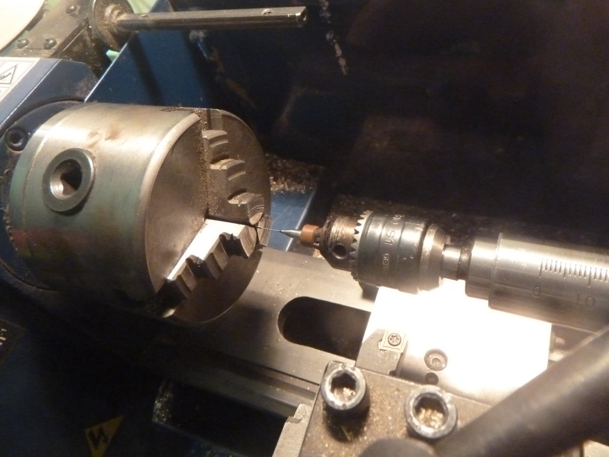

    Hello, here are the steps:
    cutting off the generator on a lathe, making a scrap metal / brass fitting that fits into the generator, soldering, drilling, and threading a Petromax nozzle into the bushing.
    Filligran is the work of the cleaning needle: There are two possibilities:
    Number one: Drill a hole in the wire of the Tilly needle and solder in a cleaning wire. Number: Two Insert a threaded hole in the Petromax cleaning needle / carrier and cut a thread on the needle bar of the Tilly. This will change the needle later.

    I've only worked on generators from Tilly so far. But I think that would work so well with others.
    I would be glad if the reportage is interesting.

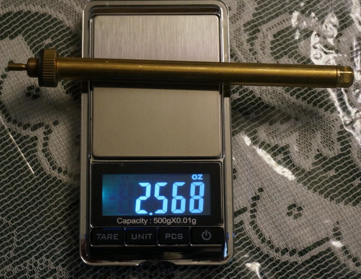

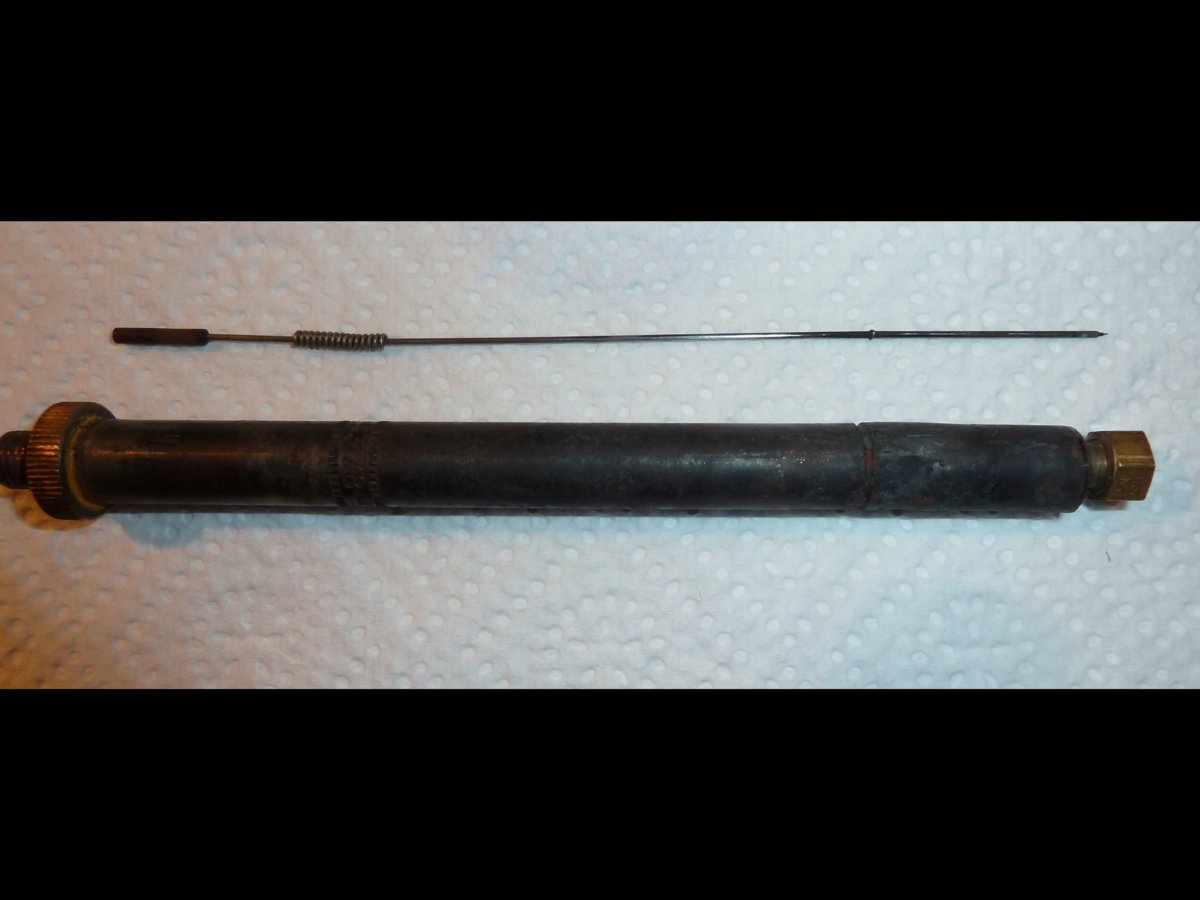

  22. Norman
    Jul 1, 2011
    747
    Spokane, WA
    @Tony Press
    Hi Tony,

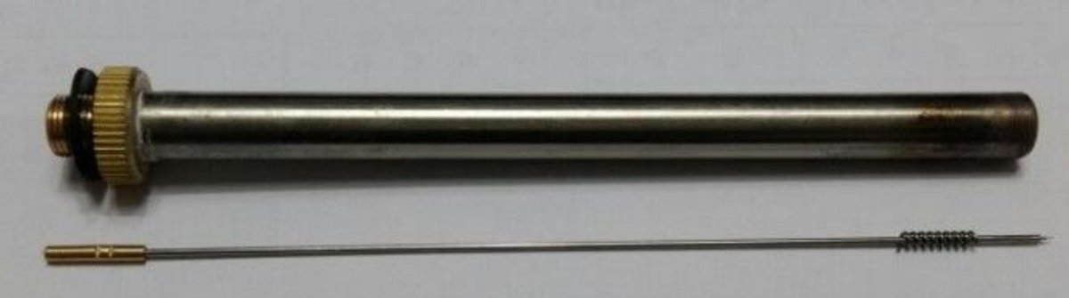

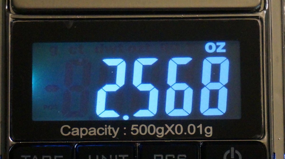

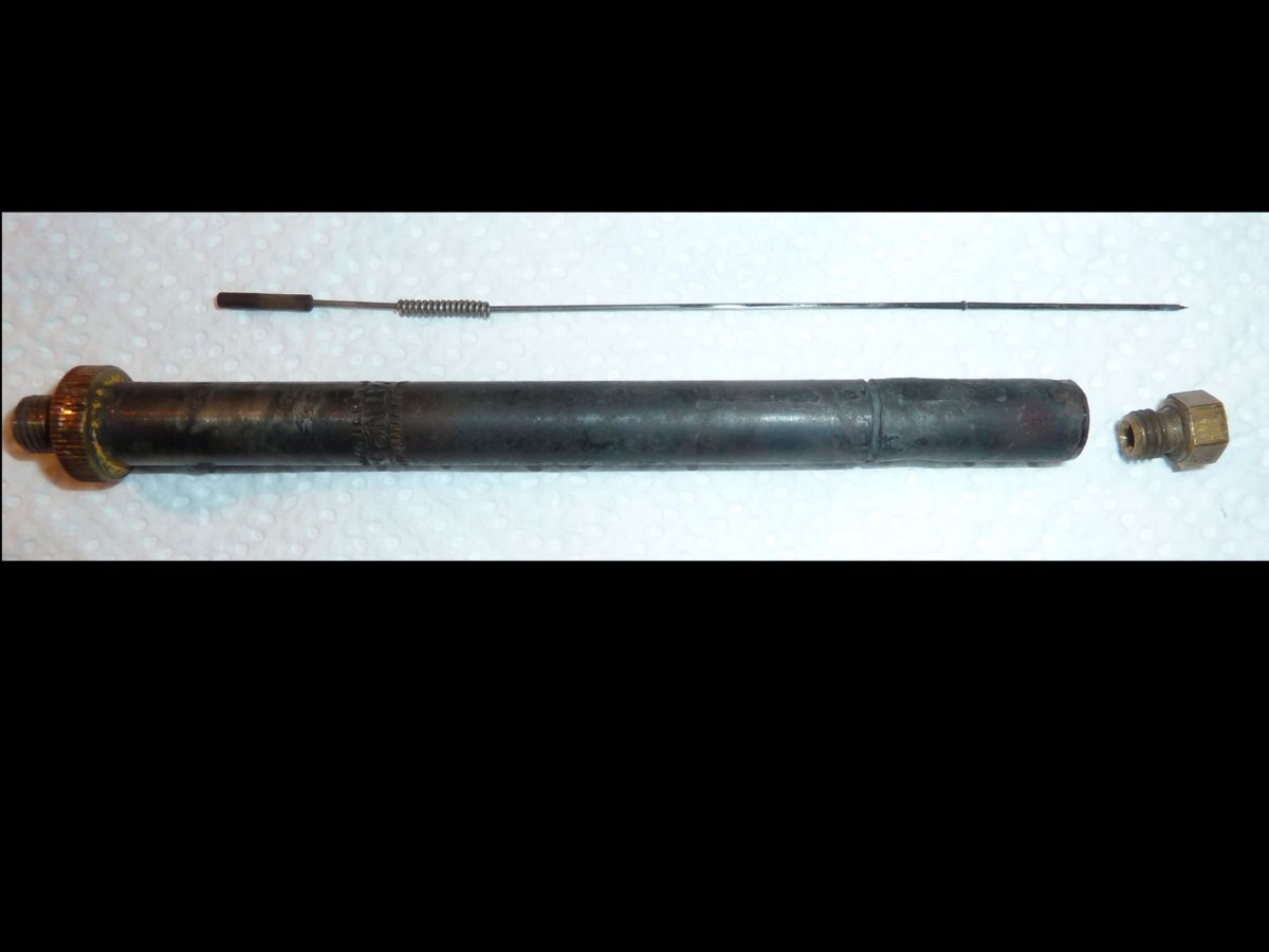

    I recieved my new generator/vaporizer.
    I weighed my new 5 inch made in Taiwan and for comparison I also weighed the original Tilley 5 inch vaporizer.
    As can be seen the new brass vaporizer is twice as heavy as the original Tilley vaporizer.
    Taiwan vaporizer.
    Original Tilley vaporizer.
    As stated above the new all brass Taiwan vaporizer is twice the weight of the original Tilley vaporizer. Granted this doesn't mean much but it should be considered.
    I have 2 Tilley lanterns which will receive the new Taiwan vaporizers. Once done with the rebuild I will post the results.
    Cheers,
    Norman

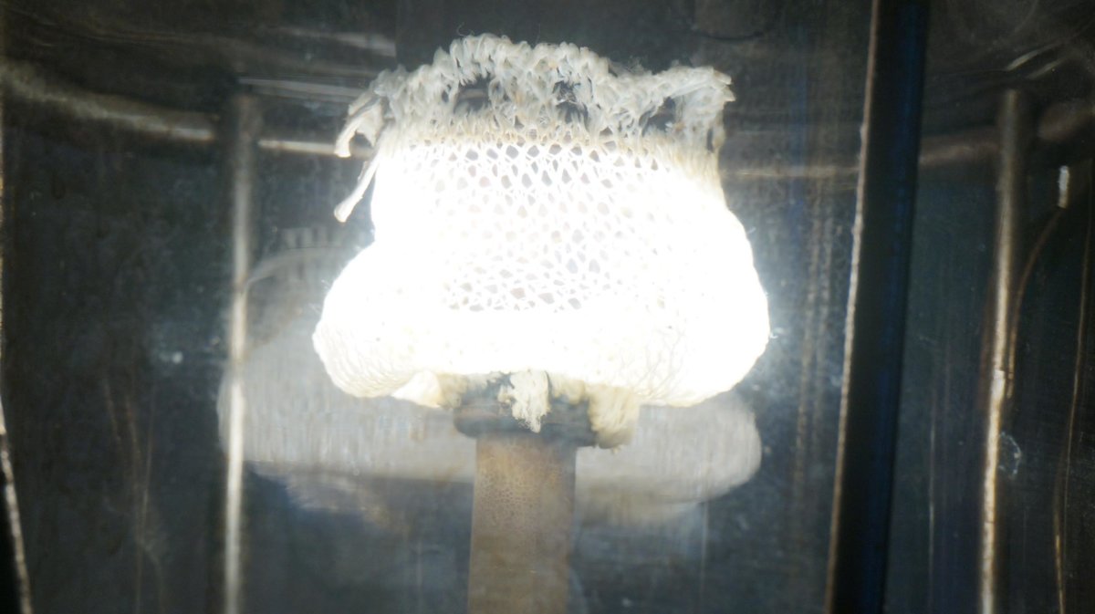

  23. Norman
    Jul 1, 2011
    747
    Spokane, WA
    Hi there,

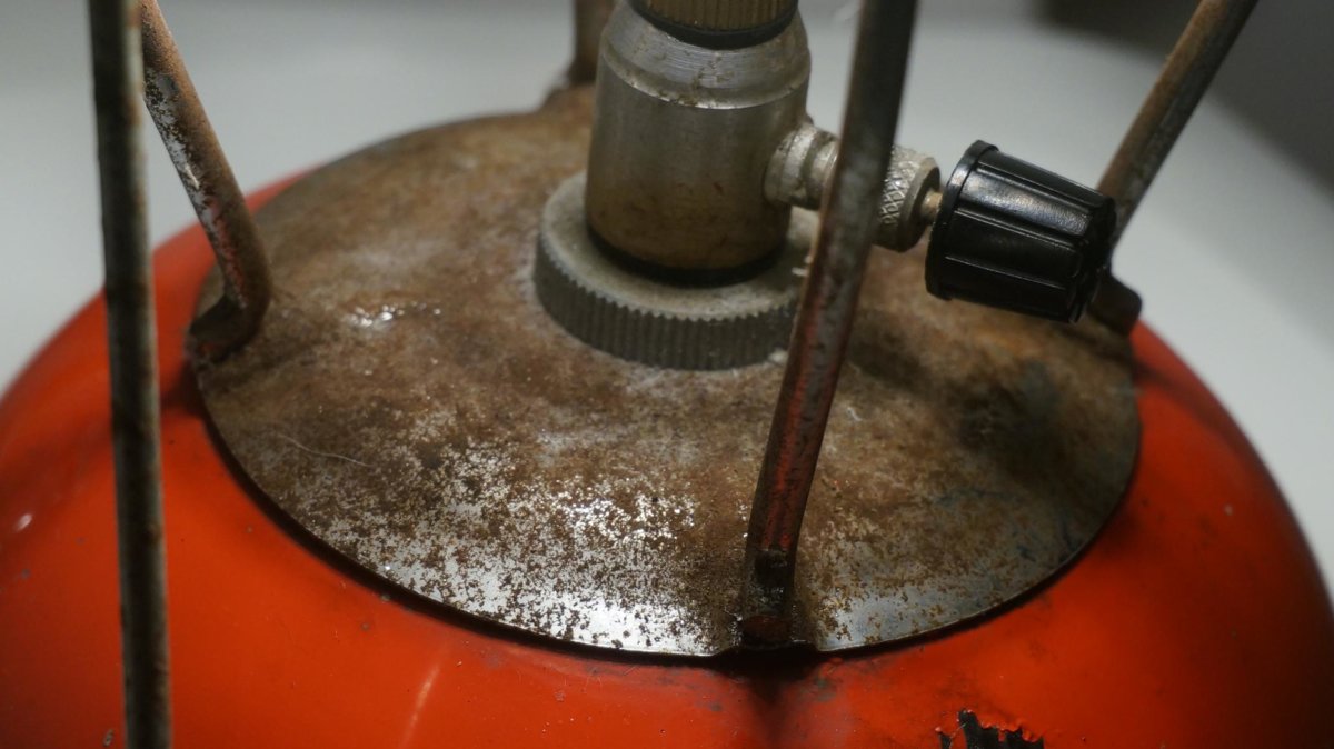

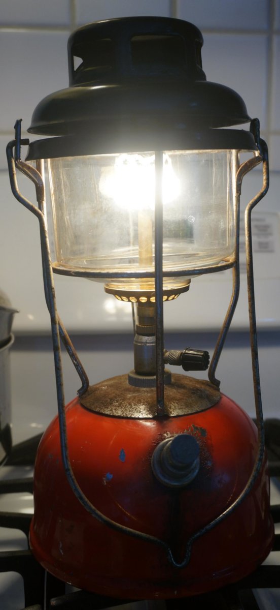

    I had to replace almost everything on my X246B except for the pump leather because all it needed was to be soaked in some oil.
    Here are the pictures of the first firing of this lantern.
    This lantern was a dirty beasty and still is. I just cleaned off most of the dirt.
    I decided to take the lantern down to the basement where it is very dark so I could get some simulated night shots.
    I let the lantern run for over an hour without any problems.
    The new Taiwan vaporizer is working very well indeed.

  24. Tony Press
    11,026
    @Norman
    That’s looking very good.
    What is the kerosene you’re running it on?
  25. Norman
