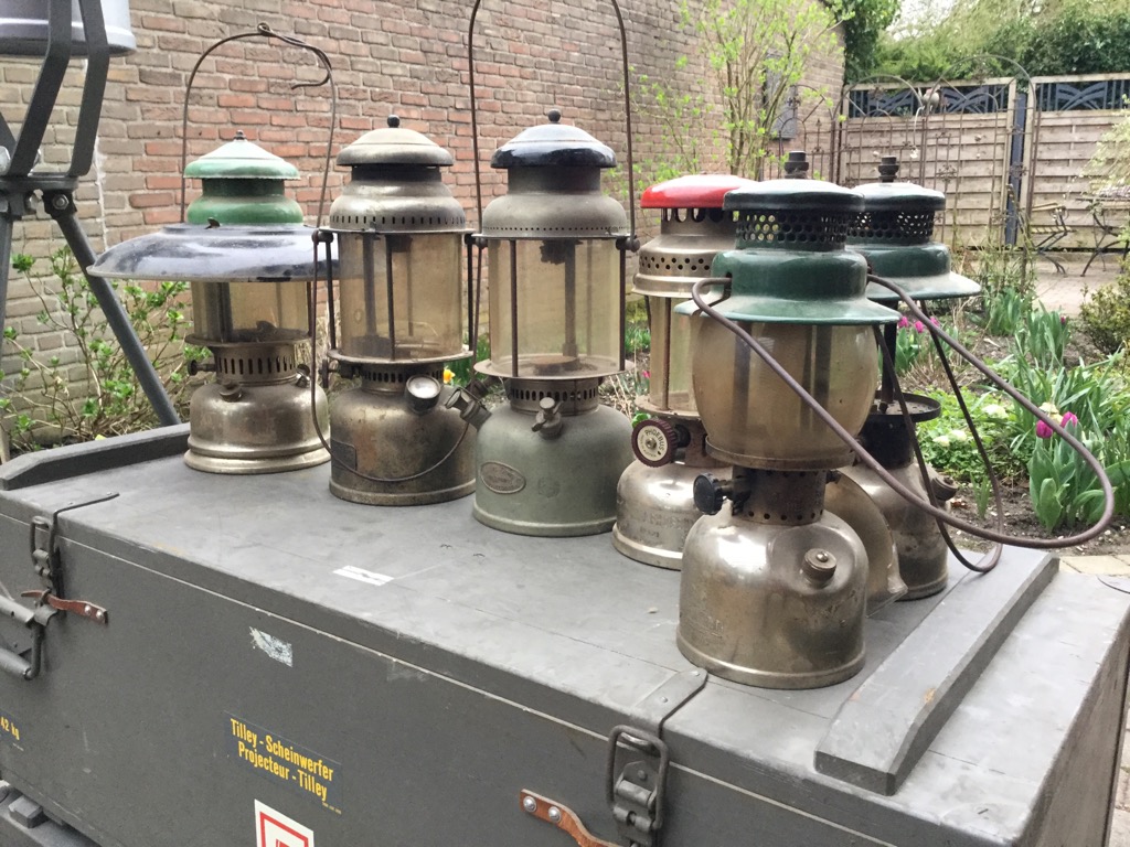

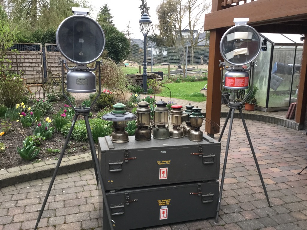

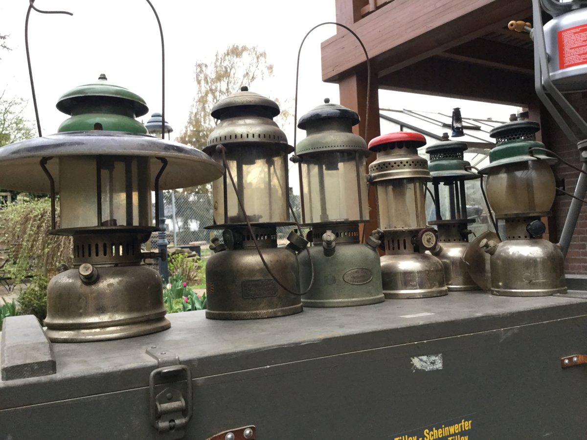

    Hello everybody,
    My wife and I went on vacation in Switzerland. 2 lamps were planned, my wife just did not know how big they are. The other 6 lamps were random.
    Primus 1020 from 1933
    Alpfons senger from 10 1929
    Eugen Schatz from?
    Phoebus 621 from?
    Coleman 242 B canada sport 9 1949
    Coleman 242 B canada 12 1950
    greeting Alfons

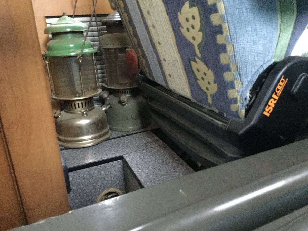

    The holiday was very nice, I had to take the boxes in the camper.
    To the annoyance of my wife, but was short lived. everything is fine now.

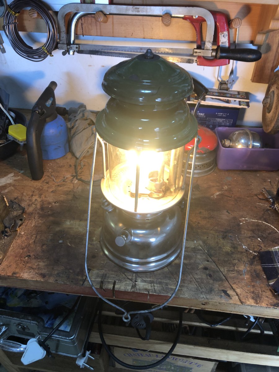

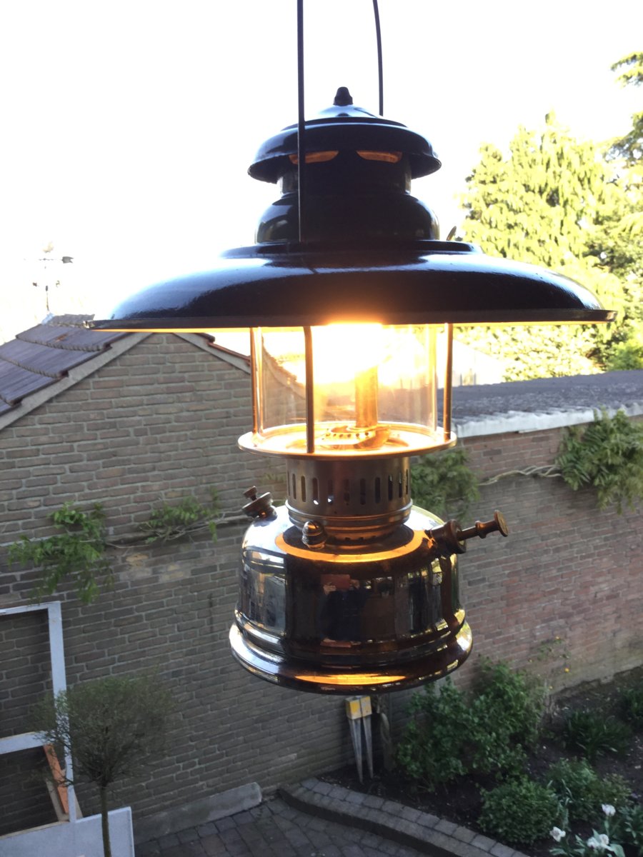

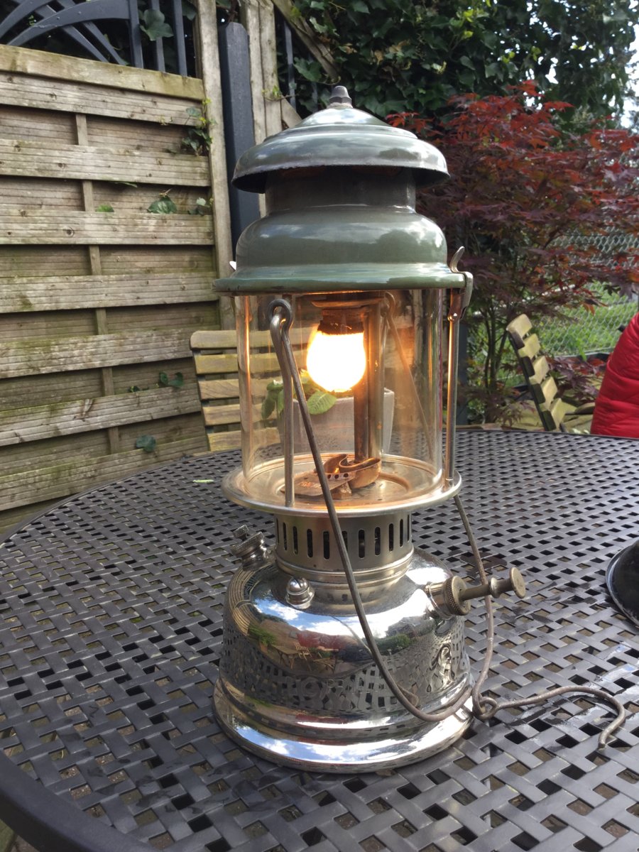

    I cleaned the primus 1020,
    I do not really get it on.
    after 10 to 15 minutes she has a flame wreath around the stocking, I do not know why. Can anyone help me?

  11. Nils Stephenson
    3,409
    How much have you cleaned the vapouriser? It could be from carbon build up. What about pressure?

    Replace the jet and the needle.
  14. phaedrus42
    phaedrus42 Subscriber
    2,056
    As stated above, the jet could be over-size, the vapouriser could have carbon deposits inside (so easy to clean on these with a brass rifle brush) and it wants a good quality 500cp mantle.
  15. Willem
    Sep 2, 2011
    28
    South Africa, Cape Town
    Just got my primus 1020 going after having the same problems. Cleared vapouriser twice and replaced jet. I thought a 300 cp mantle would be more appropriate. I thought this was a 300 cp lamp? Got mine going finally.
