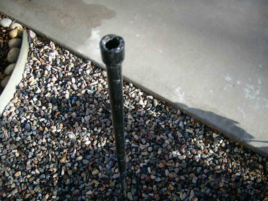

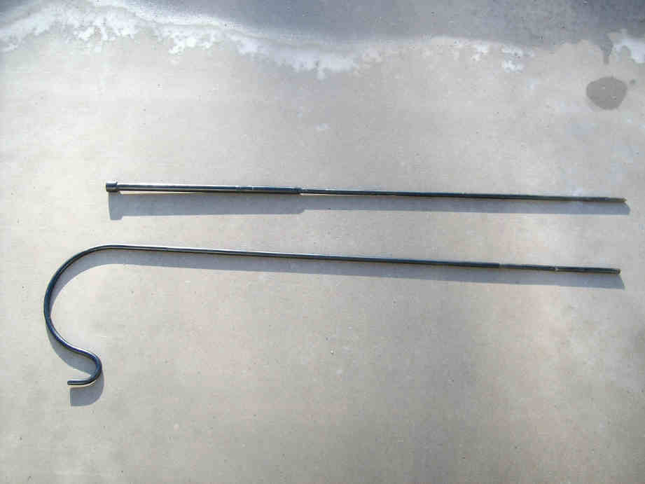

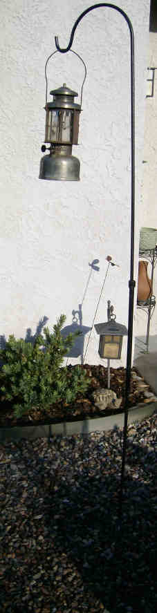

    Iwoo: Here are better pictures of it, It's in two pieces for transport, The bottom is sleeved so the top can be used as a slide hammer to pound it into the ground without having to bring a hammer.( had a welder buddy do that for me) Bought it at the hardware store and had it modified for my use. I believed it was intended to be a plant hanger or patio lantern hanger. It is very stout, won't bend even when I tested it to 25 pounds. Mike...

    Hi iwoo: Each half is 47 inches. The top shaft penetrates the sleeve 11 inches. The rod diameter is 0.476 inches and sleeve diameter is 0.715 inches. Make sure the inside diameter of the sleeve is close to that of the rod to insure a vertical pole with little lateral movement. I would make the upper section penetrate the sleeve a little more than the 11 inches that I had done, 15 inches would do nicely. If you do so, adjust length of rods to ensure they remain equal, if that is your wish. See added collar to top of sleeve for strength. Mike...

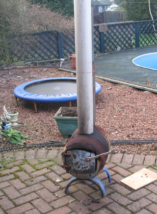

    Right update time, I got some 0.5 inch rebar (6 meter length)and I tried to heat it up in my wood burner but I cannot get it hot enough, next plan is to get some coke and a blower and get it red hot!!! has anyone got any advice for home black smithing?
    Pic of wood burner

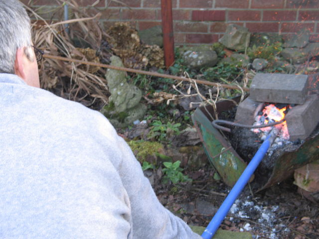

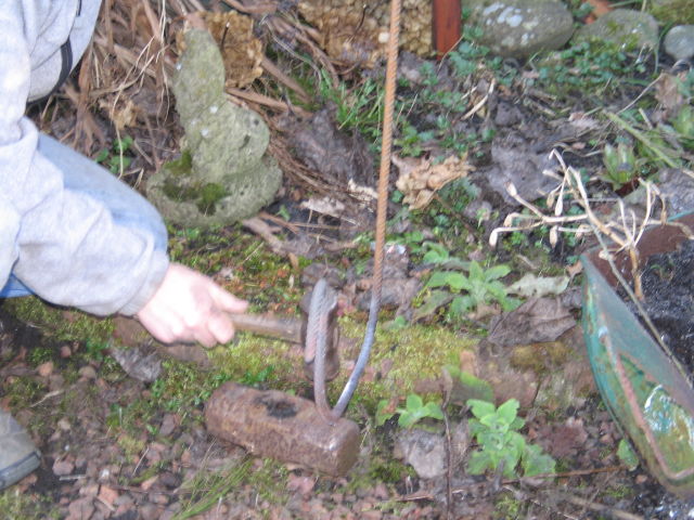

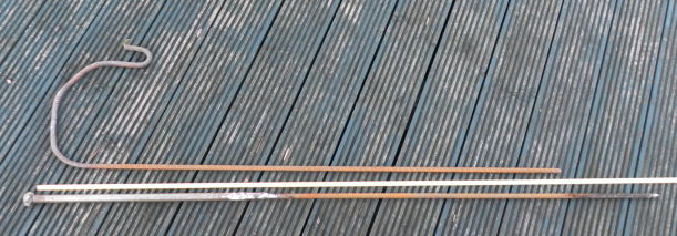

    Right more progress, I managed to conjure a forge up using charcoal and an air blower (like you do!!!! after some good ideas from YouTube)
    and bent my crook

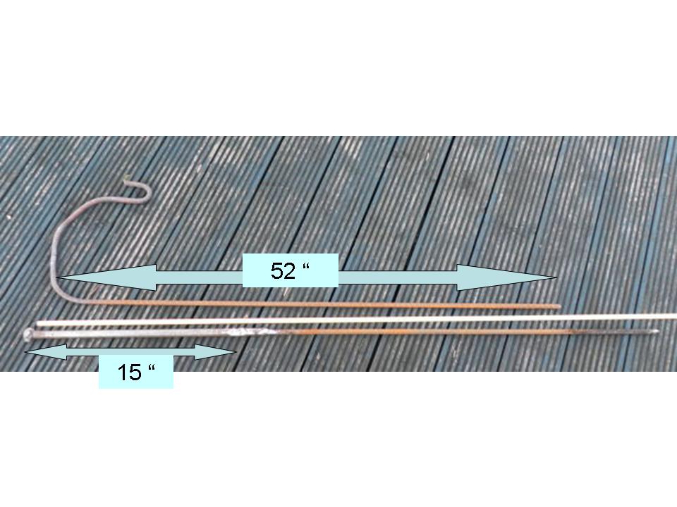

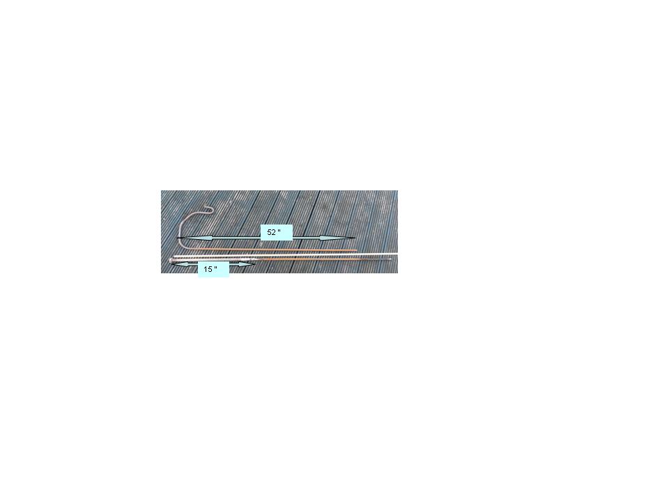

    I have made the top half socket into the bottom by 15" as recommended by Flivver, My crook part half is 52" tall from the ground to its highest point, what length will I have to cut my bottom half?
  13. furry flivver
    116
    Ariz.
    Iwoo: I made the top and bottom equal length. This length can be determined by the overall height you wish it to be once set in the ground. Remember you lose the distance the top penetrates the sleeve and the distance the bottom penetrates the ground. Mike...
  14. iwoo
    iwoo Subscriber
    118
    Durham, England.
    Ok thanks Flivver, making sure I measured twice and cut once
