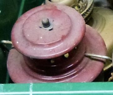

    Good afternoon Anyone Know the model make of this lamp in picture . Been waiting long time for it to arrive and its beat me.

    Sorry I accept I do not know what is under the lid .
  3. David Shouksmith
    Veritas Superb - I wouldn't expect too much when it finally does arrive... :doh: ;) :lol:

    Quite correct David Veritas superb
    Vapouriser looks bent, cleaning needle wont move .On /off solid Pump NRV seized. It was not going to light up , hence lots of soot . Off to work I go.

    The thing with these lanterns is, when you've fixed all that it probably still won't work very well, if at all - some did but a lot didn't.
    The trick with them seems to be to use a globular mantle because that gets the heat source nearer to the vapouriser. One of the Bullfinch types works well but I can't remember off-hand which one it is. I'll check later...
