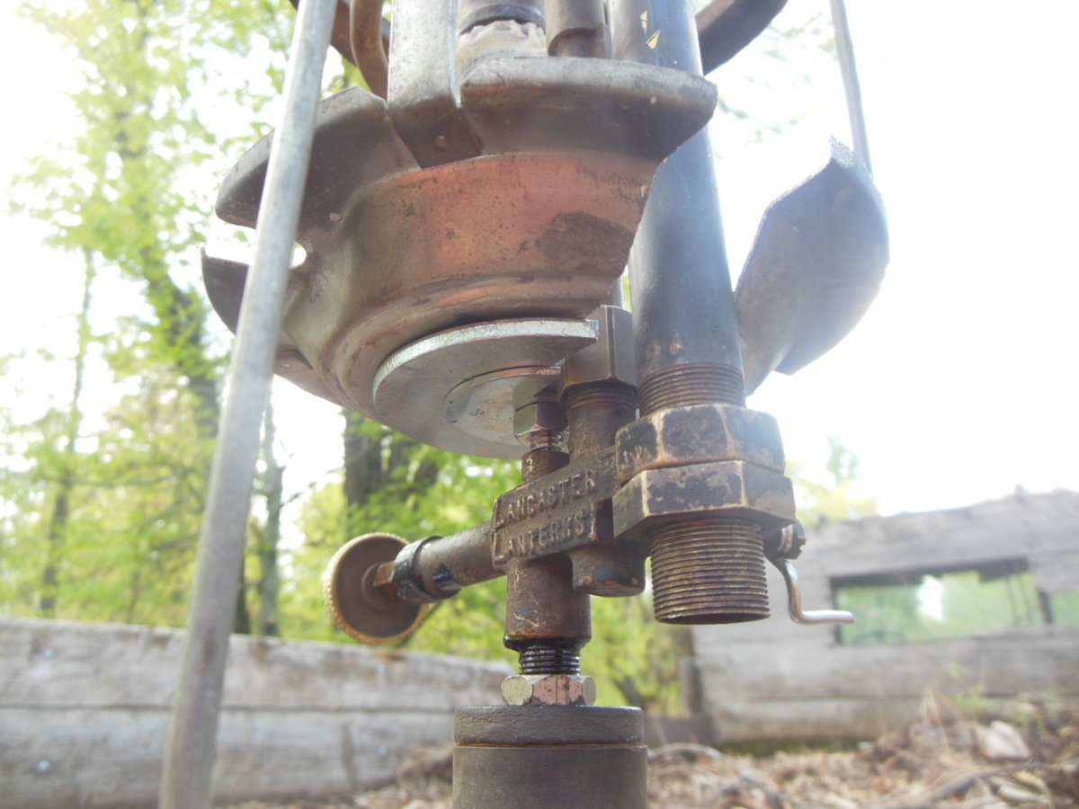

    I obtained a Lancaster lantern, burnt out the loop, but was still concerned that I should replace it. Will one from a Nitehawk work on it? Posted pics in the Reference Library under America, other brands.

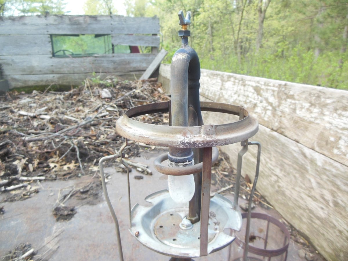

    No problem I think, but just in case. Heated the loop twice now, had been clear after the first heat up, but wanted to do a bit more. Emailed Pitman Marine thru eBay, but on my tablet dont seem to have attached pics go thru. Rotated the little hood thingy on the top of the genny, was told the opening faces towards the back, that was one thing I suspected..

  6. hikerduane
    Oct 2, 2011
    418
    Received a reply from Pitman Marine here in the states, gave me a link to a listing they had on the bay which I had been looking at anyway, just wanted confirmation it would work. Also ordered a globe from them also since it should fit and one of my Coleman lanterns which I had fitted to this lantern to see how it fit.

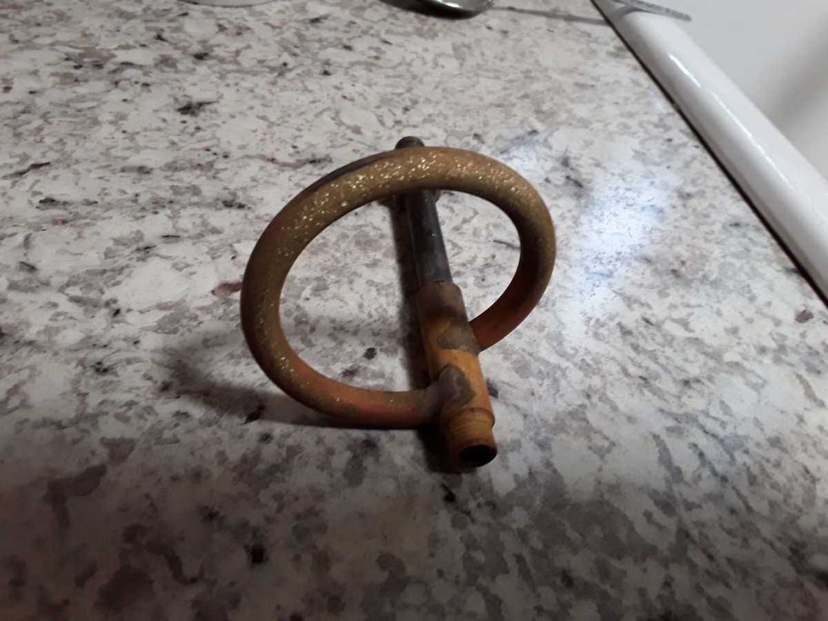

  10. Matty
    Mar 22, 2015
    2,586
    Queensland, Australia
    Duane,
    I'm a bit puzzled as to why you haven't seemingly made a concerted effort to clean the inside of the generator. I see you have heated the vapouriser twice to clear it but in subsequent posts you mention carbon and frequent use of the pricker.
    I would be trying to thoroughly clean the inside of the generator and be done with the constant niggling problems.
    I would soak the generator in vinegar for a few days then use wire bottle brush to scrub the inside of the vapouriser.
    Other members more well versed on Preston Loop vapourisers may have other solutions that will rid the vapouriser of carbon.
    [​IMG]
  11. hikerduane
    Oct 2, 2011
    418
    @Matty, you must not be familiar with a Preston Loop genny. The loop is attached at 90 degree angles to the genny tube at both ends of the loop. I don't have a super flexible brush that will make the bend to push thru the loop. The trouble would be to get it started into the loop. I soaked the old genny again for hours last night in hot vinegar.
    I worked on modifying the new genny by drilling the ends of the loop that protrude into the genny tube as they prevented the pricker rod from being inserted. I can only reach the upper end as the engineereed area between the two ends of the loop prevent be going beyond the upper end to hit the lower end and I dont have a longer drill bit to reach the lower end. Jets don't swap out nor will the old pricker go thru the opening in the new jet. Genny extension will not fit the new genny either. May have to just run the new genny without the rod.
    Duane
  12. hikerduane
    Oct 2, 2011
    418
    Here is the old one, getting sparkly after being in vinegar for hours.
    Duane

  16. phaedrus42
    phaedrus42 Subscriber
    2,056
    Looks like Lancaster make their own non-pmax-standard vaporisers, jets etc. Designed for more than 500cp maybe?
    Some Preston loops are attached at an obtuse angle wrt the bottom and top ends, making access a bit easier. I suppose it is done that way to improve the gas flow.

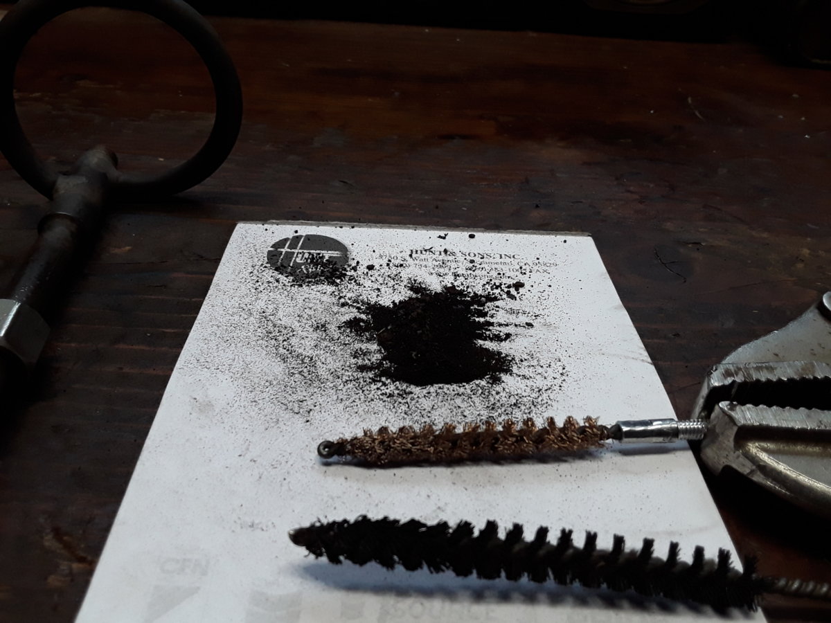

  17. hikerduane
    Oct 2, 2011
    418
    @Matty, you were right, tons of carbon up the tube. Don't have the proper gun cleaning kit to go with this brush I got years ago. Only need to go up the tube a little more to get the whole length.
    Duane
  18. hikerduane
    Oct 2, 2011
    418
    Up and running without running the pricker every 30 seconds, flickers quite a bit. Used my compressor to shoot air thru the pipes, using a BB to divert air thru the loop, moving the BB then to the other side to change things up. More dust out then.
    Duane

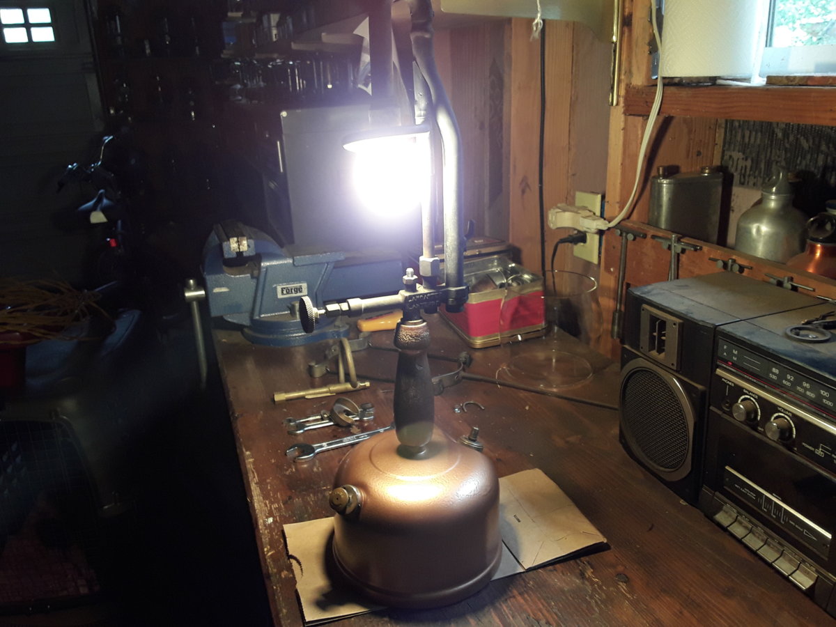

  19. Matty
    Mar 22, 2015
    2,586
    Duane,
    I'm glad you got it sorted. The lamp looks to be burning brilliantly. :thumbup:

  21. hikerduane
    Oct 2, 2011
    418
    Thought the wooden handle went the other way, but did not spend much time rechecking fit of the threaded part that holds the handle in place. Lantern still flickers some, but happy don't have to use the pricker. Fuel stays in the system after shut down, so tonight instead of turning the valve off first, released pressure out of the fount, that way with the valve open, fuel could drain back into the fount, leaving no mess if taking the genny off or other parts.
    Duane
