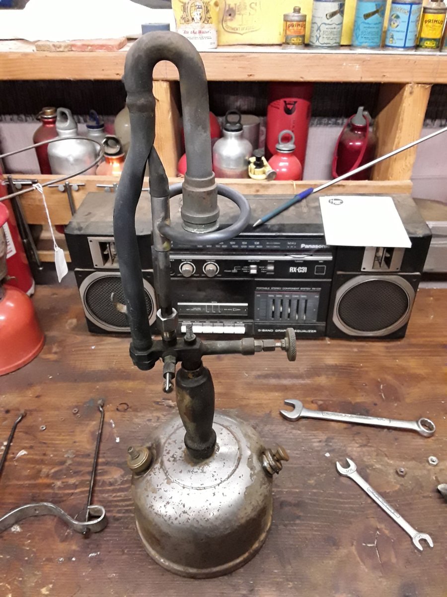

    Got this today in the mail. Need to figure out why it surges quite a bit. Had heated the "loop" and soaked in hot vinegar for a few hours, got some flow then. Failed to blow out the loop when done.
    Duane

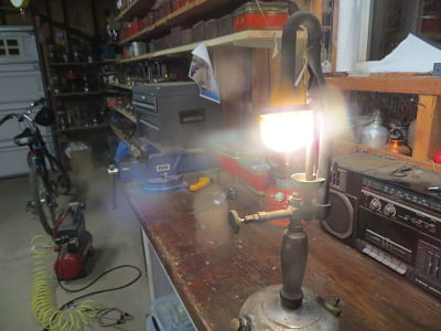

    It's working well!:thumbup::thumbup:
  4. hikerduane
    Oct 2, 2011
    422

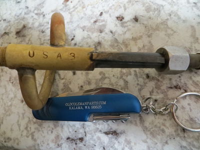

    Thank you. Found out like I suspected that the slant cut hood thing on the generator tip has to have the cut towards the burner tube. Works even better now, but carbon is fouling the tip, so was working the pricker every minute, down to every five minutes. Looks like a keeper.

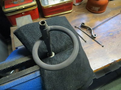

    Did you try getting a piece of wire into the loop to loosen the carbon?
  11. hikerduane
    Oct 2, 2011
    422
    Supposed to be 500cp, but from what I read, a strong 500cp. Impossible to work a wire thru the loop. I reheated the loop and tapped some carbon out, then blew air thru the loop, using the BB trick. I'm going to get some new nuts for the shade holder, some of the nuts are real sloppy, can push them on a little bit, then need to order a clear globe that will fit the holder. Make take more run time for the remaining carbon to work itself out. I'm trying to get a new Preston loop, waiting for a reply.

    It can be a pain getting a cable or wire into the loop but not impossible. A useful tool is a metal rod that is a close fit inside the part of the vap. tube where the loop is, and put a 45 degree bevel on it. Insert the rod from the bottom end to the level of the loop exit and use it to guide the cable into the loop. Once it is in I put the other end in a cordless drill on low speed to push it all the way through. Then work it in&out to scour the inner surface of the loop.
    On reflection, I think it should be possible to make a guide tube for the cable, perhaps with another length of tube that slides over the guide, to keep the cable straight while it spins and to protect the nipple thread.

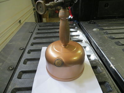

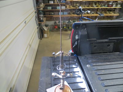

    Coleman lantern fount painted, not sure I want to spend money finding something better. The shade holder was a pita to put back on. Globe (hope it works better) , new genny ordered.
