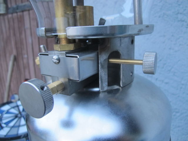

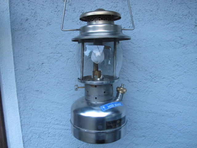

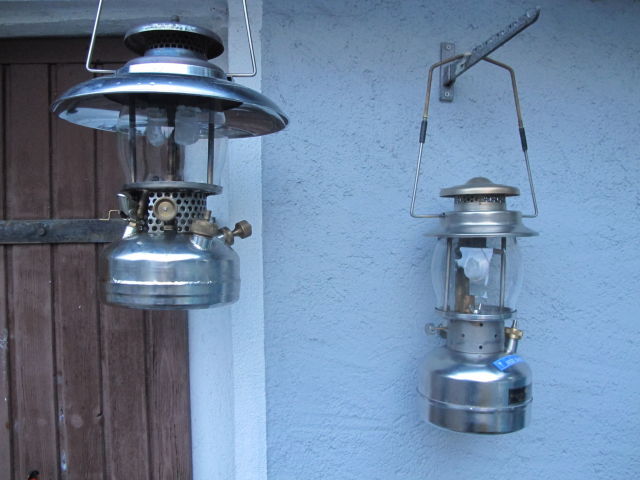

    Here is my latest lantern from Lancaster lanterns, Pensylvenia.
    It's the Nite Hawk # 701 with 500hk.
    It is missing the handpump and the manometer.
    Only a air valve for a fast airfilling.
    2 ltr gasoline are good for a long lighitng (I didn't test it how long her will light).
    1390222365-A2__2_.jpg 1390222402-A1__2_.jpg 1390222458-a4.jpg 1390222485-a3.jpg 1390222895-A5__2_.jpg

    Those parts are not missing,Jake did that because Amish pressurize their lanterns from a compressor. Will he is having problems selling them to his local market because they are well on the way to using propane lanterns. I think the biggest selling feature is the stainless fount with the seam around the middle.I cancelled a seven year wait. Because it was a totally different lantern from what I ordered with a higher price.It is a quality build not polished on most parts.Amish don't like shine. DanL

    I thought I would add my 2 cents regarding the Nite Hawk. I have talked with Melvin at Lancaster Lanterns a few times regarding the design revisions that it has undergone in the (quite a few) years since they first came up with the concept.
    He said the original 2 mantle burner design seemed good, but there were a lot of customer complaints after use in the field that it was really finicky to run for some reason. This was the main reason why they chose to go with the single mantle "400" style burner head that was a proven design used for years on their table lamps.
    (I actually find the 400 to be kind of finicky as well!) The preheater torch on some of the early models was abandoned due to quality control problems, and poor reliability, and most Amish customers use an air compressor anyway, as Dan said, so at least the first runs of the new series were built without pumps.
    Most of Lancaster Lantern's new units don't have manometers either, so I think they were deemed unecessary/unreliable as well.
    The entire valve block and burner assembly can be stripped down in a few minutes and all the O-ring seals replaced. I don't think it uses any proprietary gaskets or other whatnots at all.
