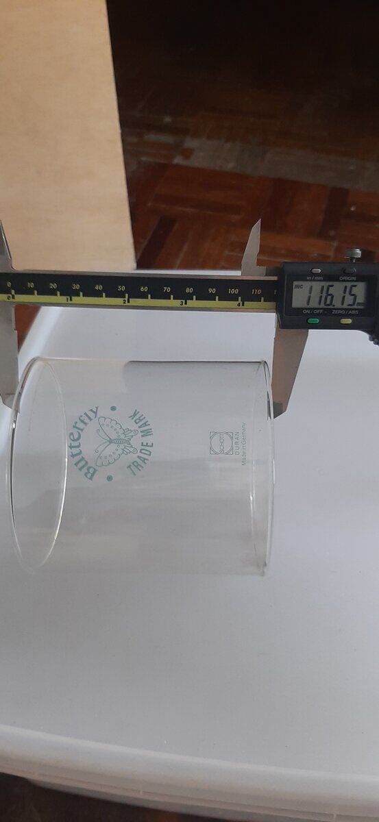

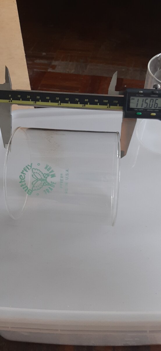

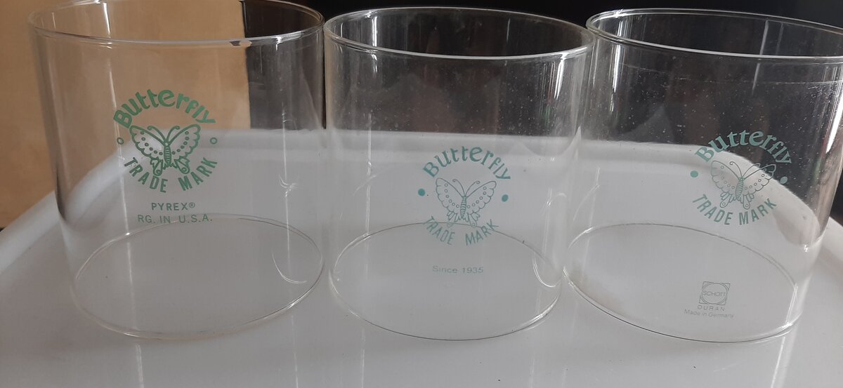

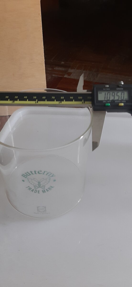

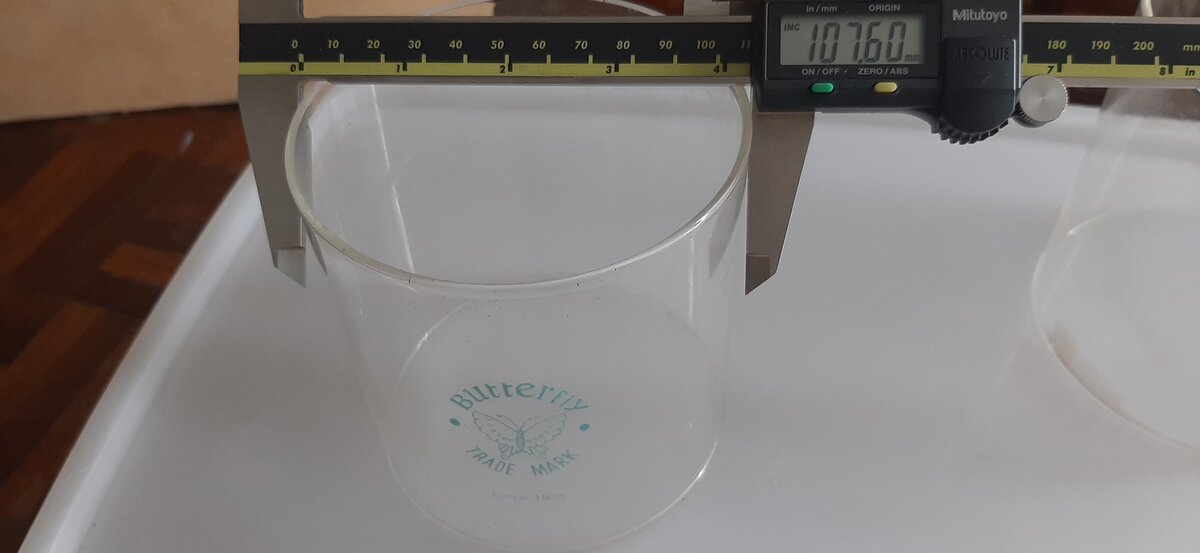

    Butterfly:-
    I've got three different variants for the lanterns of the same size.
    First photo: from left to right, all cylindrical and clear:-
    1. With Pyrex registered/USA.
    2. Regular, bought from Lea Hin (possibly local/Malaysia / Singapore / Indonesia).
    3. By Schott Glass, Germany.
    All with slightly different basic dimensions:-
    1. Pyrex, USA Registered, approx. 109mm diam. x 115mm height :
    2. Regular Lea Hin, approx. 107..108mm diam. x 114mm height. :
    3. Schott, Germany, approx. 109.5mm diam. x 116mm height.:
    All measured using a Mitutoyo Digimatic vernier caliper. Code no. 500-197-30; model no. CD-8" ASX...but with shaky hands, rather blurry eyesight and likely measurement errors:).
