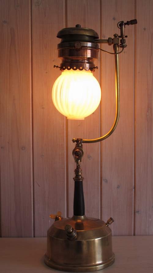

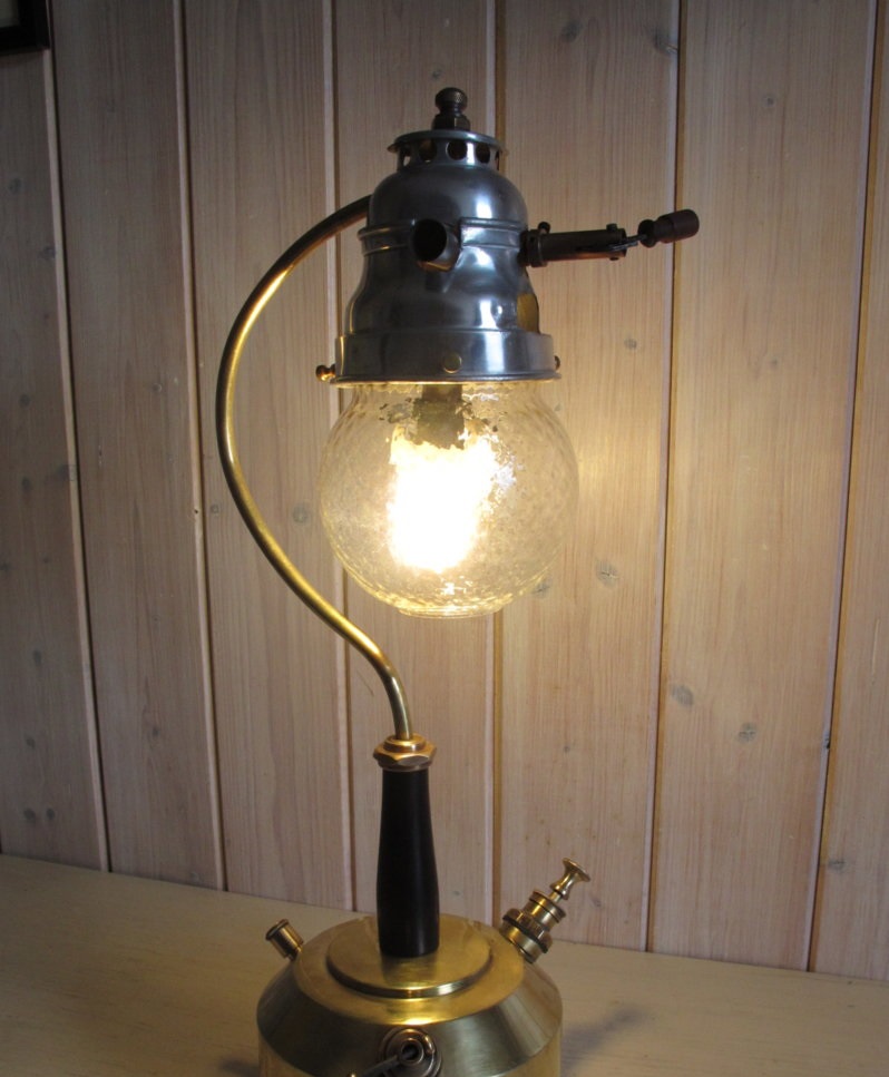

    In France, there is no really pressured lamp tank based on Kerosen / Gasoil . These were GUENET & ABBAT lamps, Unic, Tito Landi, but not longer exists from long time.
    Difficult to find, including in a flea market (Brocante en Français).
    But it still exists a great brand well known in Europe : Campingaz that still produce gaz lanterns based on pressured butane gaz bottles/cartridges.
    They are really easy to use, some had a built-in piezo and are perfect in the event of a power failure.
    I have two of these model : "Lanterne Lumogaz Plus". Each unit cost between 25€ / 30€, including mantle and holder.
    It exists a lot of variants (That can be connected on R90x bottles, or pierceable bottle (that cost under 1.5€ in a DIY mall)).
    I prefer Lumogaz Plus as the cartridge (using VALVE) can be removed to be used in another Campingaz (or compatible production) like torch, grill, stove, heater.
    Lumogaz provide a light between 10W to 80W (in full brightness).
    It exists another Campingaz lamps like Symphony (120W), Stellia (160W require 2 mantles).
    Spare items are still produced too.
    Regards.
