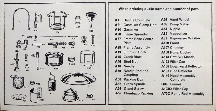

    greetings pyros..
    im chasing a parts diagram for an Alladin 1A ,
    its complete and been stripped , cleaned etc , but not sending fuel past control cock ,into vaporizer , yes tank is pressurised and fuel cock assembly functions...
    cant be sure of seals and washers requirement and integrity without diagram.
    my guess is it the seal @ btm of vaporizer , it looks compromised and possibly home made
    cheers.
    11,105
    Welcome, @toe - cutter
    There are parts diagrams in the Reference Library, but you must be a Subscriber.
