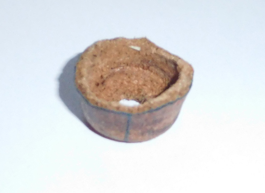

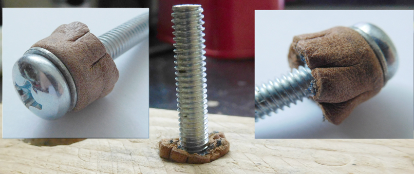

    So I am doing something wrong just trying some trial runs on a couple of leather scraps I had.
    1 piece 1.4mm thick and the other 1.1 mm thick, the results are the same in that they both `crimp` as can be seen in the image.
    I am using what materials to hand ie wood and some bolts.
    Any ideas ?

    A few suggestions:
    The leather is collapsing because there is no inside support or male former.
    2 m/m leather may be more suitable for pump cups.
    Cold or room temp water soak the blank 20 minutes.
    Lightly oil the blank, and the sides of the wooden former. Neatsfoot oil is best.
    Perhaps a light chamfer the edge of the former, to allow the leather to flow in easily.
    Press in slowly with a suitable socket from your toolbox, using the bench vice or G clamp etc.
    If the pressing is too tight, stop and find a smaller socket or tube.
    Trim edges with a sharp blade before removing.
    Allow 24 hrs or so before trimming & removing from the die set. Take notes for next time.
    You can search here and elsewhere for making pump cups. Suggestions only, hope something helps. Cheers.

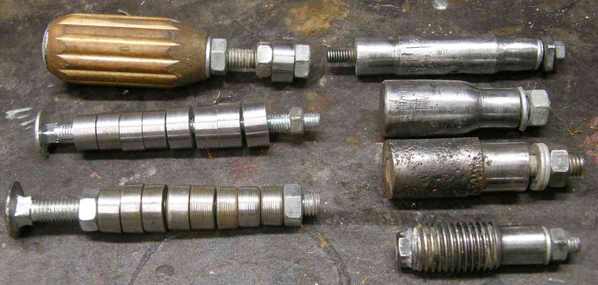

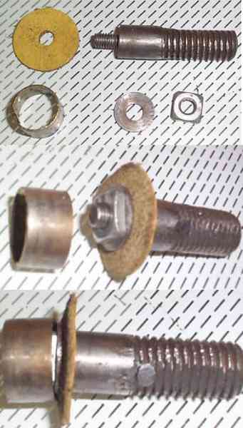

  3. Mackburner
    You need a mandrel on the inside to support the cup. This is what I started with.
    I used an old Tilley pump tube as a former. Dip the leather in near boiling water and shove into the former and let it dry. ::Neil::

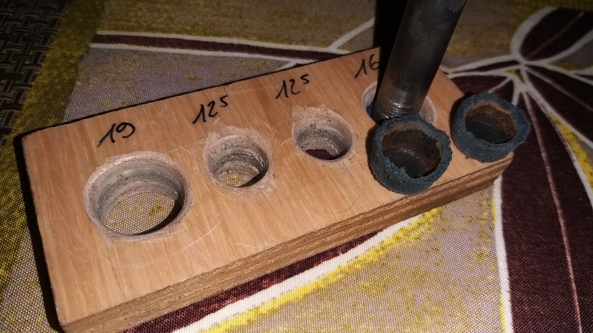

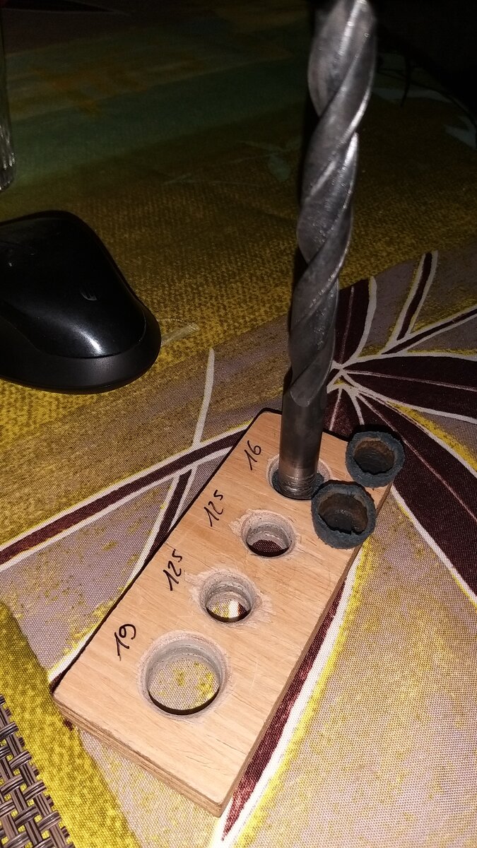

  8. Sellig33
    Sellig33 France Subscriber
    May 15, 2017
    1,053
    My tool for making leather cup.
    I use 1.5mm leather
    This afternoon i used a 16mm leather cup on a stove, and he work perfectly.
    Just coat the leather well with oil, i use 5W40 mechanic oil.
