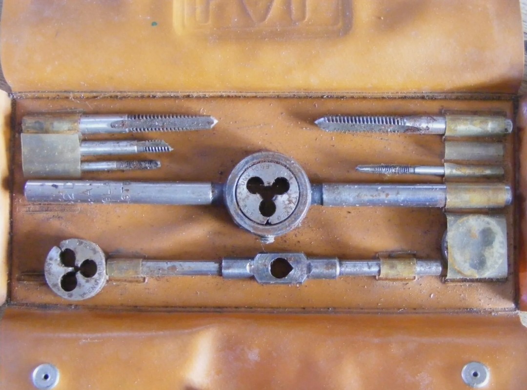

    I think I'm getting a bit obsessed, but I had to buy this, with assistance from @MG as the seller wouldn't post. Thanks mate.
    I'd never heard of a specific brass thread type before (known as British Standard Brass even though it was never a British Standard) but given the strange, non-standard thread types many lantern manufacturers used I figured it would probably come in handy sooner or later...
    When I realised it was a Lehmann Archer & Lane it was the cherry on top! It's missing the 1/4 inch taps but came with some extra taps in lew. In time I'll replace what's missing and in fact I've already found replacements for the missing tap wrench and die stock!
    I've cleaned up the taps, dies and wrench already and tomorrow I'll start on the case, hinges and clasps. Happy days!

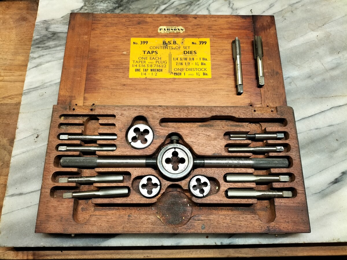

  2. Rangie
    Dec 8, 2012
    586
    26tpi at its finest :D
    Cycle thread is close at a pinch but the proper brass thread is the best to have. HSS is preferable but as we are dealing with brass, then carbon steel is more than capable and can make replacements more affordable ;)
    You'll find it useful, particularly the 1/2", used in a few places on Tilleys and Vapalux. I used one the other night to clean a cross-threaded spigot hole in a heater burner.
    A handy thing to have in the fettling arsenal 8]
    Have you got the 1" diestock?
    Alec.

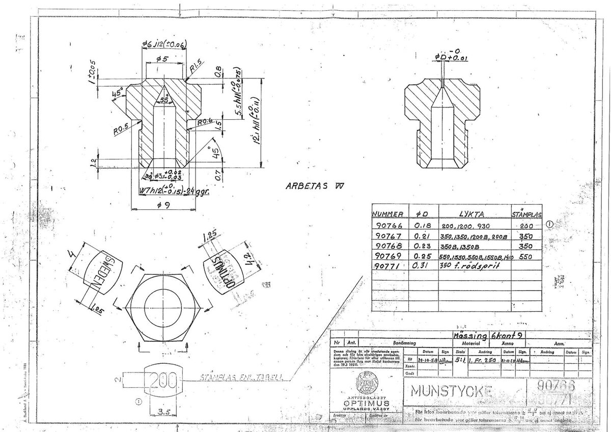

  21. Nils Stephenson
    3,405
    The Optimus jet is definitely 7mm diameter with a Whitworth 24tpi thread. This is from an Optimus drawing, so I'm certain it is correct.
    It is also interesting to note the jet hole sizes for the different cp lamps mentioned on the drawing.
  22. Tony Press
    @Nils Stephenson
    Yes! Very interesting information re the jets.
  23. MYN
    The drawing is certainly a valuable information. Technical drawings on latern parts like the above aren't easy to come by.
  24. ColinG United Kingdom
    4,816
    Wiw, what an incredibly useful drawing. These kinds if resources are invaluable!
