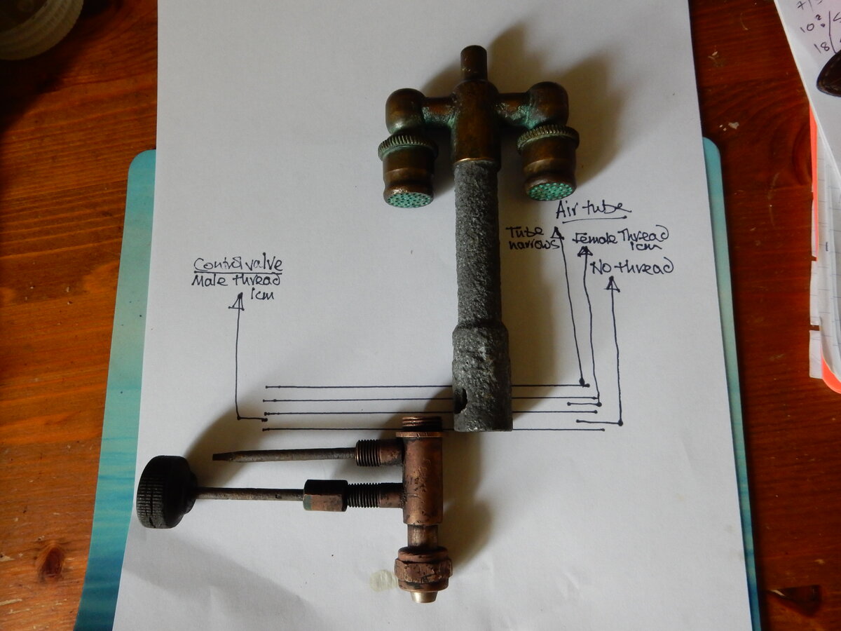

    Hi, I have just found the above lamp at a boot fair. I had obviously not been used for many years but, apart from the mica globe, seemed to be complete.
    I am now in the process of taking it apart to clean etc and have found that the iron air/fuel generator does not fit onto the control valve as the internal screw thread in the tube is too far up to connect to the control valve thread.
    I wondered if there should be a brass threaded sleeve at the base of the air tube or something similar to join the two parts. Can anyone enlighten me and suggest a way forward.
    Thanks in advance , Roy

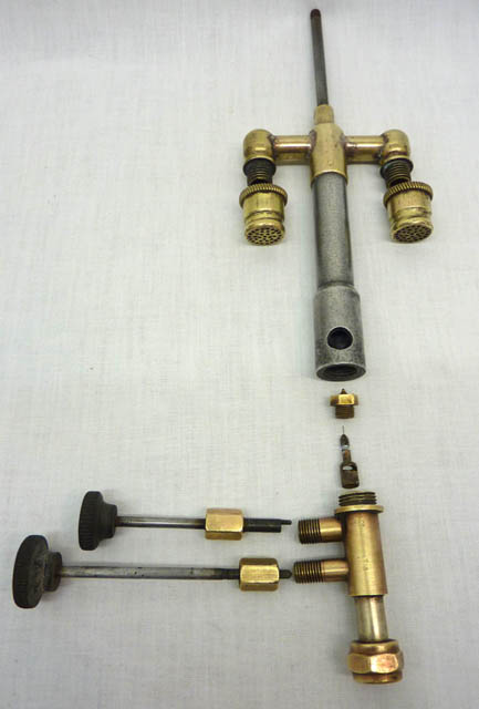

  2. WimVe
    3,542
    Pictures would help a lot to see what the lantern may miss in parts.
  3. James
    James Subscriber
    Jan 5, 2011
    1,152
  4. WimVe
    3,542
    Hmm but the lamp of Conny has no problems. So pictures of the lamp in situ would be more helpful, I guess.
  5. RoyBuchan
    Oct 21, 2016
    26
    Hope this explains
  6. WimVe
    3,542
    hhmm, ok, so the:
    - air tube should have thread at the bottom otherwise it can't screw onto the valve assembly
    - the valve top looks like missing the jet > big problem, donor or make it yourself
    - I guess there is no needle ? see above
    - do not try to remove air tube from brass burner heads, it will be rusted in situ. Which is no big deal.
    - steel air tube and burner heads must be cleaned
    Needle and jet, original, would almost be impossible to find. Unless somebody has a donor lying around. Are the steel valve rods operational ?
    The use of steel in combination with brass is a hell for us to get loose if stuck (corroded) in place.
  7. RoyBuchan
    Oct 21, 2016
    26
    Thanks for your comments, which are very much in line with mine.
    I had hoped that the air tube originally had a brass insert to avoid corrosion but sadly no so
    I do have the jet but no needle
    & both valve rods are stuck fast.
    If I cannot sort out the problems, it may well end up as a Frankenstein lamp!
  8. WimVe
    3,542
    As for the valve rods: quenching (?), heating up/cooling down, may break the bond between the rod and packing/brass.
    Don't break the rods !
    The lamp can operate without needle and maybe a stove needle may fit or can be adapted.
  9. Michel
    Michel Subscriber
    Jan 26, 2011
    1,429
    56 France
    Hi @RoyBuchan
    As you can see on the Conny's picture, you are missing the jet, the needle holder and the needle.
    The aluminium rod must have a thread, to be screwed on the lower part
    For the steel rods : Use heating (and tasting oil) so as to soften the asbestos cord that has dried.
    So you can pull the stem
