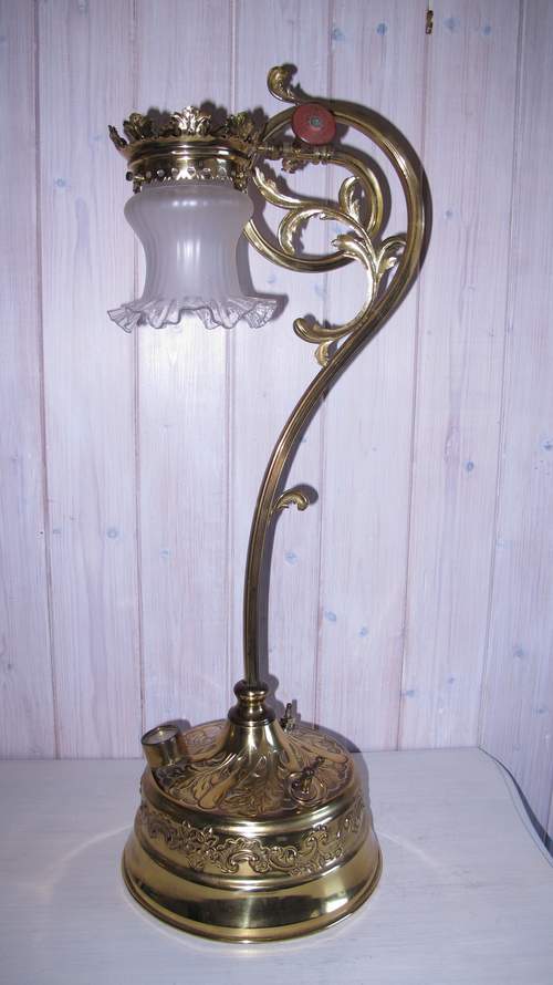

    hello all
    I am happy to present this Liotard Freres from 1914/15.
    the lamp was proposed for sale with 2 kinds of burner : the "bec Atout" or the "bec Magic".
    This one is fitted with the "bec Magic" (magic burner) which have been patented in december 1913 (FR474663A)
    Unfortunately a previous owner have electrified the lamp and disassembled the burner, but no hole in the fount, nor on the swan neck tube.
    So I only need a new "Magic burner" ;-))
    The lamp is huge : 70 cm tall and a 3 liters fount and was varnished to prevent tarnish.

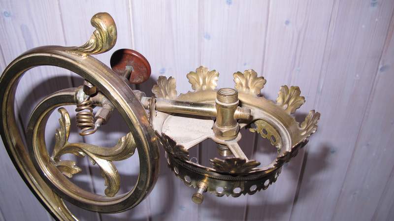

  10. Michel
    Michel Subscriber
    Jan 26, 2011
    1,429
    56 France
    yes, You are right Claus
    the dismantling has been done very properly.
    I think with you that it could be possible to redo the low part of the burner, perhaps with a U shape petromax tube ?
    the more difficult is the jet and his holder.

  13. Claus C
    Dec 18, 2012
    1,787

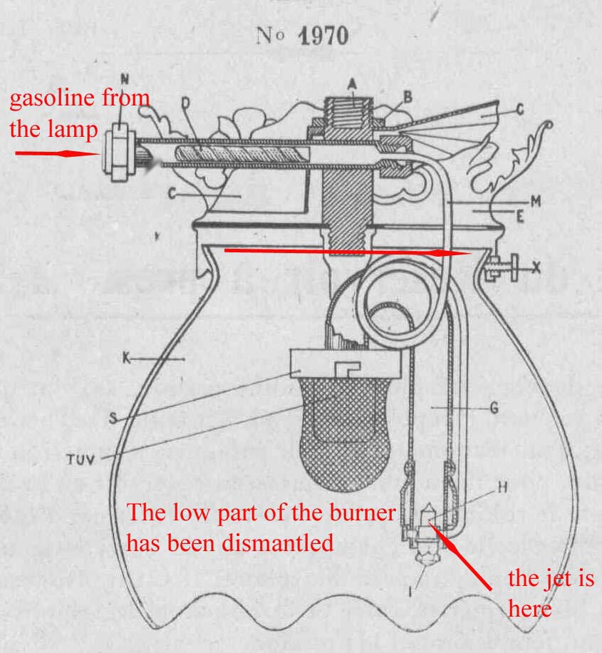

    I cant quite figure out how the gathering is in the D- and E-area. But knowing how the E-area is connected - then it should be no problem using a tube from a Petromax. The inner diameter in the U-shape would be app. 13 mm. the same at petromax almost.
    The biggest problem is the area D. I have never seen such before - looks magic :lol:
    It should be no problem making the A,B and C.
    I know where you can get the 3 mm preheater-tubes(B) and cut them the length you want. But I cant see how it is attached to the D-area.
    The A and C is just straight brass-chunks with holes and coil - no problem. Of course there would be some fettling making them look correct.
    The link below is a link to a danish site for model-builders and there you can find your brass-tubes for the preheater (B), but if you give up on danish then I am sure there is a french site alike.

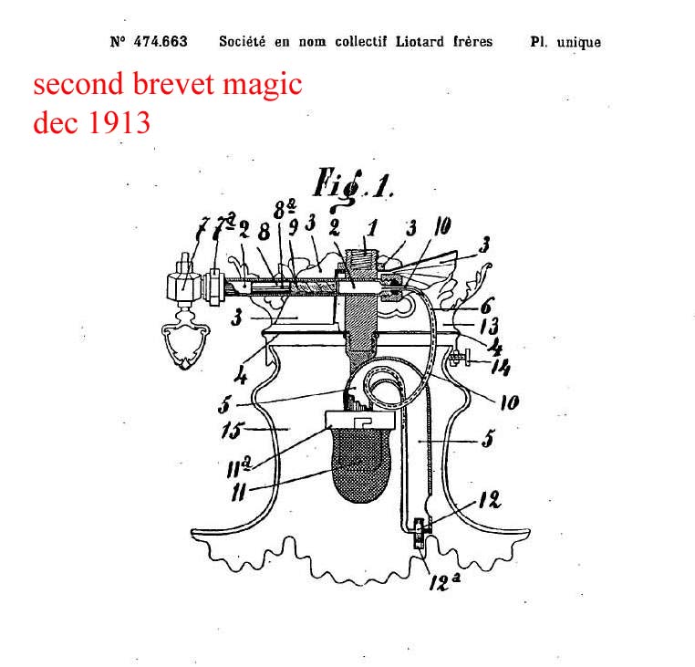

  15. Michel
    Michel Subscriber
    Jan 26, 2011
    1,429
    56 France
    Well, I continue the search and the reflection
    here is the drawing of the first patent claimed by Liotard Freres.
    the jonction between A and B is clearer.
    the C could be cannibalised or copied on another french burner.
    the 3 mm preheating tube can be bought in France, anyway, I have some problem understanding the Danish ](*,) [-X
    I don't understand very well how is built the D !!??? but this drawnig of the second patent can help a little.
    I believe that one must be a little inventive. We need a jet for the gasoline and an air intake hole. No needle in this burner. If the jet is clogged, you need to unscrew a little cap under the jet and pass a pricker through the jet in order to clean it by hand (this text is in a catalogue i own)
  16. Claus C
    Dec 18, 2012
    1,787
    Ah I think I get it.
    The preheatertubes lower end is attached/soldered to the jet/vaporizer and that is screwed in the collar that you just have to press on the swanneck-tube.
    That is also possible to make.
    The preheater and the vaporizer must form a pressure-tight system in one. If the vaporizer have a outer coil, then you can screw the collar on and press on the "Petromax"-swannecktube.
    And so it will also be possible to clean if needed - you just pull off the collar and clean, when cold.
    Could it be so :?:
    I dont know about the E-area now - looks in a way solid-casted more and more to me now. :-k

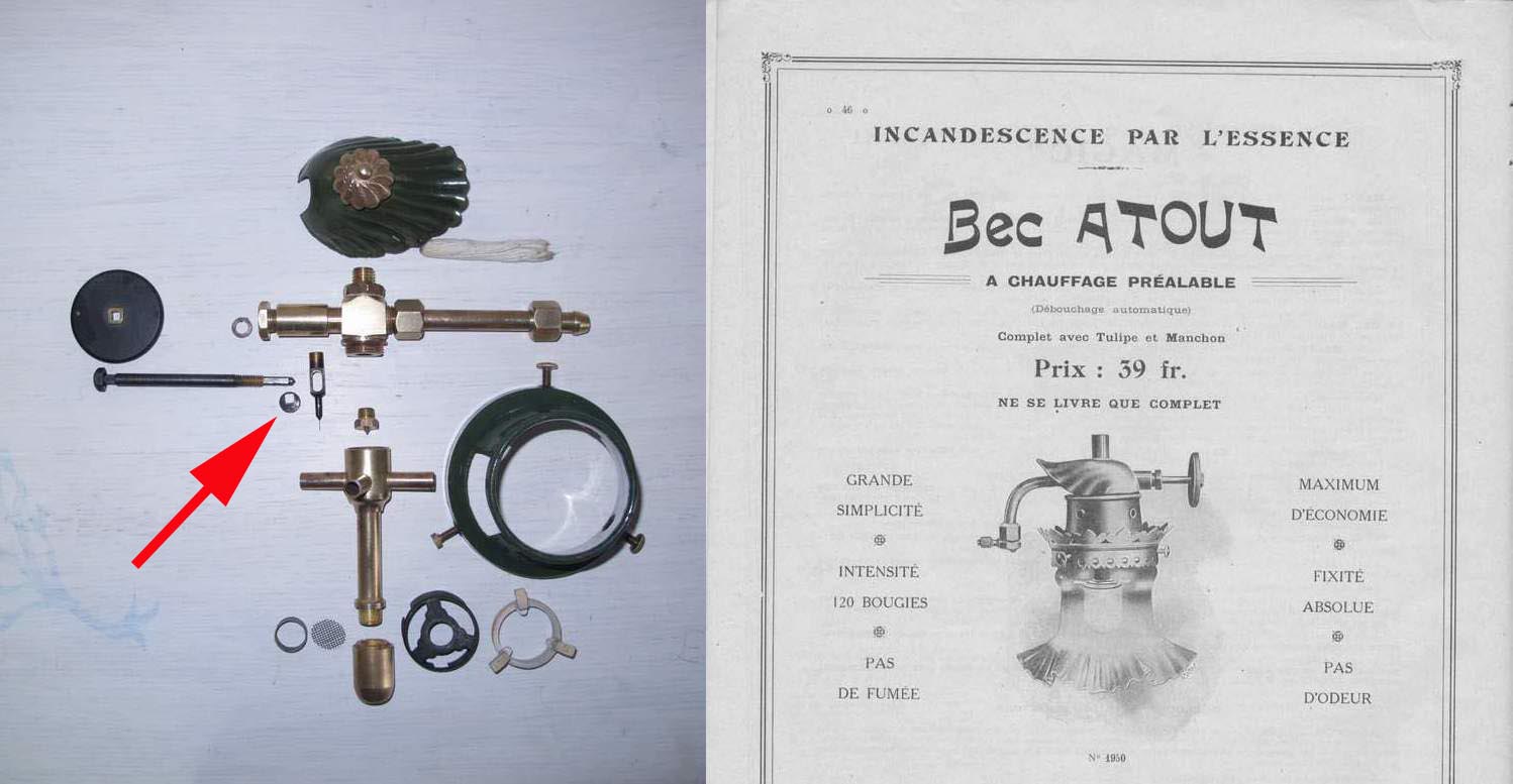

    A little update for this lamp.
    I was waiting since a while for this Atout burner. This burner is the first mounting for this model in 1914/15.
    The burner was in average good shape, but was missing the small round excentric. It have been redone. His work is to operate the cleaning needle whilst turning the black knob. This knob also allows to adjust the power of the flame. A very simple and well running burner.
    Was also missing the brass galery. I have finally found on on a old city gas burner.
    Here is the Atout burner (Liotard Freres)
    And the lamp running with ;
    The left picture is as in the 1915 catalogue, but I appreciates the green tulip.
