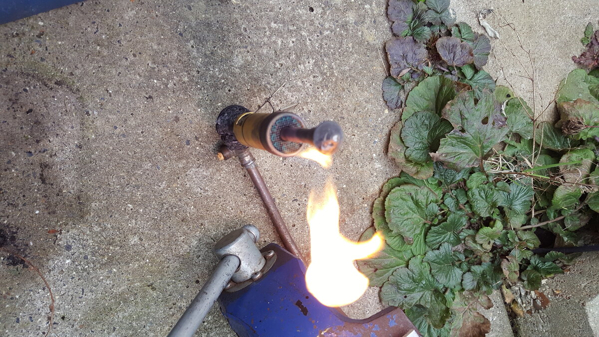

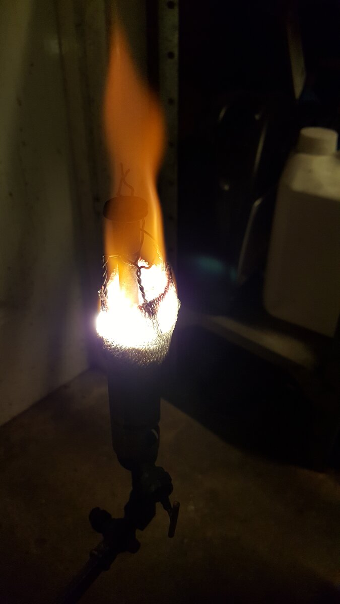

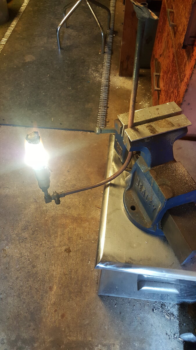

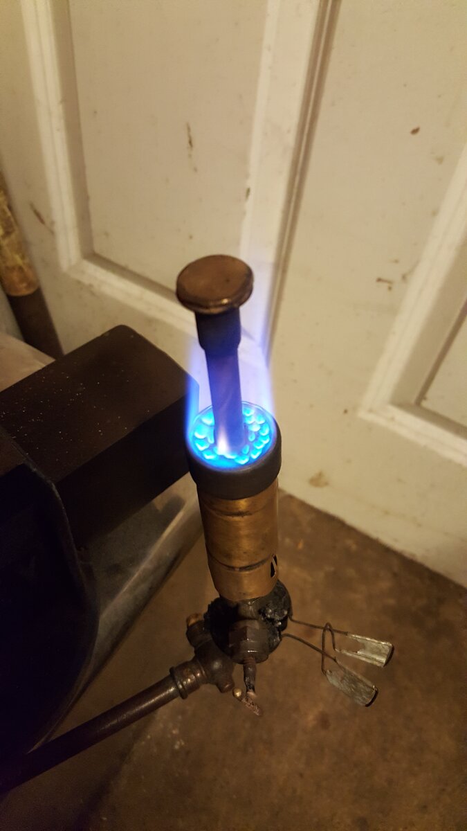

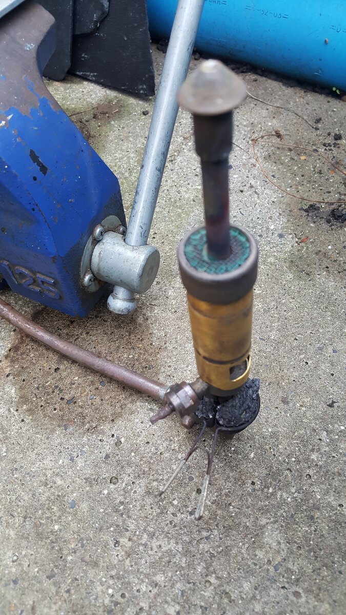

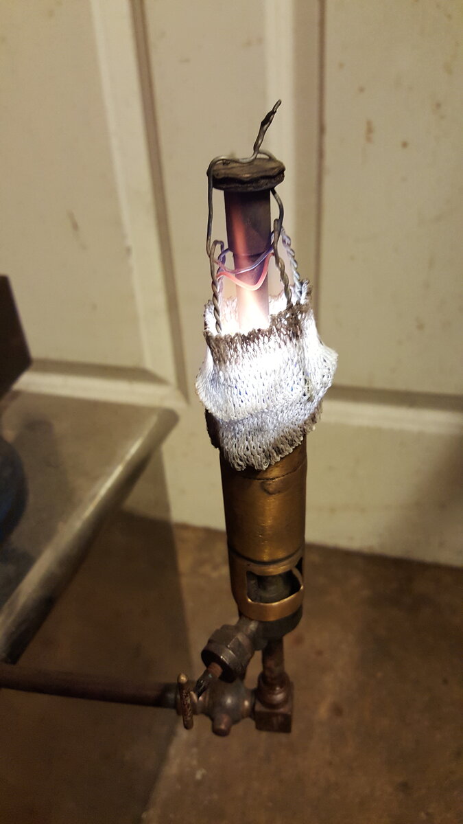

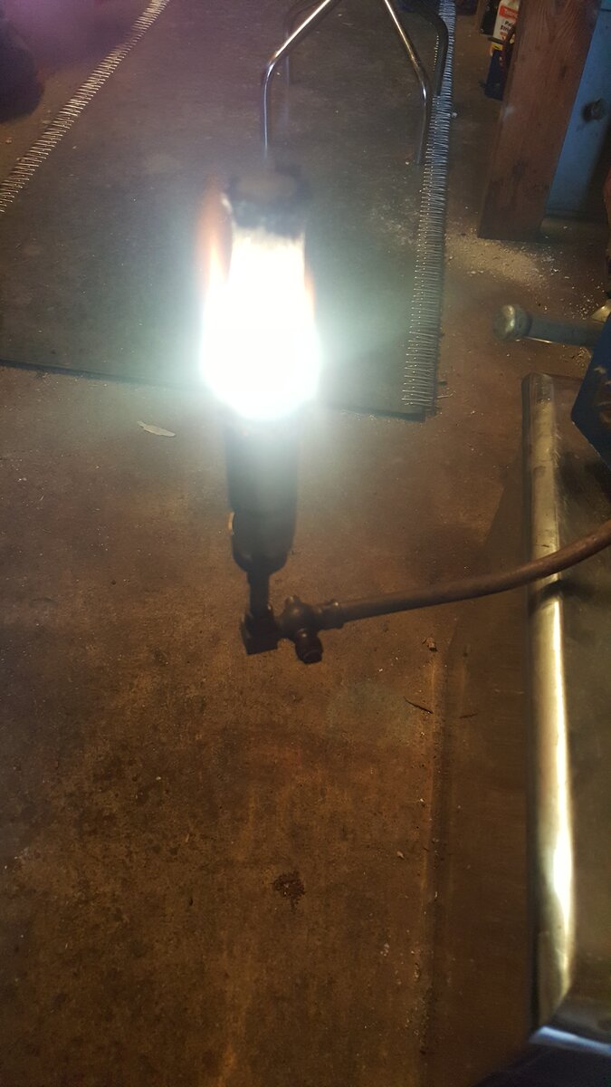

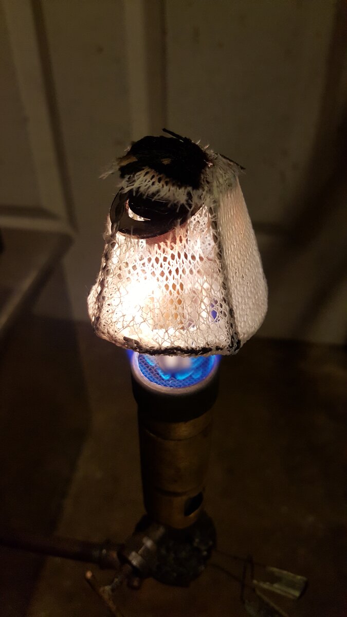

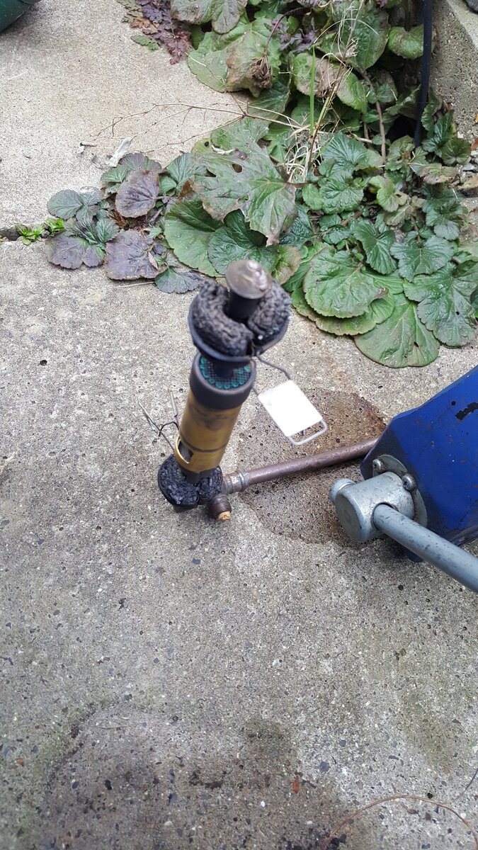

    Some pics of a gravity lamp burner I have been working on, still have a lot of fettling to do but we now have the first signs of life.
    Best guess for a date would be 1900 to 1905 ish.

  5. James K
    Nov 10, 2017
    656

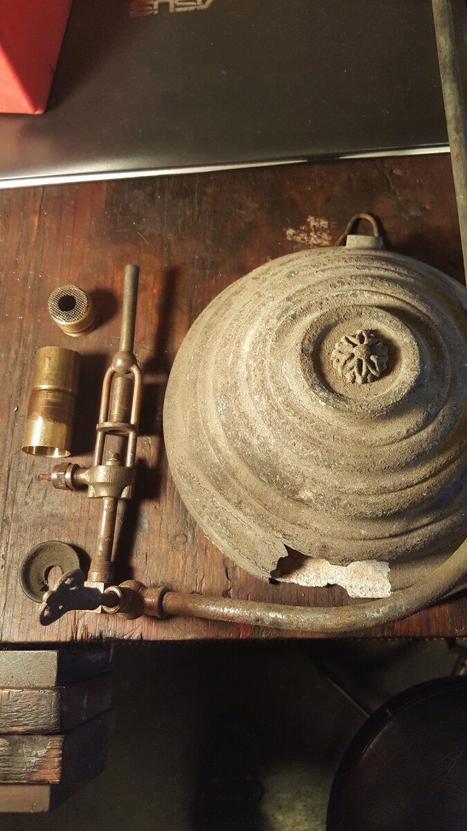

    @Conny C

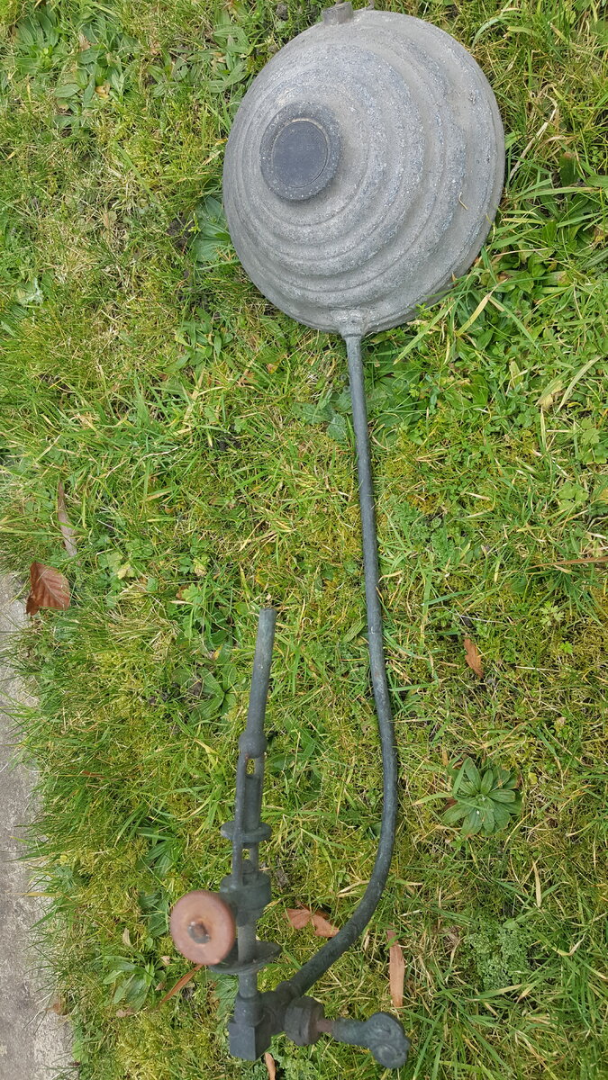

    Apart from the damaged tank this is pretty much the entire lamp.
    The rest of it does not exist yet, but I am working on it.

  7. Walkop Australia
    955
    At least it is alive and running so far.

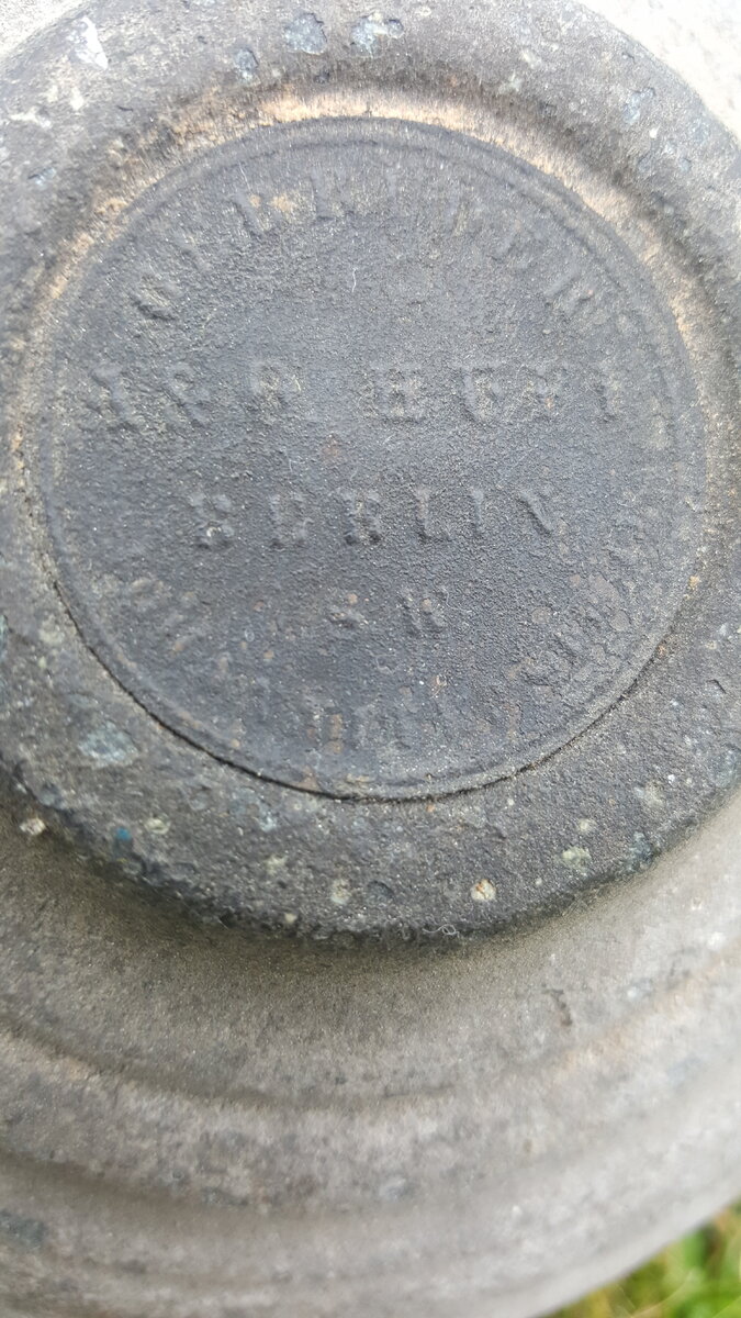

    This lamp came to me as a pair.
    The other one is identical apart from the tank has a nameplate, both were missing the entire burner assembly's.
    All I can make out on the nameplate is Berlin.

    These are not Louis Runge lamps, but manufactured by "Gebrüder A. & O. Huff, Berlin.
    Gasoline lamps and very much in the style of Runge. I think your lamps are model nr. 301 or 302.

  10. James K
    Nov 10, 2017
    656
    @Conny C
    Thank you for the images from the catalogue, now I know what it should look like I can look for parts accordingly.
    These lamps were described as runge when I purchased them, this turned out to be a good thing. The runge patent drawing in one of your posts enabled me with the help of an old gas lamp burner and a centredraft oil lamp to get it running, an important milestone on the road to it's former glory.
    I can't tell which burner type or model number I have either.
    I suspect each burner type has the same generator underneath with maybee a different size jet.
    I can see no difference in the two generators that I have but perhaps the centre of the tanks with one having a nameplate and the other having an embossed decoration may represent one being a 301 and the other being a 302.
    Thanks again for the information, a great help.
