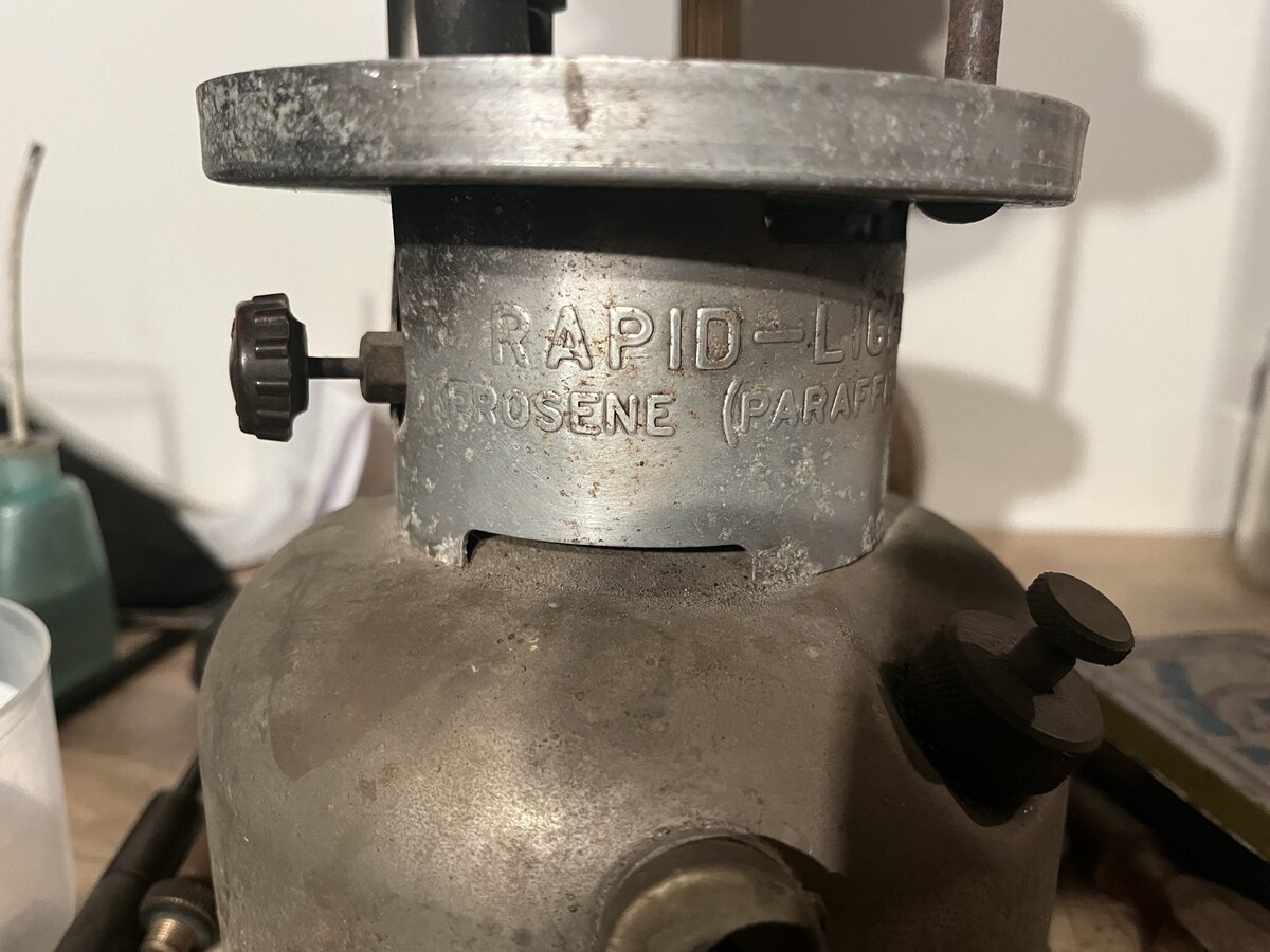

  8. Dashwood United States
    Aug 1, 2023
    275
    United States
    I've successfully transplanted the washer into the proper cup, assembled and tightened everything, I'm waiting for the lye to clean the globe of all the baked on crud. I did have fun igniting the rapid torch! I have to buff out the vent back to its lustre.

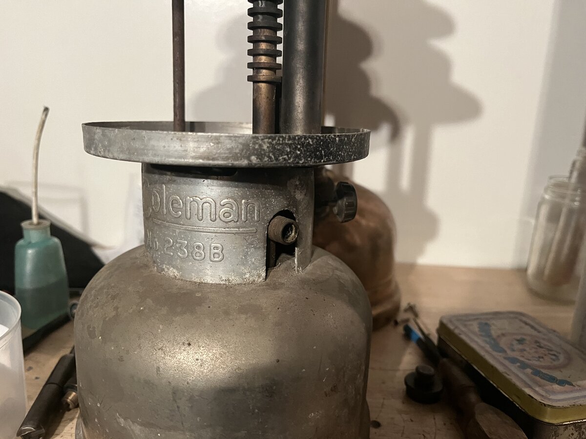

  9. Tony Press
    11,026
    Returning to some earlier conversation in this thread, the Coleman 238B that I have in the shed is made in Canada, dated December 1951, and has English only pressed on its collar.
  10. Dashwood United States
    Aug 1, 2023
    275
    United States
    Mine too features the stamped collar in English. Made in Jan of '51
    Is yours in working order? I would love to gander.

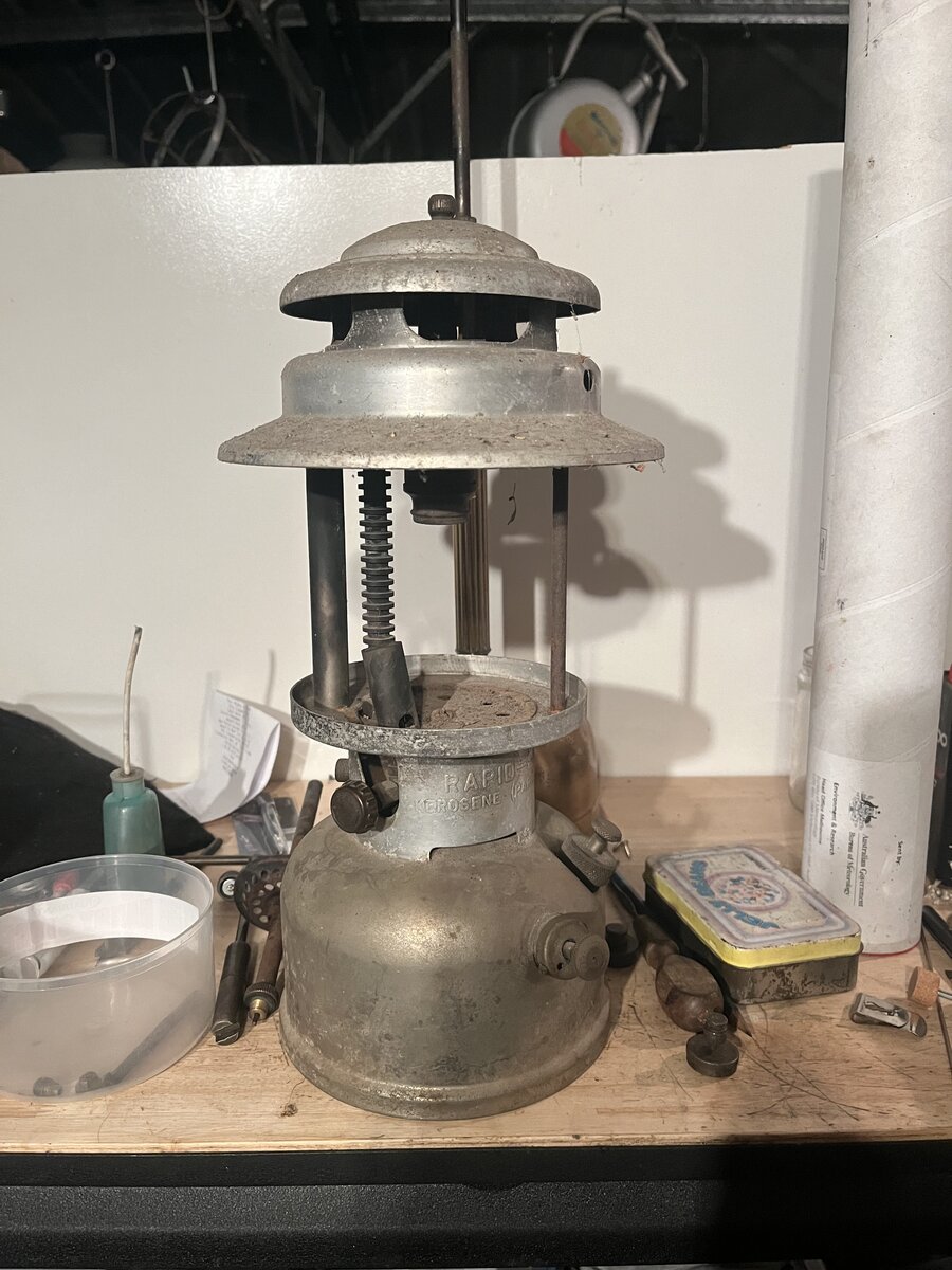

  11. Tony Press
    11,026
    Not in working order… missing the control valve; which I will have to rig.
    I am in the shed tidying up so that I can find the surface of the fettling bench.
    I’ll take some pics and post them in about 30 minutes.

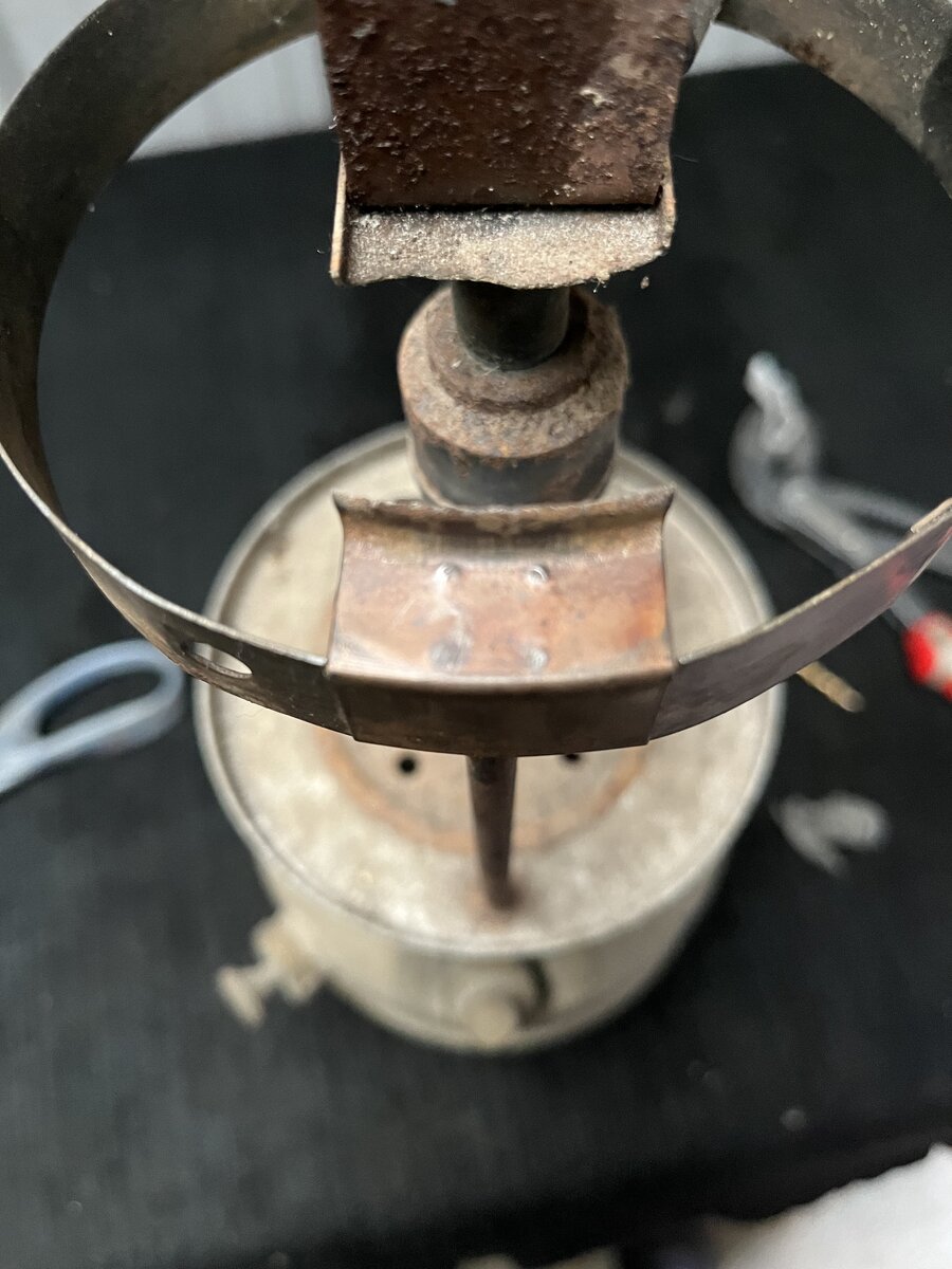

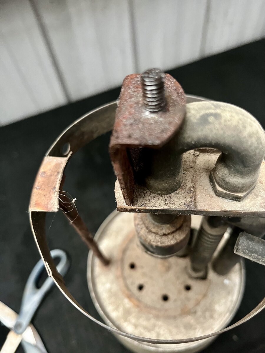

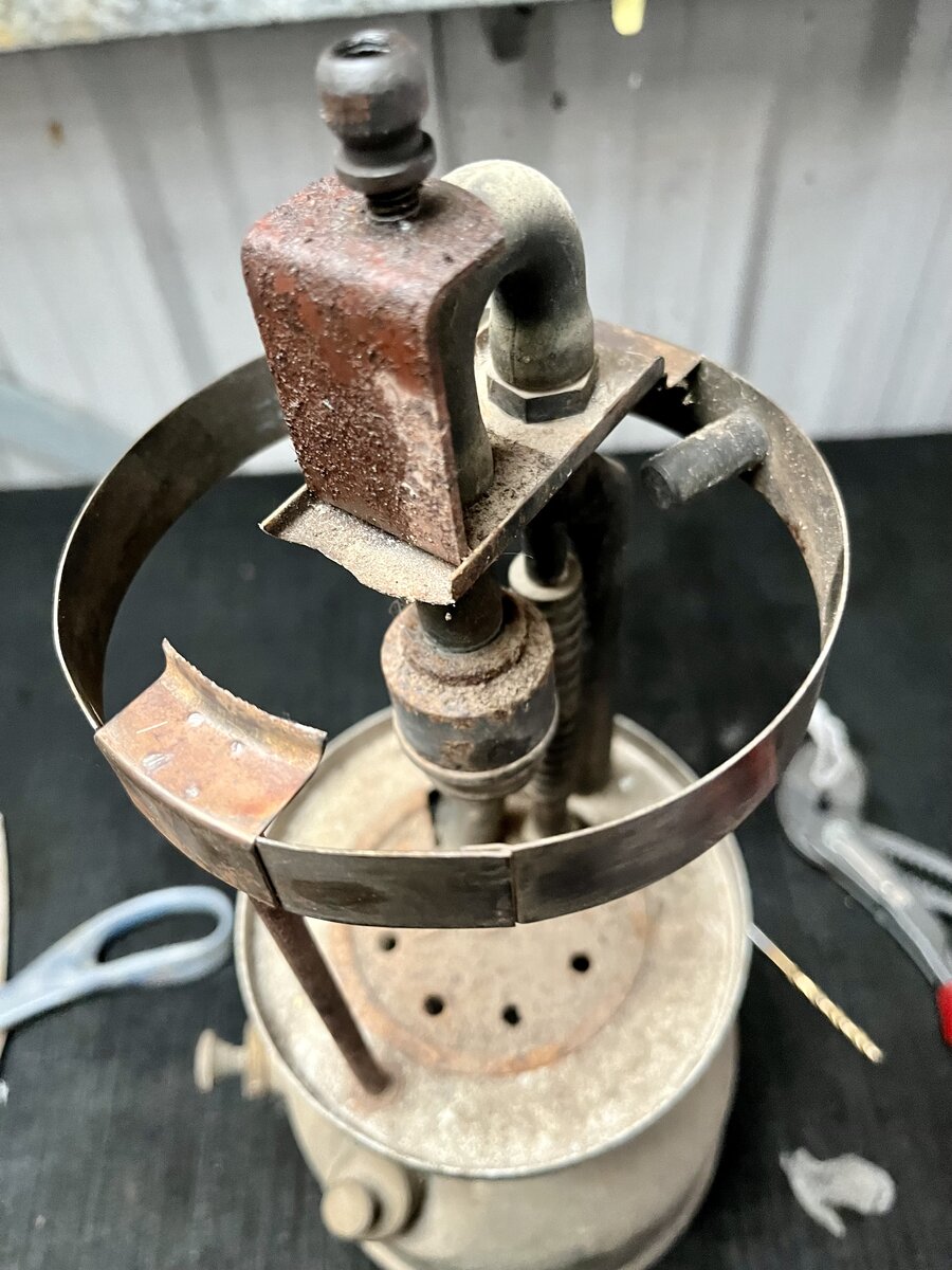

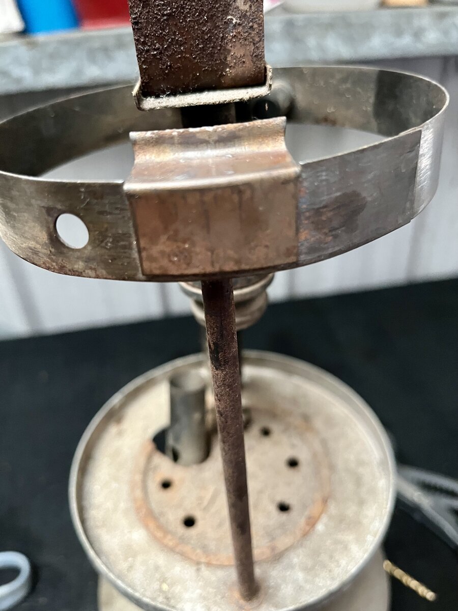

  12. Tony Press
    11,026
    A bit late, but…
    It will will need a bit of work to get going.
    @Dashwood

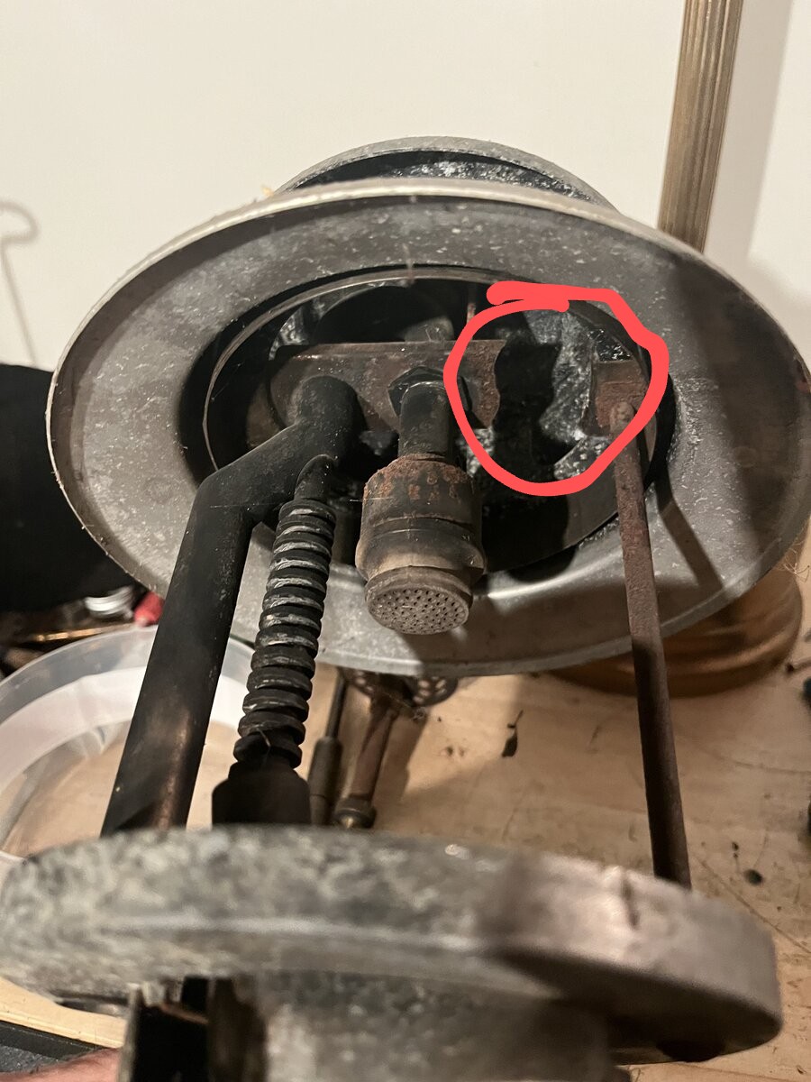

  13. Dashwood United States
    Aug 1, 2023
    275
    United States
    It seems portions of the top supporting the burner has broken away, I think that section is aluminum and I know aluminum is pure pain to weld if you plan on bridging that broken section together.
    Lots of work indeed. I was negotiating someone over seas sometimes ago in purchasing a 238B which had similar damages and I was willing to pay a premium to have it professionally welded. A lantern like that was hard to pass up but difficulty and trusting a wire transfer to a high conflict country put me off.
    @Tony Press

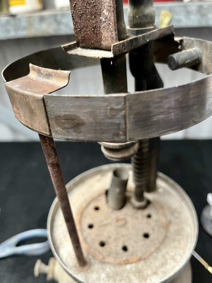

  14. MYN
    I did not check on my 238B but if I'm seeing correctly, the broken bridge piece on your lantern looks like it is made of steel.
  15. Tony Press
    11,026
    @Dashwood
    The broken part is too hard and brittle to be aluminium. It’s not magnetic, but I think it’s stainless steel, not brass. The metal to metal joins have been spot welded.
