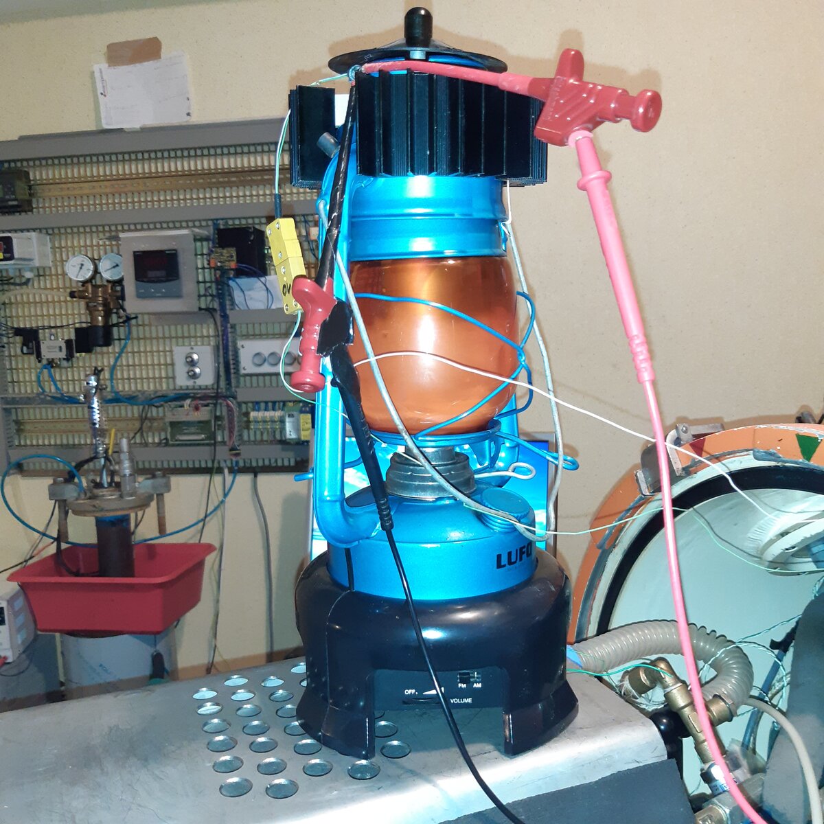

    Hallo zusammen, Kiki und Karli haben sich bei einem Dochtlampentreffen eine interessante Frage einfallen lassen; Wie warm oder heiß wird ein Lufo-Radio am Spannungsgenerator und welche Spannung liefert es? Oliver S. stellte ein Radio zur Verfügung, damit es schnell gemessen werden konnte. Hier das Ergebnis: Die maximale Temperatur beträgt 225 °C / 316 °C, je nach Dochthöhe beträgt die erzeugte Spannung 2,81 V / 4,25 V.

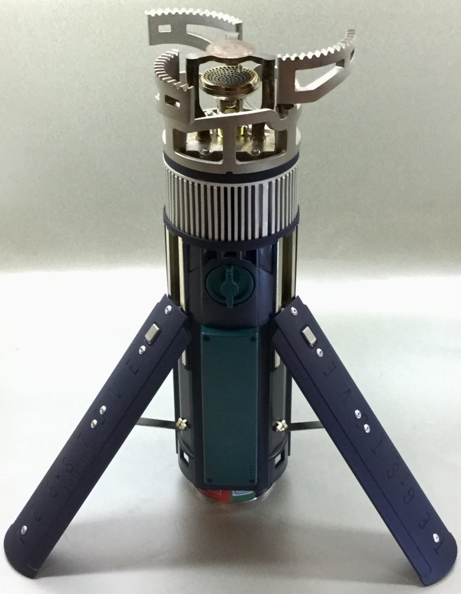

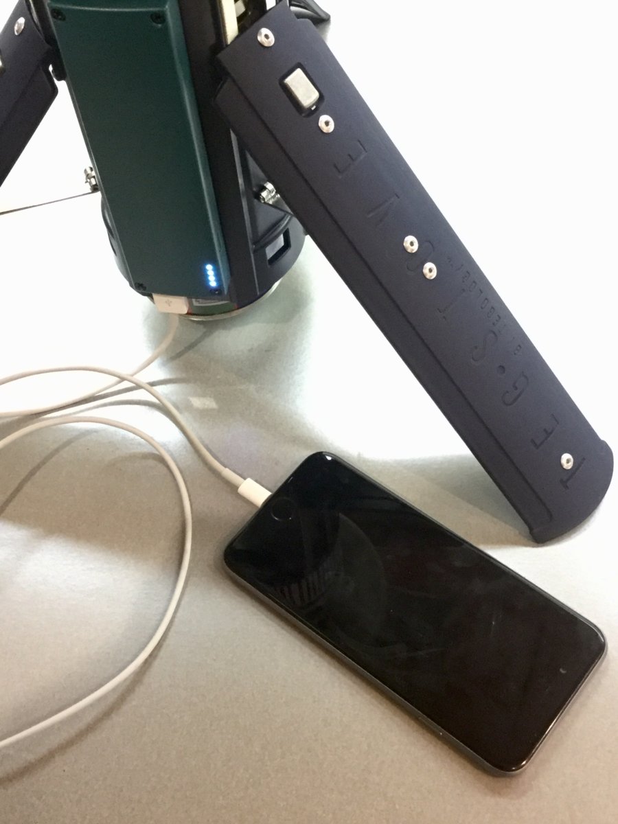

    Or plug into the USB output of a Tegstove

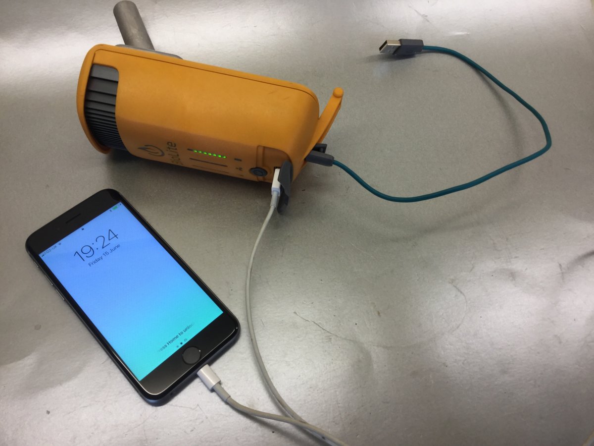

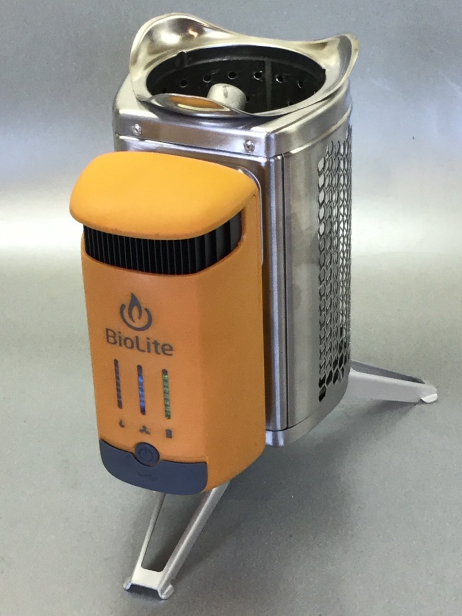

    … or Biolite, while cooking or boiling water.

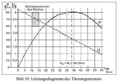

    It might be interesting to put a 100 Ohm resistor on it and see what Voltage it gives then. 30-40mA would be expected if it was a perfect Voltage source which it won't be.
    If it drops to say 1.5-2V then the generators own internal resistance is about 100 Ohms too.

    Thanks to @Olaf - DL8OBH / AF0A for the printed tests on the Lufo. So armed myself with a selection of resistors, multimeters, transistor radio and the Lufo.
    The little Sony AM/FM set (in my earlier photo) which is a old school analogue radio works well with the Lufo. Tuned to a clear strong FM station and set to a comfortable listening level draws about 10 to 11mA depending on voice peaks. No distortion.
    The terminal voltage of the Lufo drops to 2.8 to 3.0 volts depending on voice peaks. Unloaded the Lufo gives 3.5 volts.
    Ambient air temperature 20C.
    Experimented with various resistor loads.
    56 ohm = 32mA = terminal V 1.6 volts
    100 ohm = 22 mA = terminal V 2.3 volts
    150 ohm = 17 mA = terminal V 2.6 volts
    220 ohm = 12 mA = terminal V 2.8 volts
    These readings are consistent with the German tests already mentioned which indicate the Lufo is comfortable with supplying 50mW or 10 to 15mA.
    Quite capable of supplying a analogue type transistor radio at moderate volume levels without any bother.
