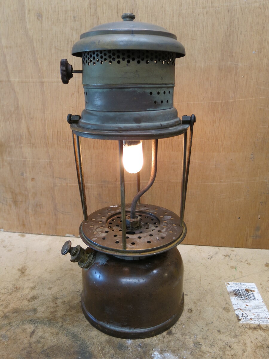

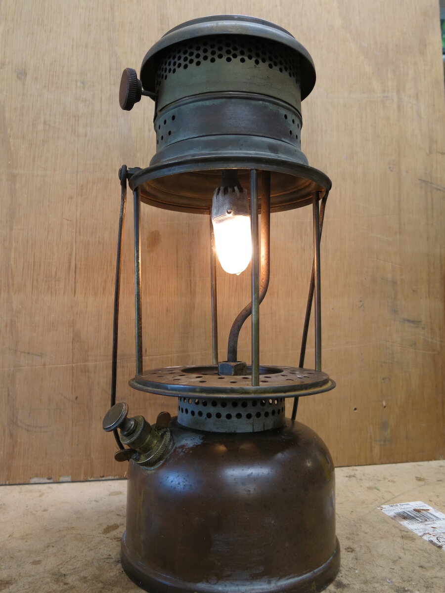

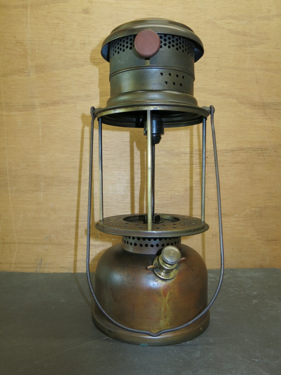

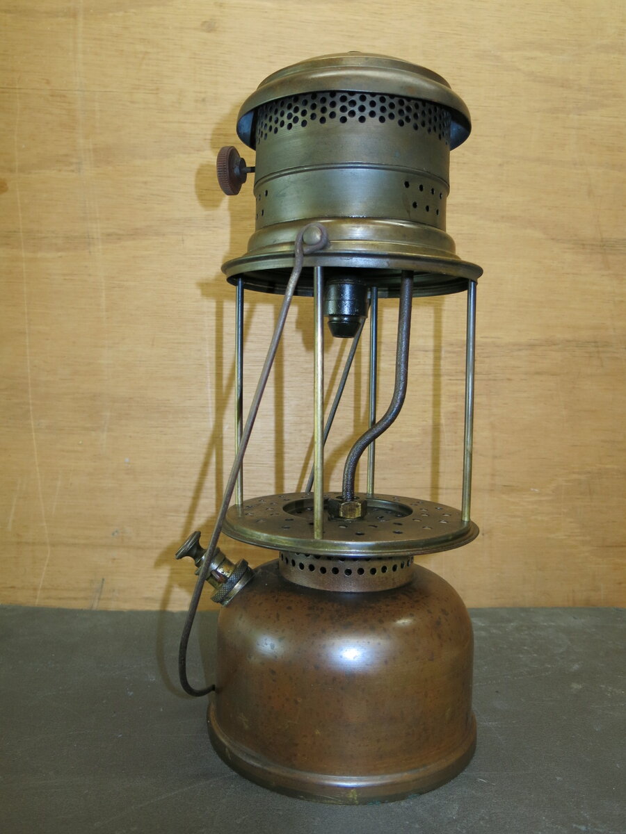

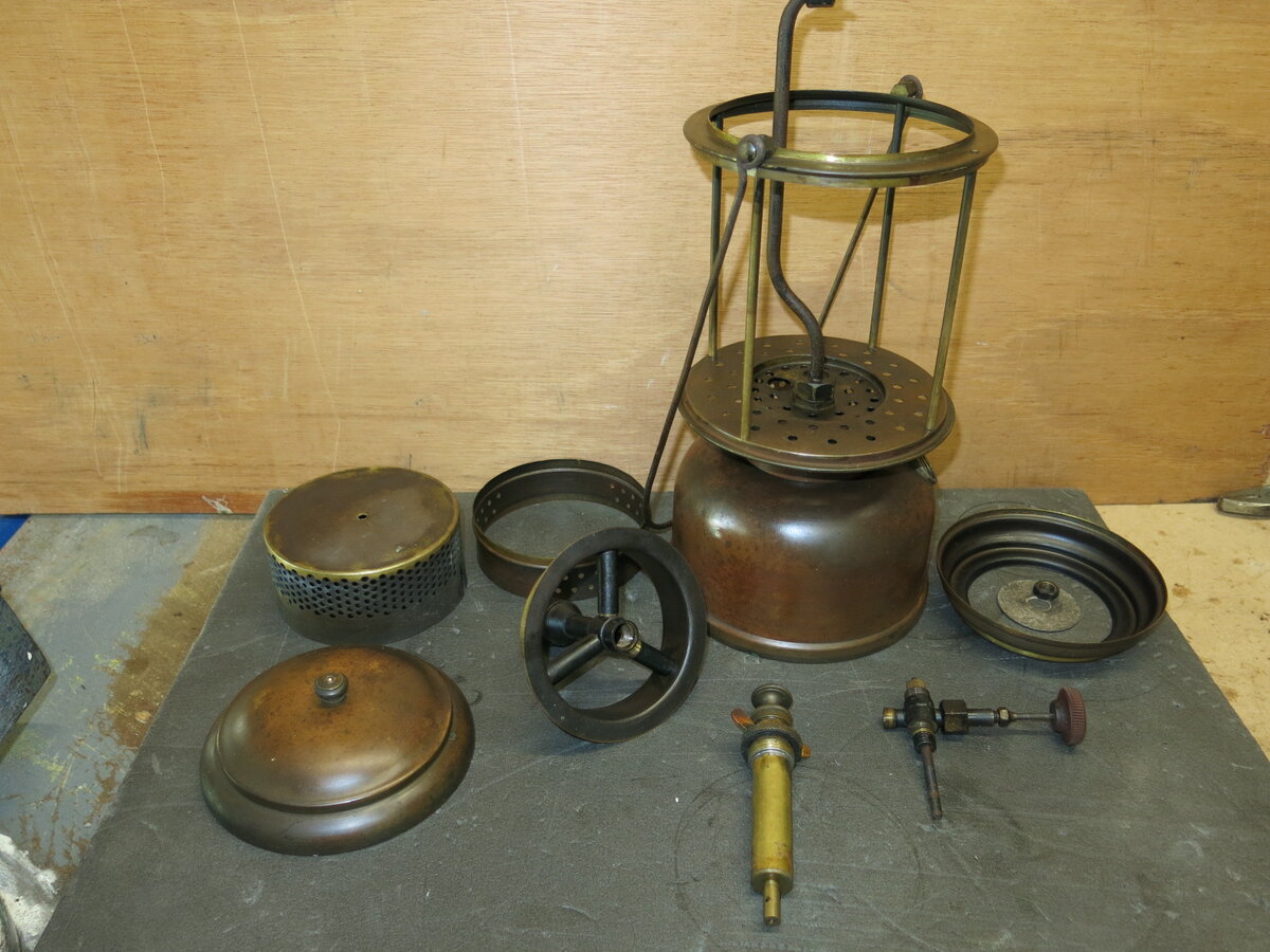

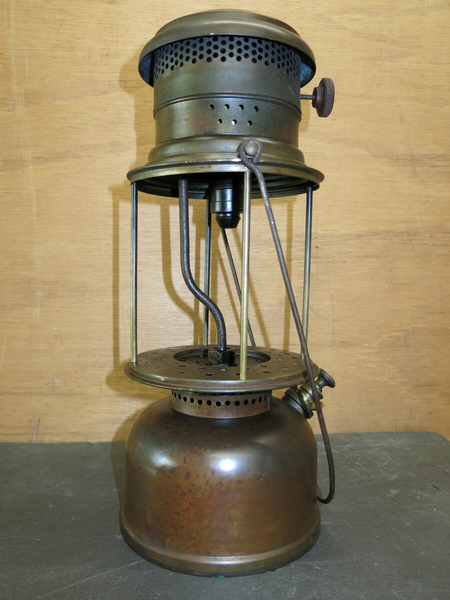

    A lamp i know nothing about so any input would be welcome had it in the shed to fettle for a friend,
    the lamp is well made i thought never had a french lamp to bits before but surprised its very well engineered least that was my impression.

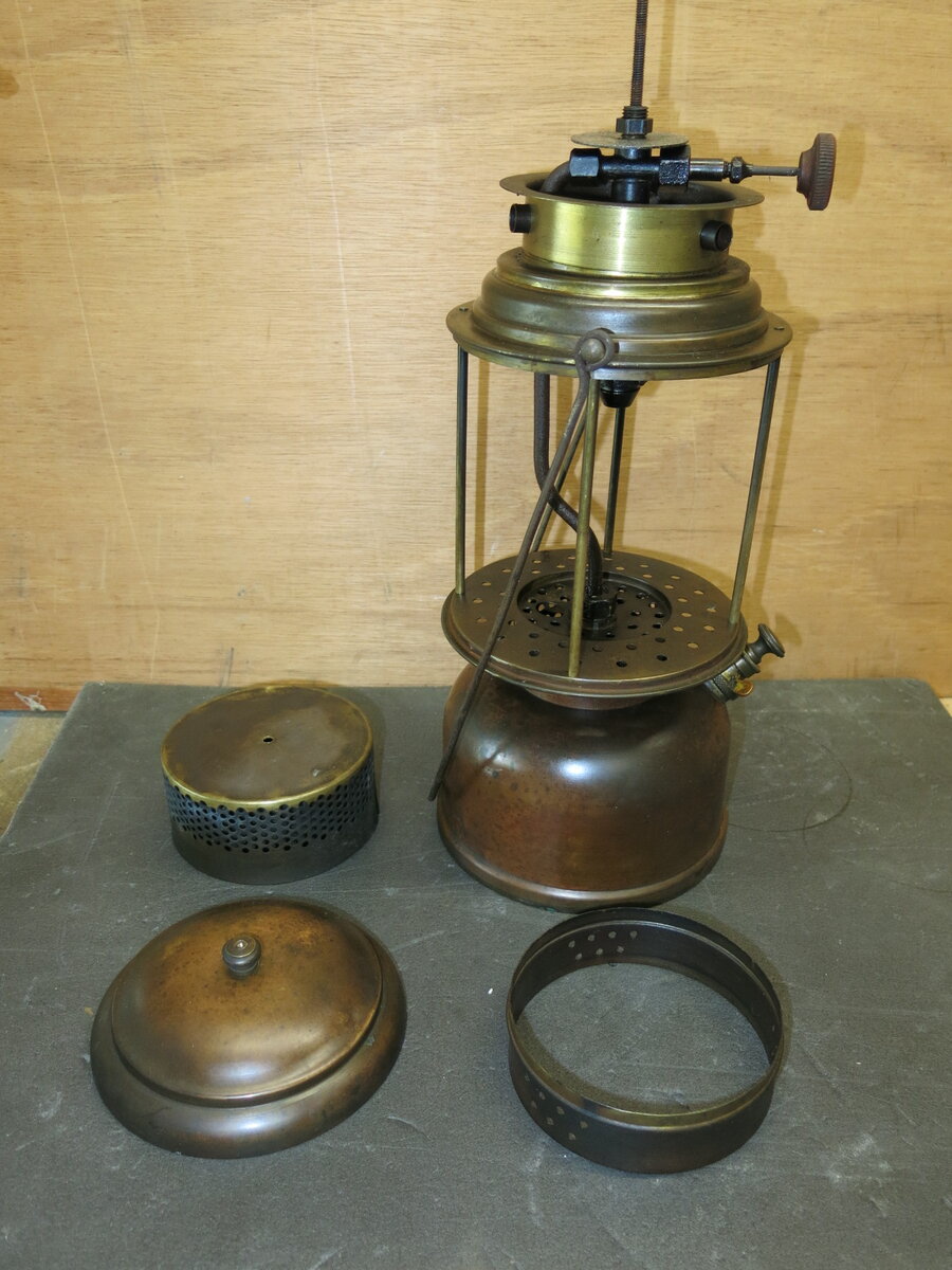

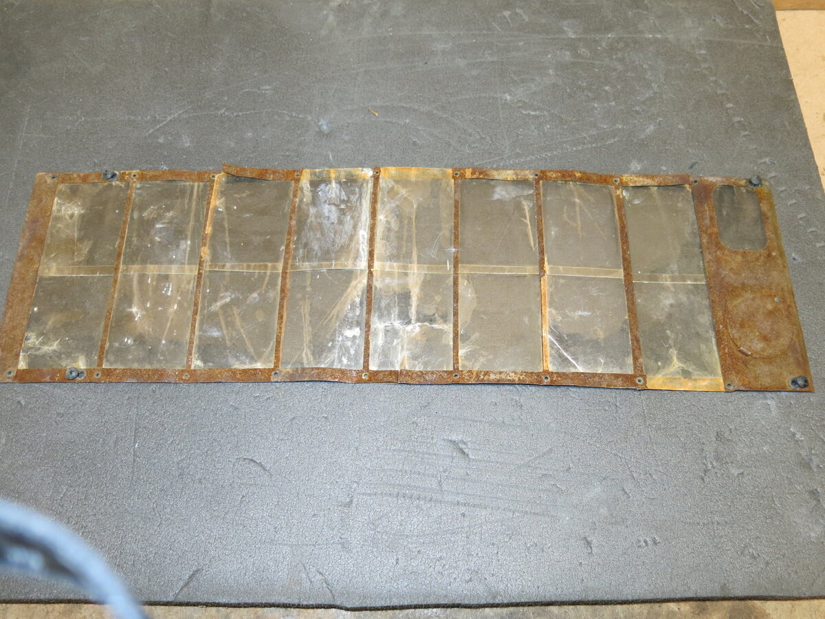

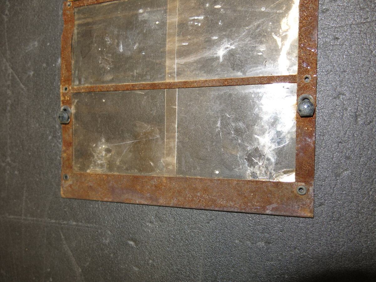

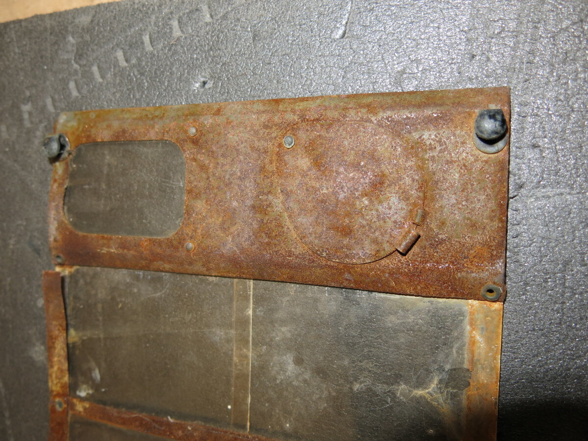

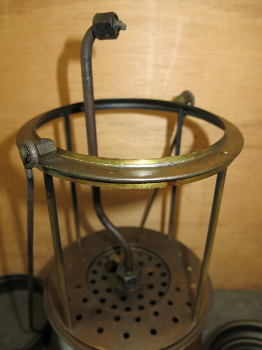

    The mica globe is unusual in that it wraps round the cage instead of inside as most do.

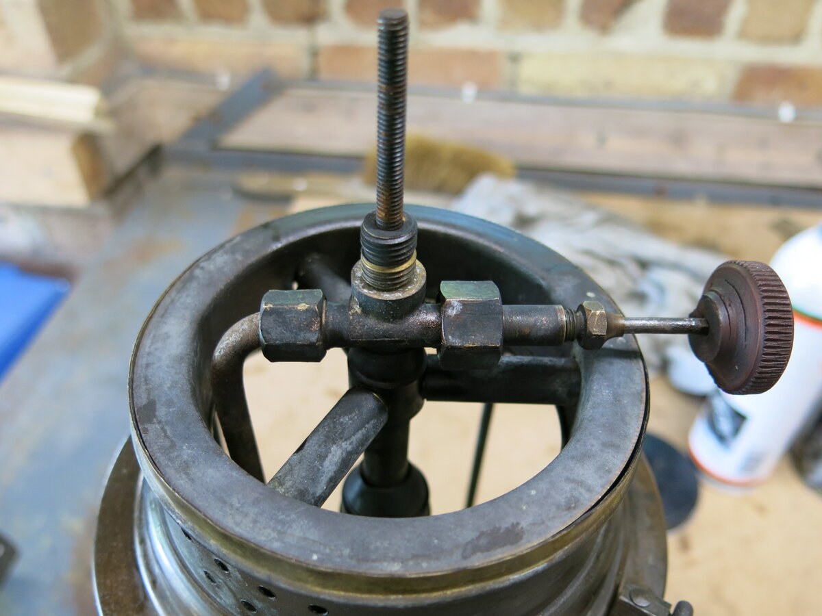

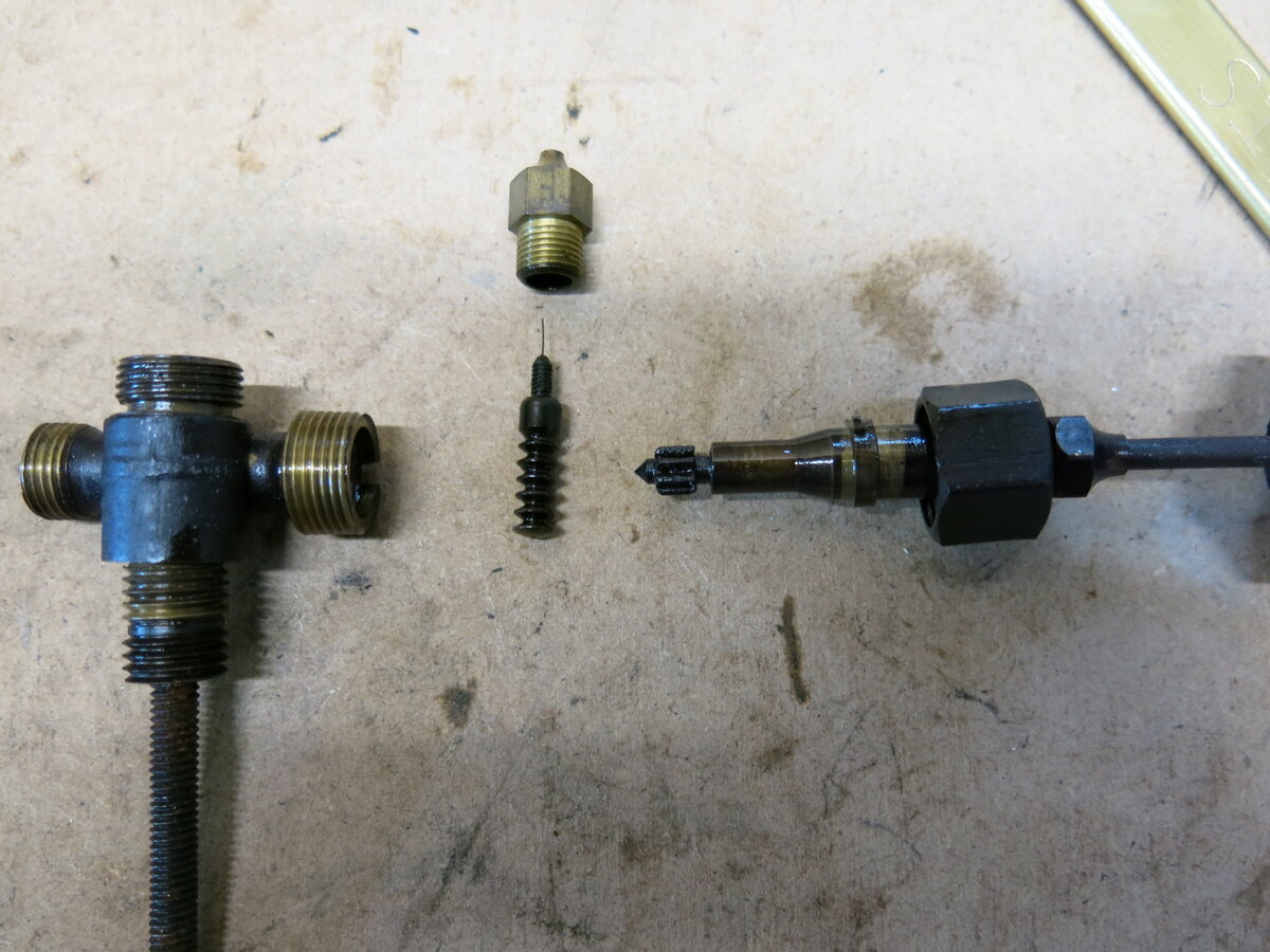

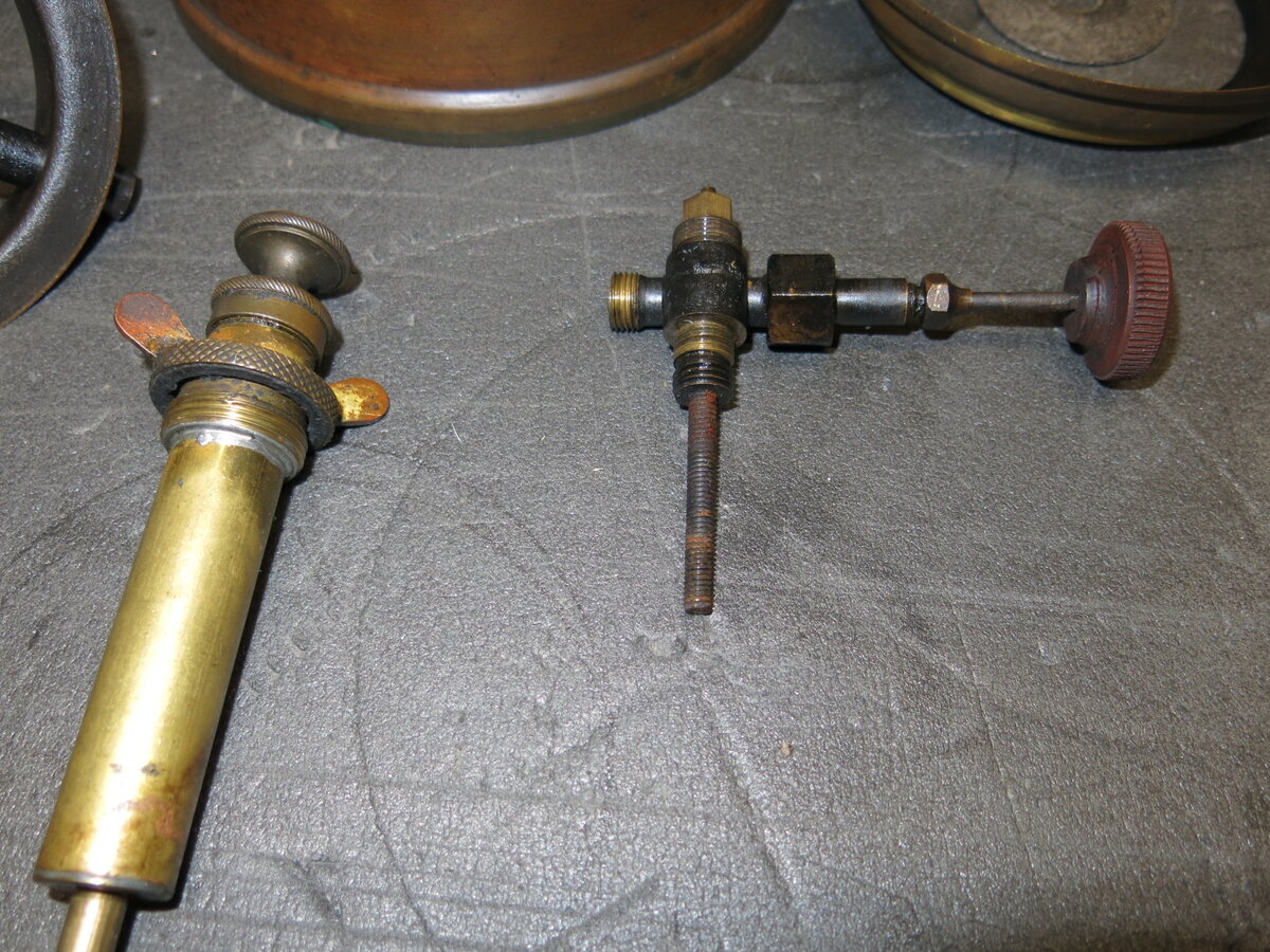

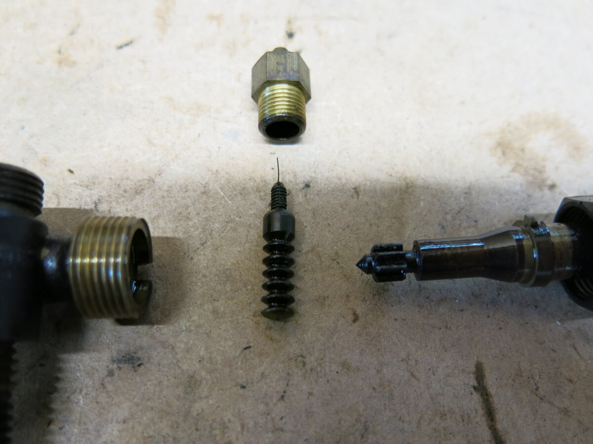

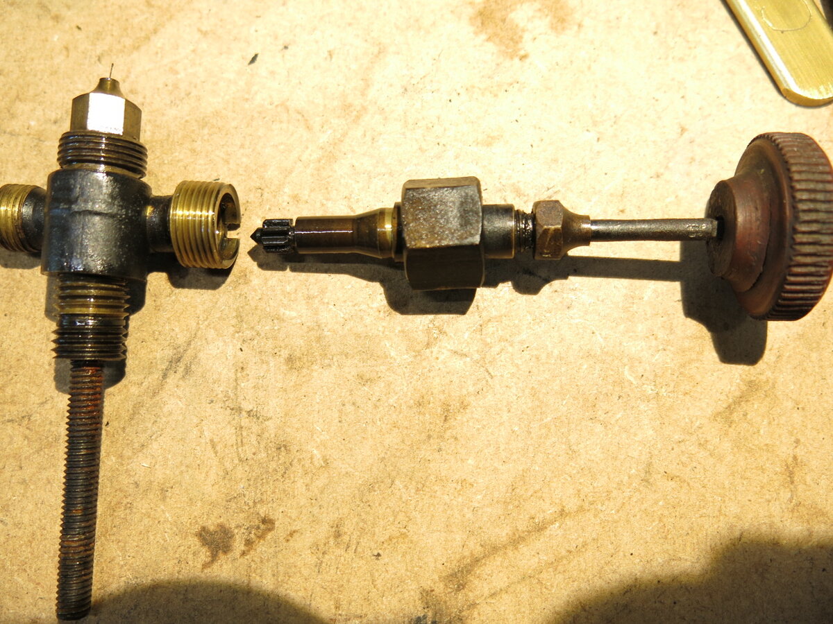

    The lamp turns the fuel off and pricks the jet by means of a little cog which places the pricker at the same time clever stuff.
    The lamp does run ok but i feel it could do better maybe a bigger mantle or cleaning the generator packing,
    Right lots of pictures anybody know anything about them maybe a date ?
    cheers pete

    A grand old lantern and it may work better with a more bulbous mantle fitted.

    Yes Tony maybe Neil will have some input when he sees the post
    Yes Jeff a bigger mantle nearer the generator may well help and a mica so it don't lose heat so easily

    No I don’t list this lantern and it’s not one I’ve seen before. I only have one catalogue for Lumière Noël dated 1921 and there are no lanterns shown. However the burner and pricker arrangement is very like that in their Bec Noël and the marking on the control is identical to the twin mantle lamp I do list. This catalogue is for “Incandescence par L’essence” so maybe the lanterns are kero so just not listed or maybe they were not selling a lantern before the mid 1920s. Michel will know more than I do about the company or possible successors. ::Neil::

    Thanks for the input Neil I just presumed it was a petrol lamp like the lilors it runs better on parrafin and the bigger mantle quite a decent light now only thing I don't like with this lamp is the control wheel so close to the top vent it is seriously hot there when you shut it down. I put a glove on now like !!

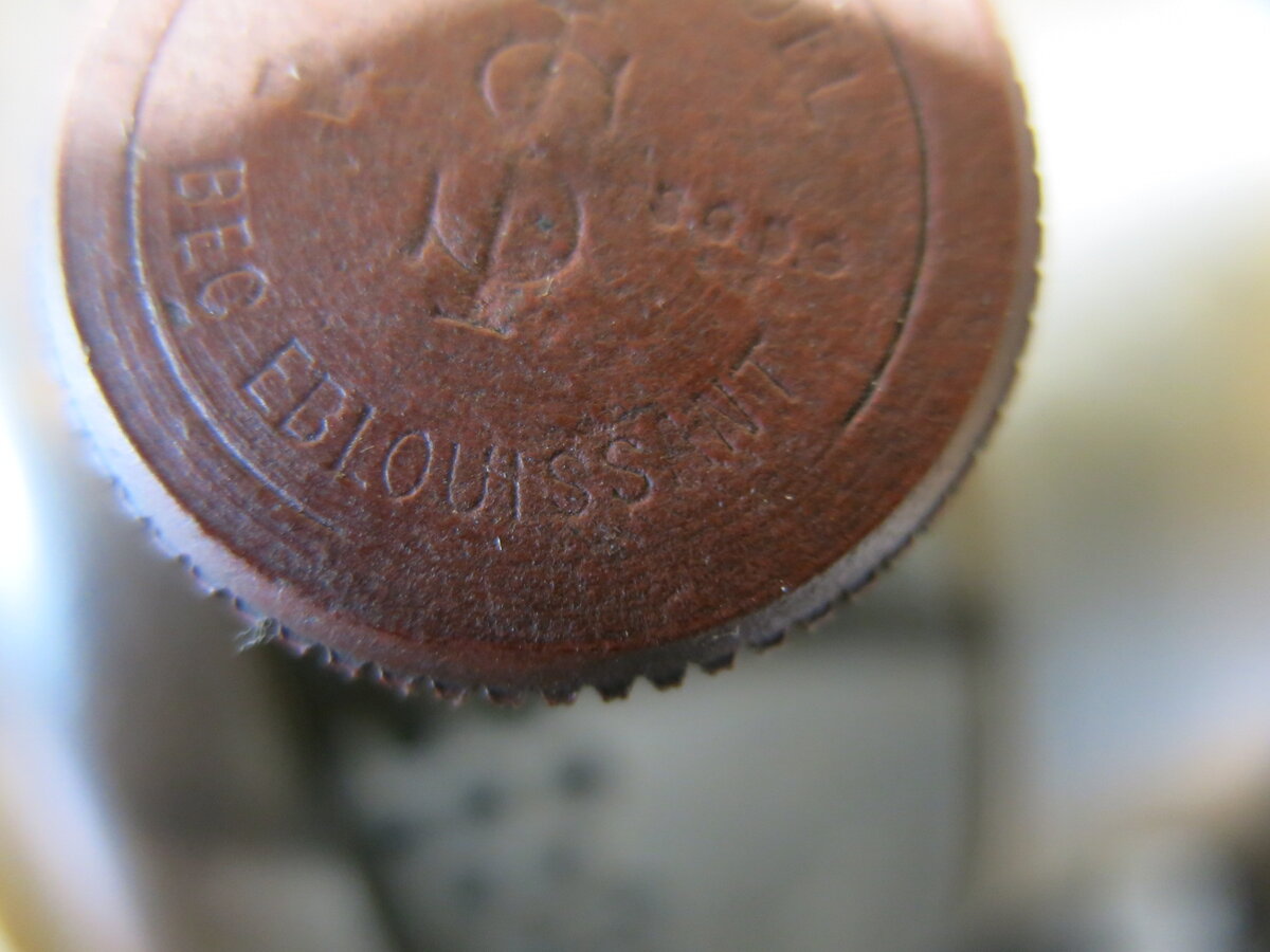

    Hi all
    I am not at home but as far as I know this Éblouissant burner is made to run with gasoline
    the society is the Société Industrielle (SI)
    I don.t know of this lantern but i will have a look next week

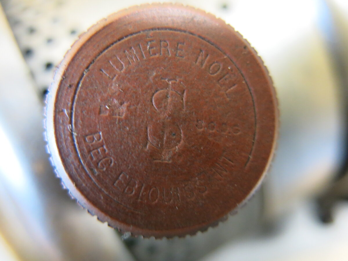

    hello, no trace of this lamp on the catalogs I have
    But this needle cleaning system have been patented by Ernest Noël en 1908
    This "Eblouissant" burner can be seen only on the first production of the SIAE
    (Societé Industrielle d'Articles d'Eclairage)
    the SIAE have been the result of the association of many small independent producers in 1900.
    We can estimate the production of this burner, just before the war, but before december 1923 which is the date of the patent for the "new" burner called "Bec Noël"
    Bec = burner

    Thankyou Michel that's very interesting that burner patented 1908 good bit of engineering design

    the trade mark of your lamp belongs to this French company:
    Unfortunately I have this letter head and a picture of a hurricane laterne which was once produced by this company in my archive.

  16. JEFF JOHNSON
    16,923
    That larger mantle does the trick.:thumbup:

    What a great looking lantern. Some really interesting engineering compared to the more typical valve and needle mechanisms.

    Yes it is a clever setup with the little cog and pricker mecho. Interestly this was patented in 1908 and a year later blanchard patented his burner with the cog and rack operating the pricker makes me wonder if he poached this idea from this ?
    Nothing to prove anything like just my rambling thoughts Scott
