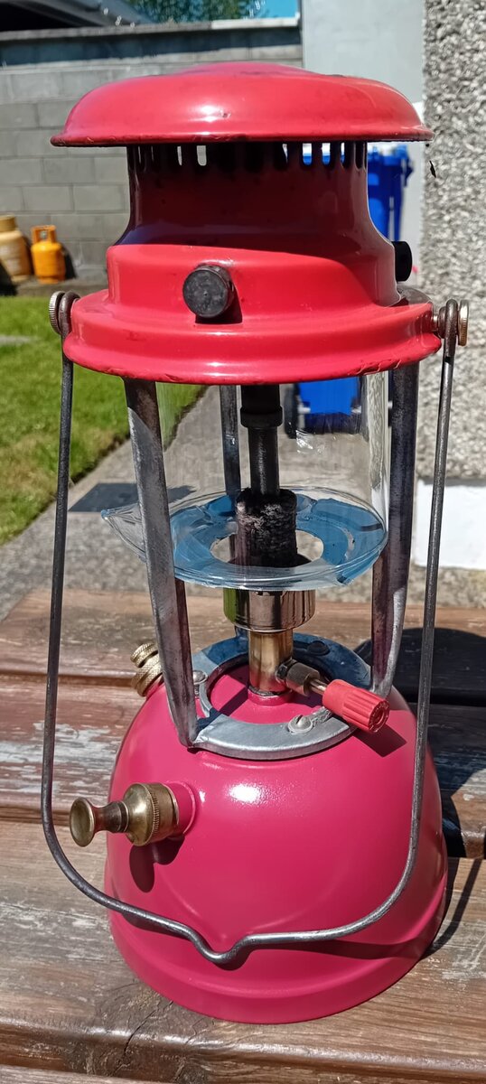

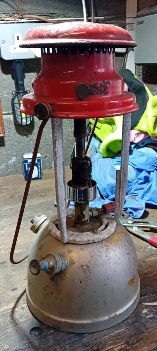

    Its been done a ton of times so I'll cut it down to the before and after shots....
    My apologies for the shocking pink, the label on the can lied.
    Nothing out of the ordinary except the coffee pot glass and the diy metal plate to hold the glass.

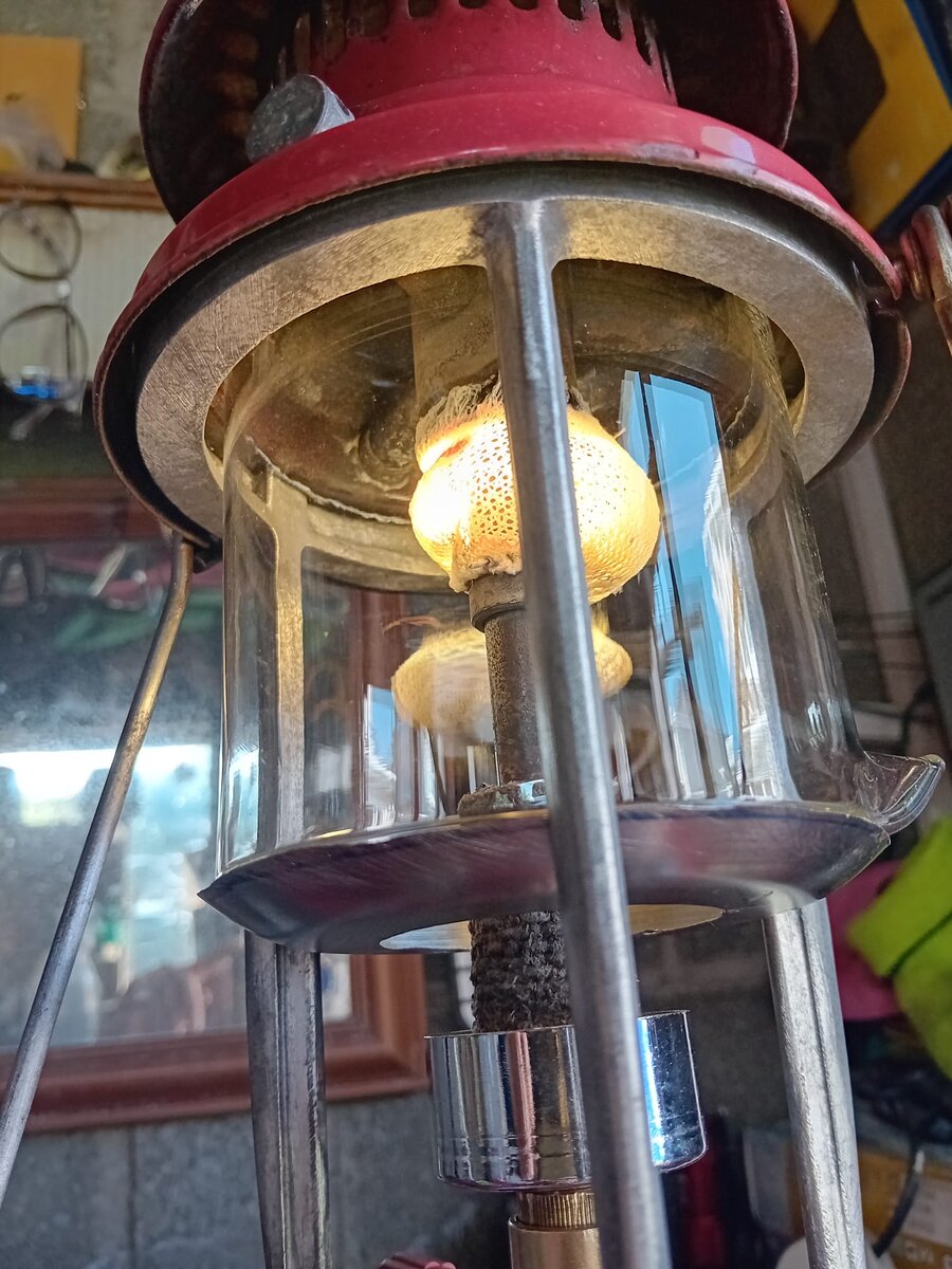

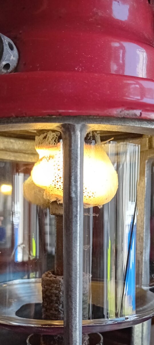

    I lit it up with brand new mantle and which was very satisfying, until I turned it around and saw this...
    This is not the first time this has happened to me.
    1) Is it me ?
    2) Is it the mantle ? or batch of mantles...
    3) Does the universe hate me ?
    Any one out there have this happen to them, and is it possible to avoid it happening again.

    Several years ago I obtained a bad batch of Vapalux mantles and there were various problems with them.
  3. Paul Burnell
    Paul Burnell Ireland Subscriber
    May 12, 2023
    172
    Ireland
    @JEFF JOHNSON
    Thanks Jeff, at least I now have an excuse for this dogs dinner of a mantle......
    16,746
    One of the problems with that batch of Vapalux mantles was that some of the top apertures were to small and the ones which did fit the burner developed holes when they were burned off.
    Perhaps I should have tried them on a Tilley burner as it is smaller, there are still a few of that batch of mantles left so I will try one on a Tilley burner.
